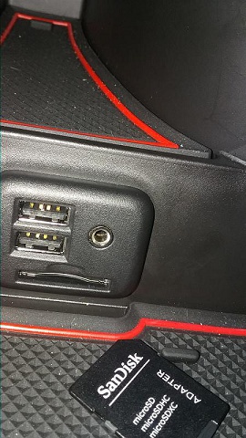

Unless GM updated the console for 2022, you'll get two USB A 2.0 slots.
I have upgraded my 2018 receptacle to the one that comes with the GM trucks so I can have an SD card reader (you may already receive something similar from the factory), but this is kind of what you can expect:
What is the part number of this updated one. I would like to have the SD card reader in my car as well.

Hey Archfx, the part number I purchased was 22990883 and it's guaranteed to work (even shows the proper SD icon in the media player app), you can ignore what online compatibility checkers say.
There is an updated part for 2019+ model year GM vehicles with 1x USB-A and 1x USB-C plus an SD card reader, its part number is 13529869, but I'm not sure if it works on the Camaro... perhaps you could be the guinea pig for the community on this one
Thanks for the information. Regarding the 13529869, the 6 pin connector does not align, USB type connector seems to be the same one. If the wiring diagrams are available I can double check this. If we can figure it out, type c would be very nice touch!
Yeah, it's a truck/SUV part that seems to have the same form factor.
It's so very GM to change the connector just for change's sake, but hopefully the signaling is compatible with the new (2019+) Camaro infotainment, as it's technically the same as the one in the trucks/SUVs listed in the compat chart.
