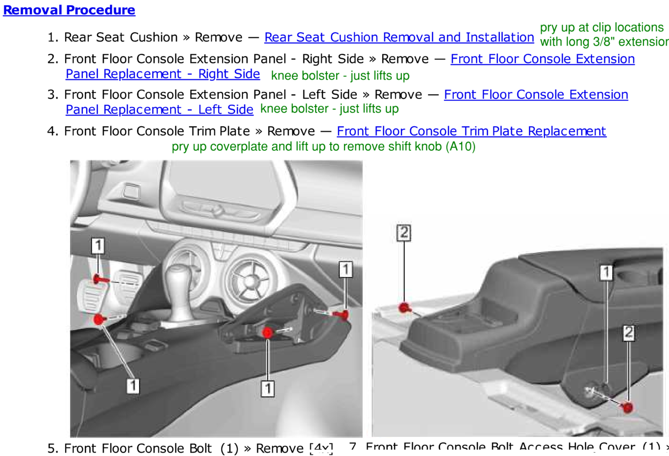

The violet wire is much easier to access under the center console, and it's a safer place to tap anyway.
To remove the center console you just remove six bolts and the shift knob. The seats can remain in-place (just move forward or backward to access bolts.
Under the center console you can tap the same Violet wire easily on either side of the console harness (vehicle side and console side).
