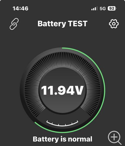

When I open HP Tuners, it tells me the battery is low, even though my PC is fully charged and my car engine is running.

The battery is normal.
