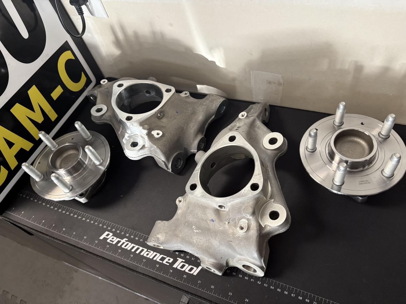

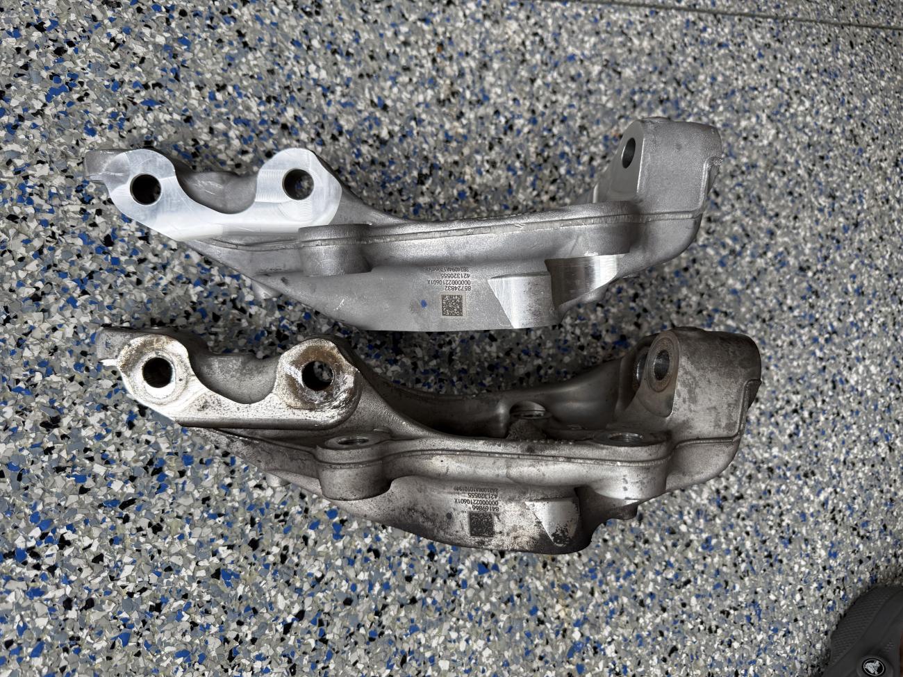

I made a video showing how to replace the OEM Camaro steering knuckle with the OEM Blackwing Precision Pack parts. This allows you to get as much as -3.1° of camber up front on the SS 1LE without having to go to an aftermarket solution like camber plates. The part numbers and torque specs and all that jazz are in the description. Previously I was only ever able to get -2.7° at the most if I was lucky. I tested this out at Road Atlanta before I headed out there and set the car up with -2.8°/-2.7° up front. Tire wear on my SC3R was phenomenal.

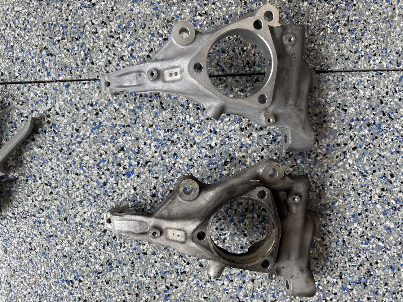

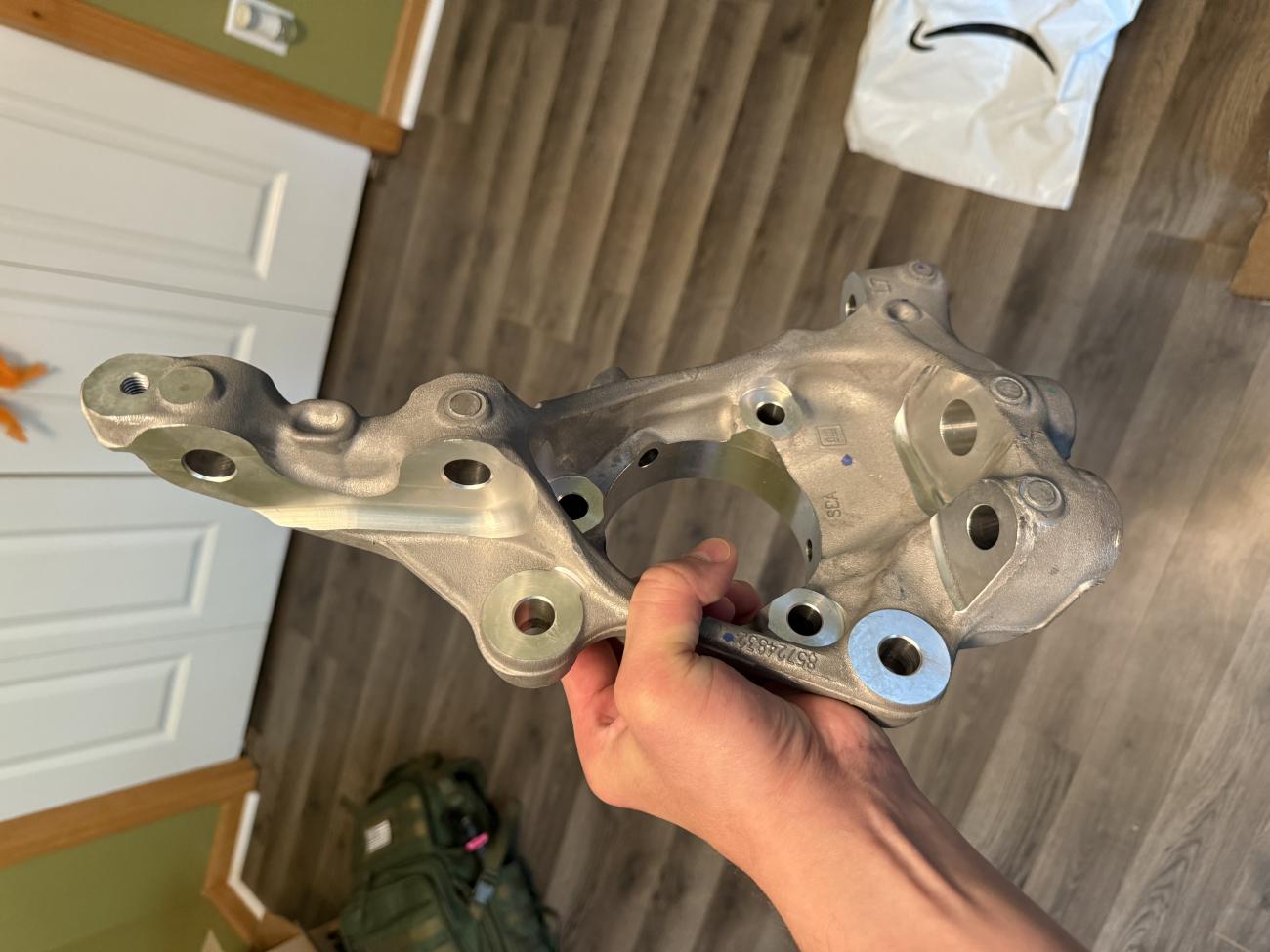

What exactly is different with these knuckles? Is the casting different or did they drill the holes in a different spot?
It looks like the upper hole is slightly repositioned, and they also made the neck of the knuckle a little thicker. The material up at the top looks like it was removed, too, so that the knuckle can kick in further at the top before it hits the shock body.

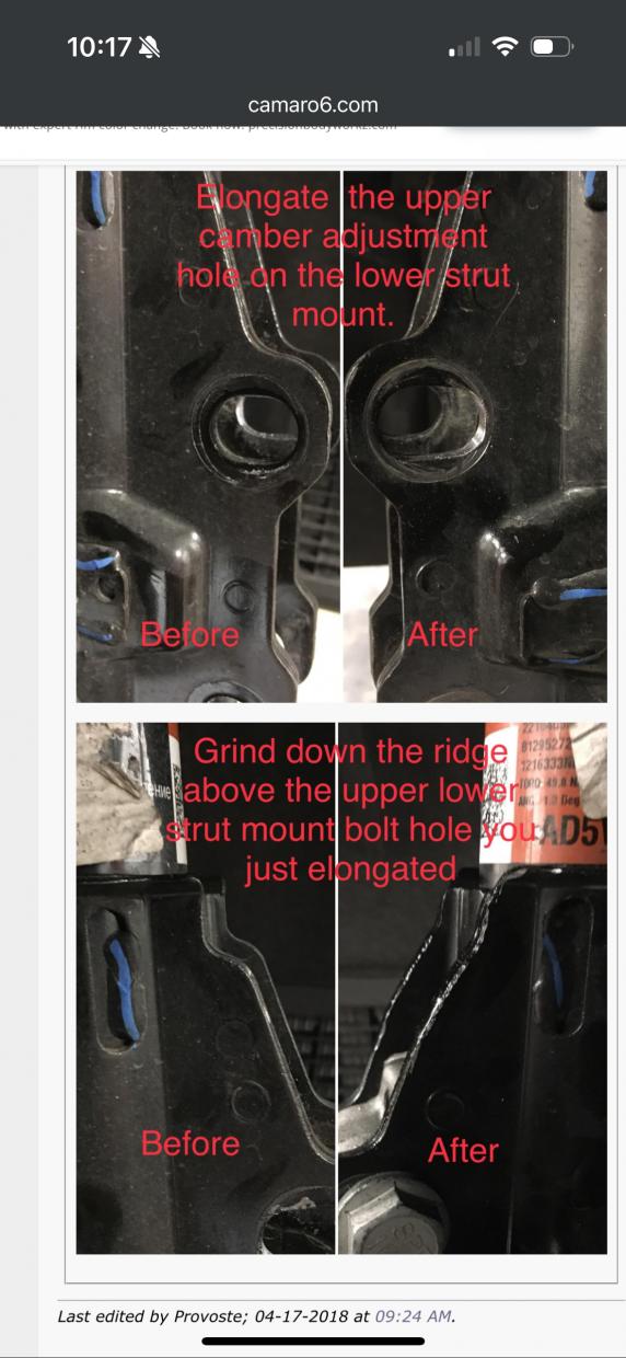

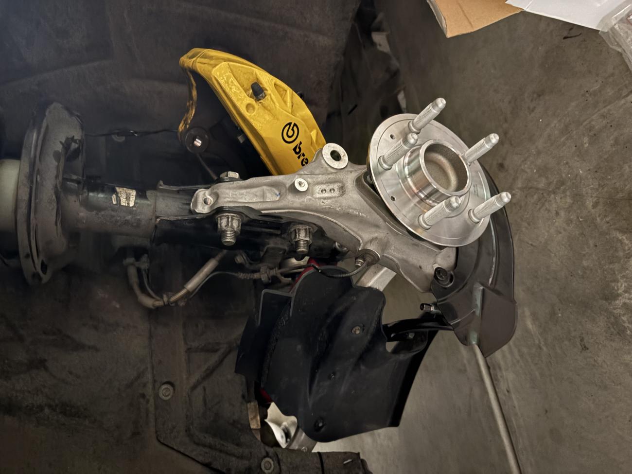

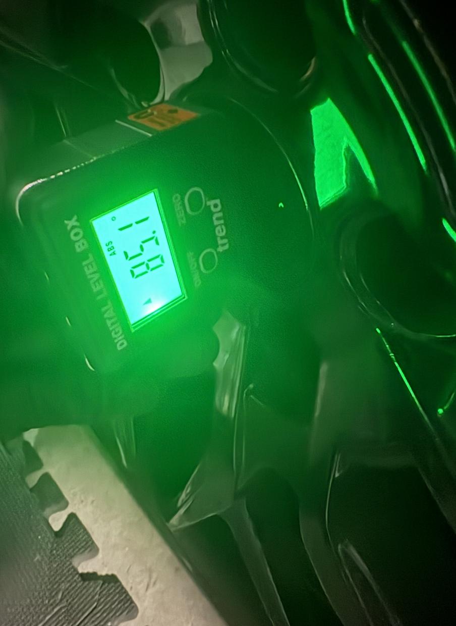

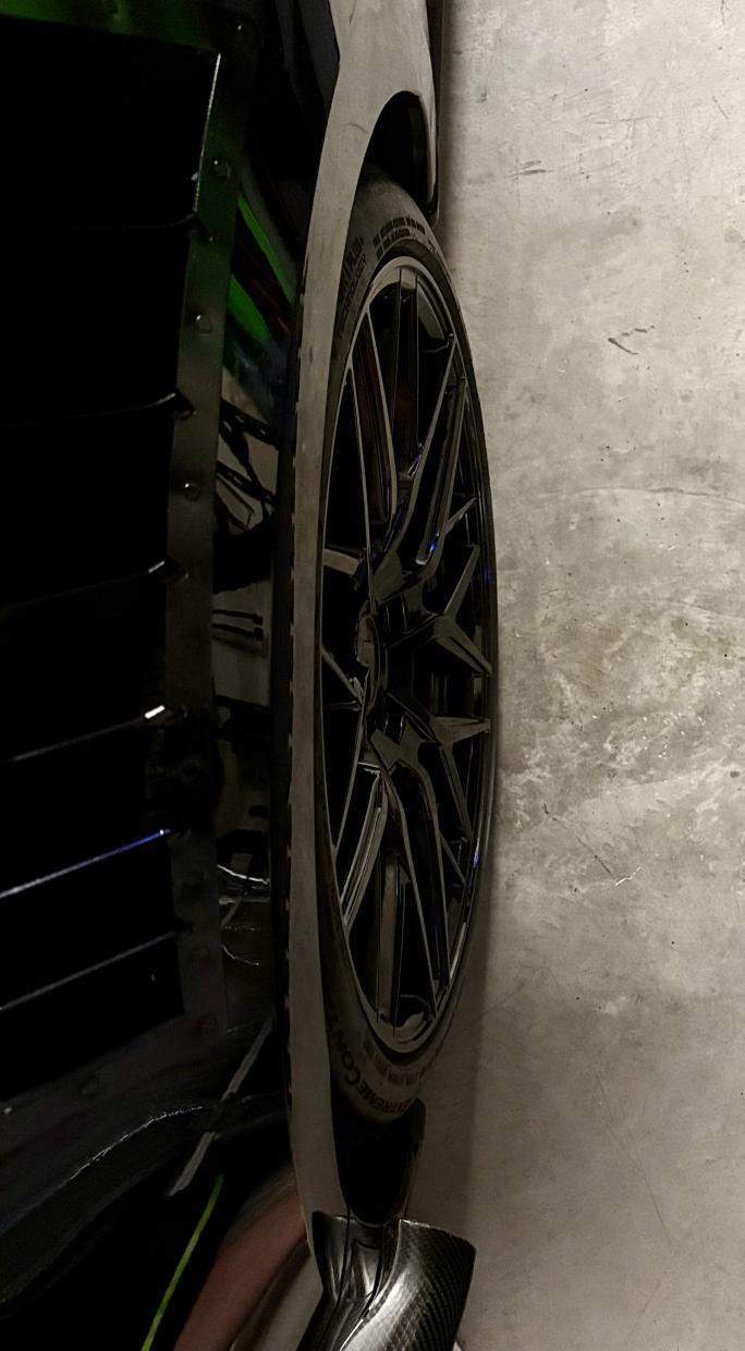

Alright, so I not only replaced the stock front knuckles with the Cadillac performance ones, but lengthened the upper knuckle bolt to allow the knuckle to almost touch the strut. Swapped in new outer tie rods and new wheel bearings while I was at it. I have an alignment scheduled for this week, but as it stands on the digital level, I’m at -4.9 up front on the driver side with -4.5 on the passenger. Visually, you can see the more aggressive camber. I’ll have the shop dial out to -3 front and -2 rear.

did you try that same modification to the strut before you went to a different knuckle?
Old 11-12-2025, 12:11 AM   #14
S.Macias
Monterey County Camaros
S.Macias's Avatar
Drives: 2016 Camaro V6 1LT
Join Date: Nov 2019
Posts: 565
Nope, probably could have saved myself a couple hundred dollars if I just modified the knuckle bolt beforehand, but I wanted to make sure I could get to -3 fronts without further issue. Figured it all ended up being hundreds of dollars cheaper than camber plates, so it’s a win in my book. But I believe just extending the bolt hole will let you hit -3 according to other forum post
https://www.camaro6.com/forums/showthread.php?t=526353
