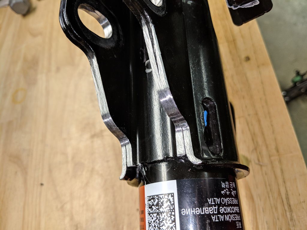

I thought I'd add some more pictures to the thread.
Before modification:
Here's one of the test fits. Be sure to leave enough room for wheel weights to clear. I removed a little more material from the strut after this test.
After the modification:
After first coat of paint:
travislambert is offline   Reply With Quote

Provoste, thanks for taking the time to do this write-up. I found it very helpful.

Awesome! Glad you found it helpful, please post alignment #’s when you have them. Very clean job too- looks completely factory!

Very nice, did you use a standard carbide bit with a dremel or something different?

I used a Dremel with the 9901 tungsten carbide cutter. I used two bits although one would have done the job.
https://www.amazon.com/gp/product/B00004UDJJ
To clean it up, I used the Dremel EZ407SA with a 60 grit band followed by a 120 grit band.
For the slots/holes I did all of the cutting with the 60 grit band (no cutter). For consistency I checked periodically using a digital caliper to remove 1.5mm of material from each slot. If you don't plan to remove any material from the back of the knuckle, 1mm is probably plenty.
