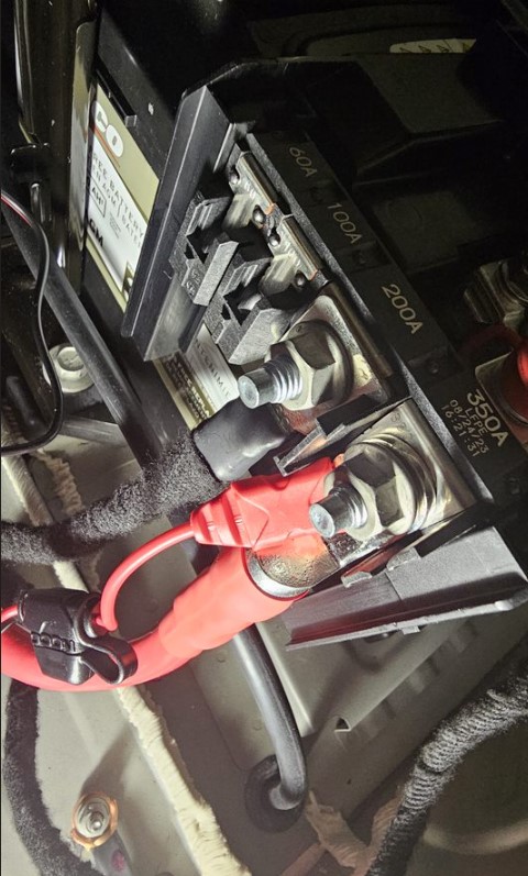

Battery Terminal Question
It gets old raising the hood and clipping there. Definitely hard wire and just plug up.
$40 bucks for one of these.. https://www.amazon.com/gp/product/B0...?ie=UTF8&psc=1
Attachment 1160439
Attachment 1160440
Attachment 1160441
Attachment 1160442
Attachment 1160443
Not an electrical minded person, can someone please tell me what the amperage (assuming amperage anyway) numbers signify on the connection terminals (see 2nd atch-440)? Should only certain type devices be connected to a particularly rated terminal? Same with the terminals on the engine compartment fuse box, just don’t know why the different ratings. TIA
Those are maximum ratings for those terminals. For example, you should should not use the 100A terminal for anything drawing more than 100 amps.
A device like a trickle charger will draw a few amps at most, and can be connected to any of the terminals. The 200A terminal is a safe bet as shown in the photo.
You do want to disconnect the negative terminal on that battery before messing with the positive side, to prevent any accidents caused by tools touching bare metal.
If you are not comfortable with electrical stuff, the underhood terminals are what I would suggest using.

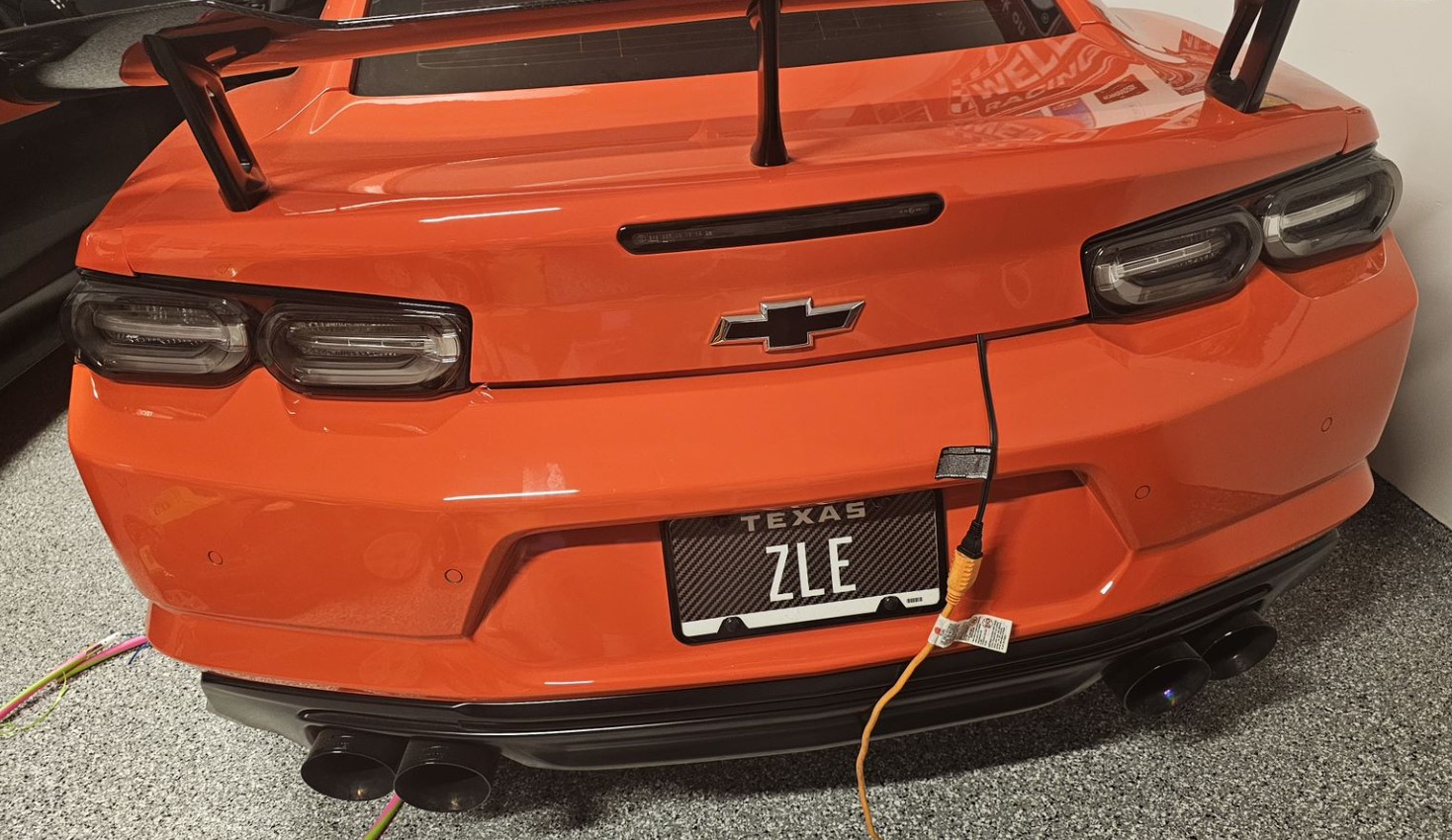

I am wanting to see how I can run the wire so it is not between the seal and the trunk.
So far, it has not seemed to show signs of imprinting on the seal.
Trunk can fully close.
Site turned my photos for some reason, they were 90° to the right when taken and submitted.
Assuming you always park the car inside while trickle charging, I would leave the trunk ajar.
I would not risk deforming that trunk seal one bit. Too many horror stories here of water in the trunk.
It is in the shop, covered and on dollies during the winter.
It's a weekend car.
This will be winter #2.
I will look for a way to make the install less temporary and not on/over the seal.
I have some OCD/ADHD tendencies when it comes to things like this, the more factory or better it appears, the better I feel.
Under the hood may be the way it ends up, but for now this is the way it is.
