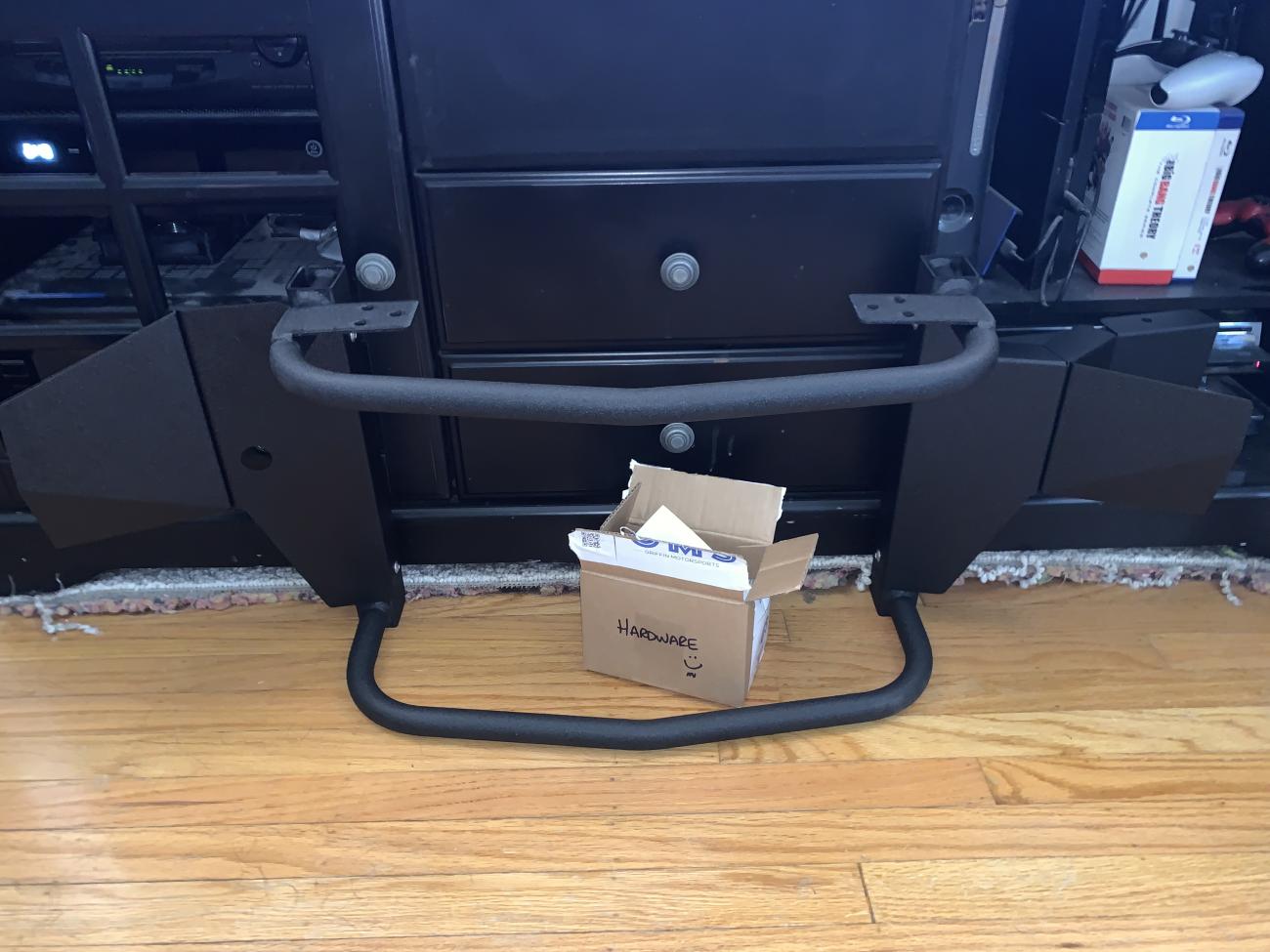

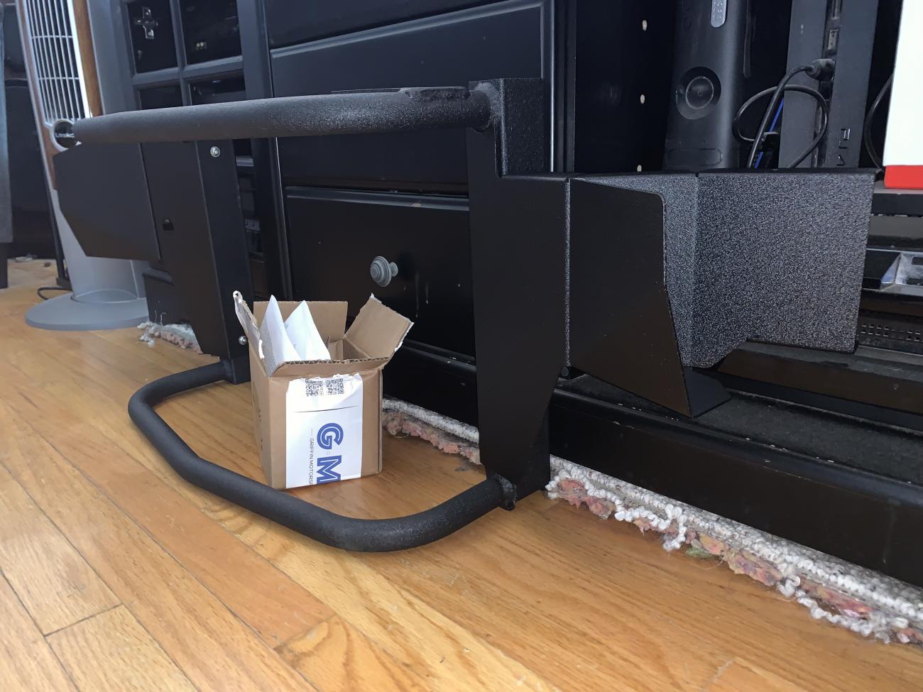

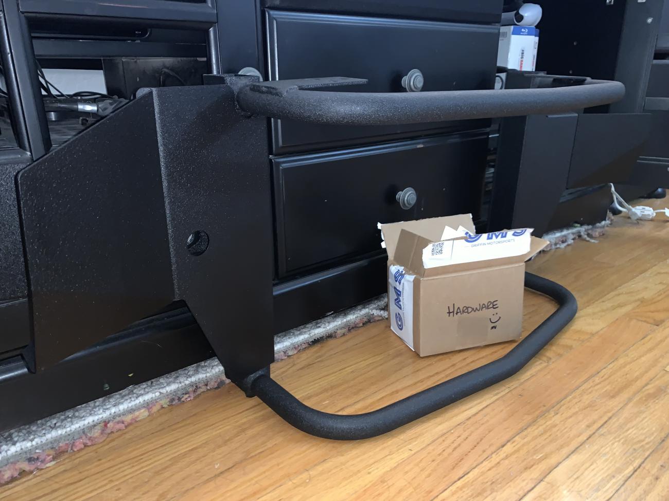

AWW SCHITT!!!
Fun times for the weekend!!!
THANKS, GABE!!! You NEVER fail to impress!!! The redesigned deflectors look AWESOME!!!
'20 ZL1 Black "Fury"

AWW SCHITT!!!
Hell yeah baby... I think you got the first one delivered of the 10 or so pre-orders from this batch! Excited to see your final photos. Don't forget the install instructions are downloadable from the website. Email me if you have any questions at all, ad thanks again for the support!

AWW SCHITT!!!
Sweet! That looks great! Can’t wait to see it installed in your beast.
I'll bring the pics' for sure!!! I better clean the whip for them!
