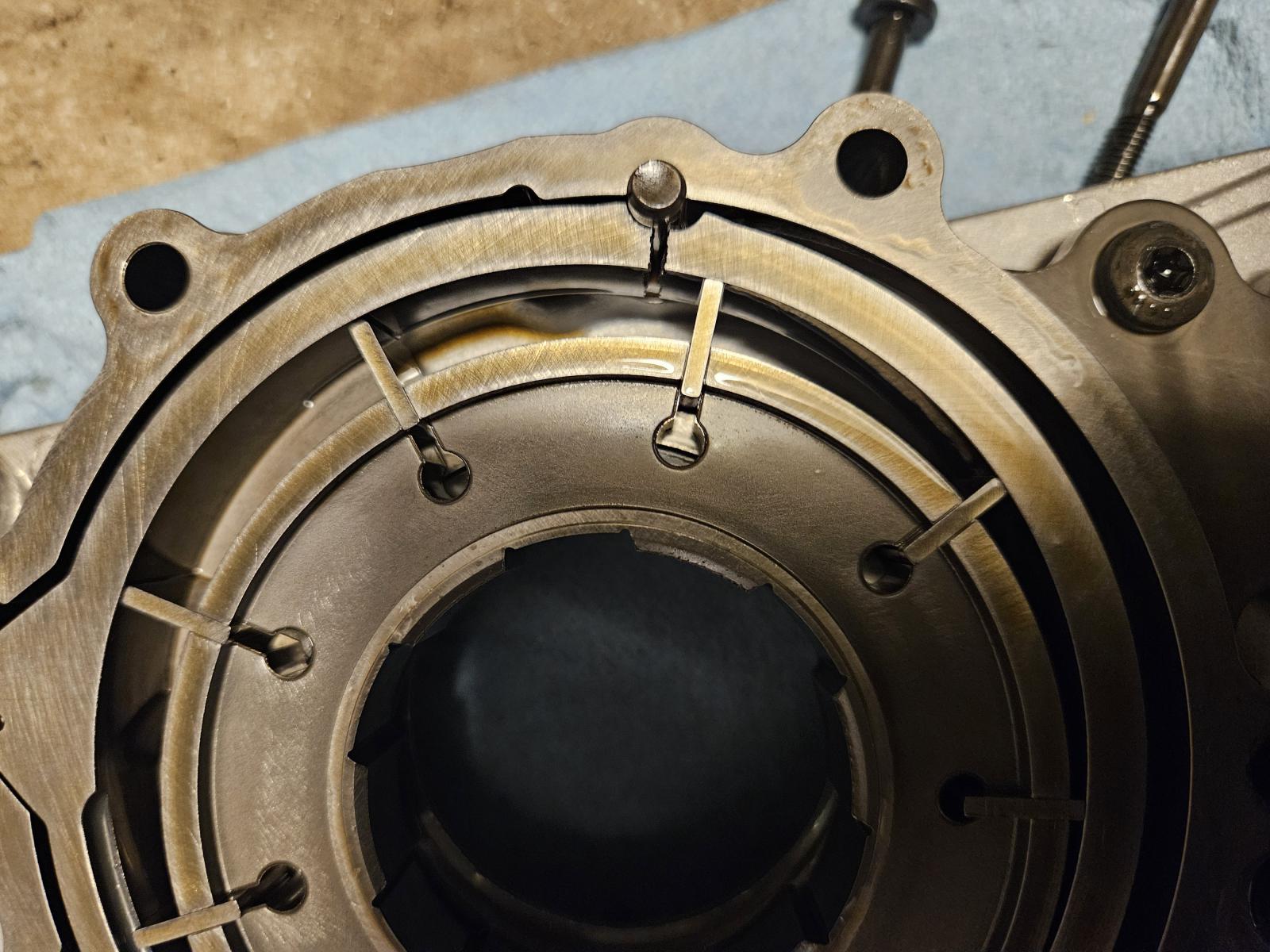

What is this oil pump failure you speak of? I'm unfamiliar. Unrelated, check out this picture I took a few weeks ago.
Mods being installed-
That is it. it will slowly break away all the pump vanes.
