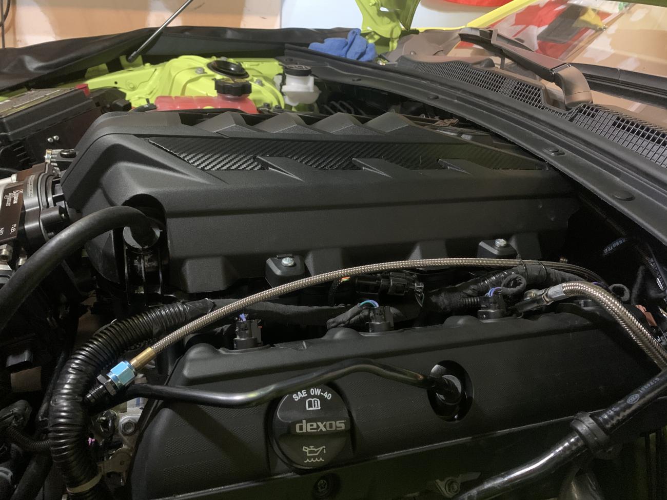

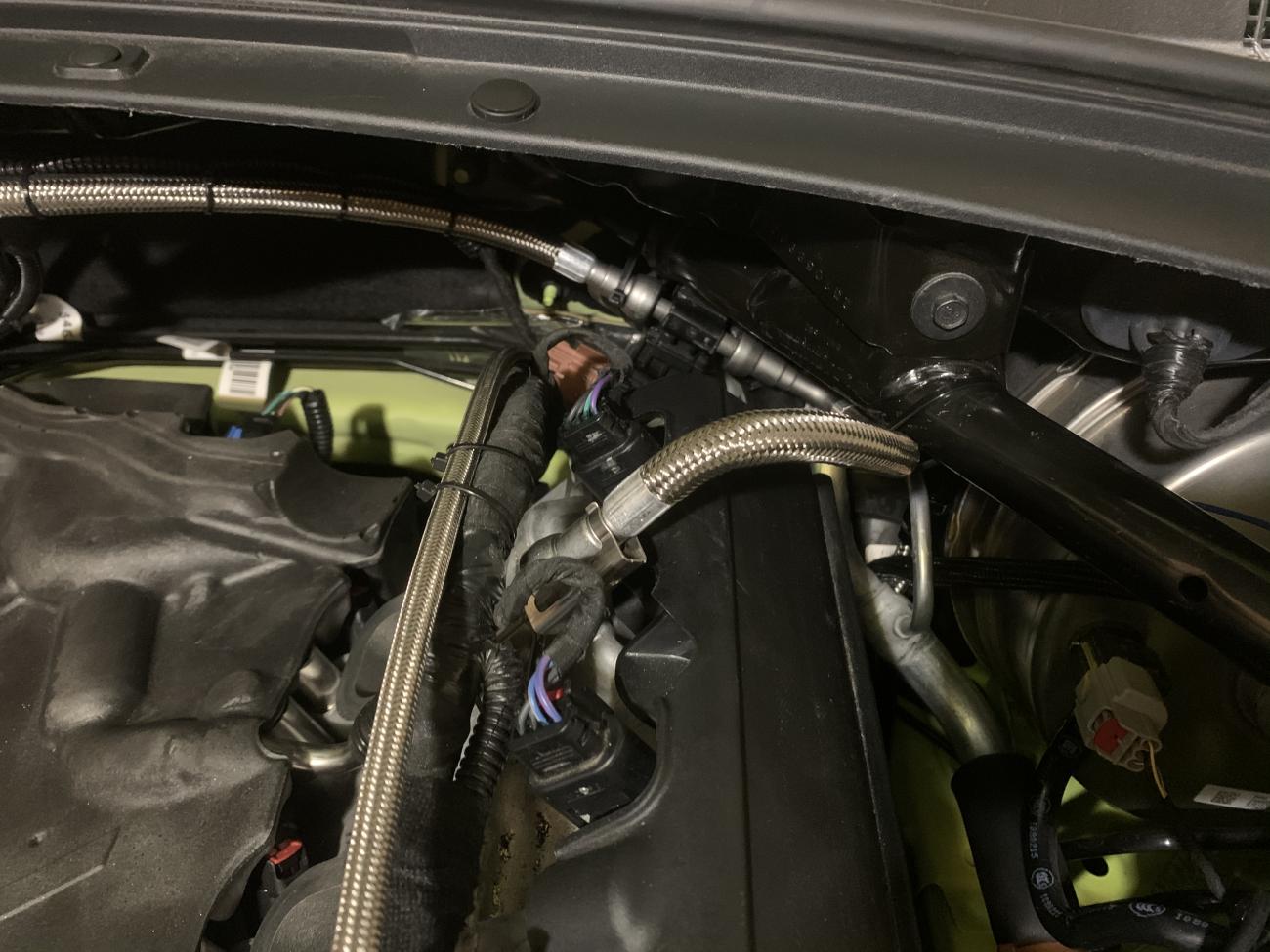

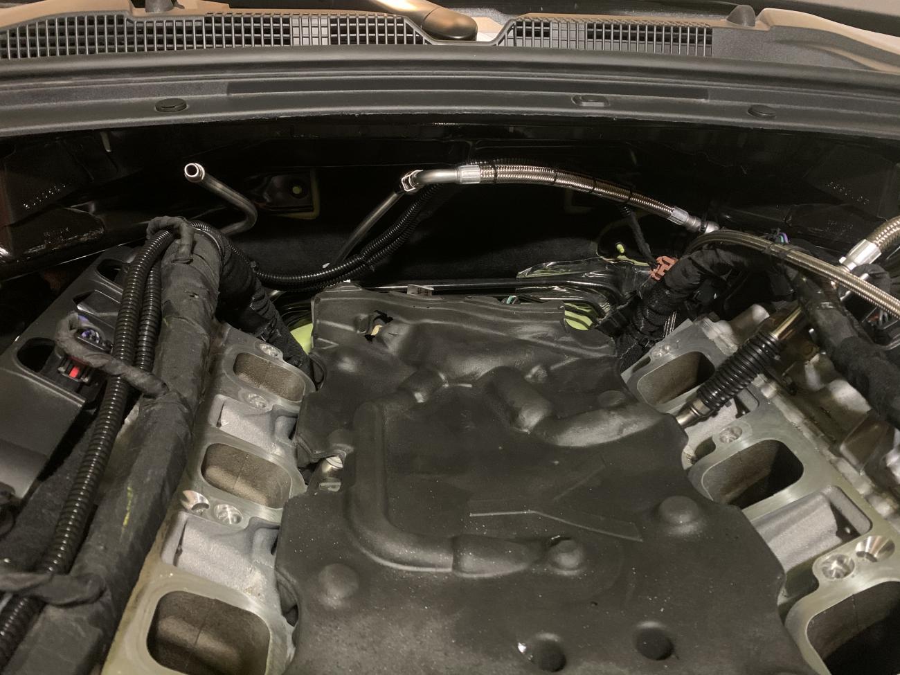

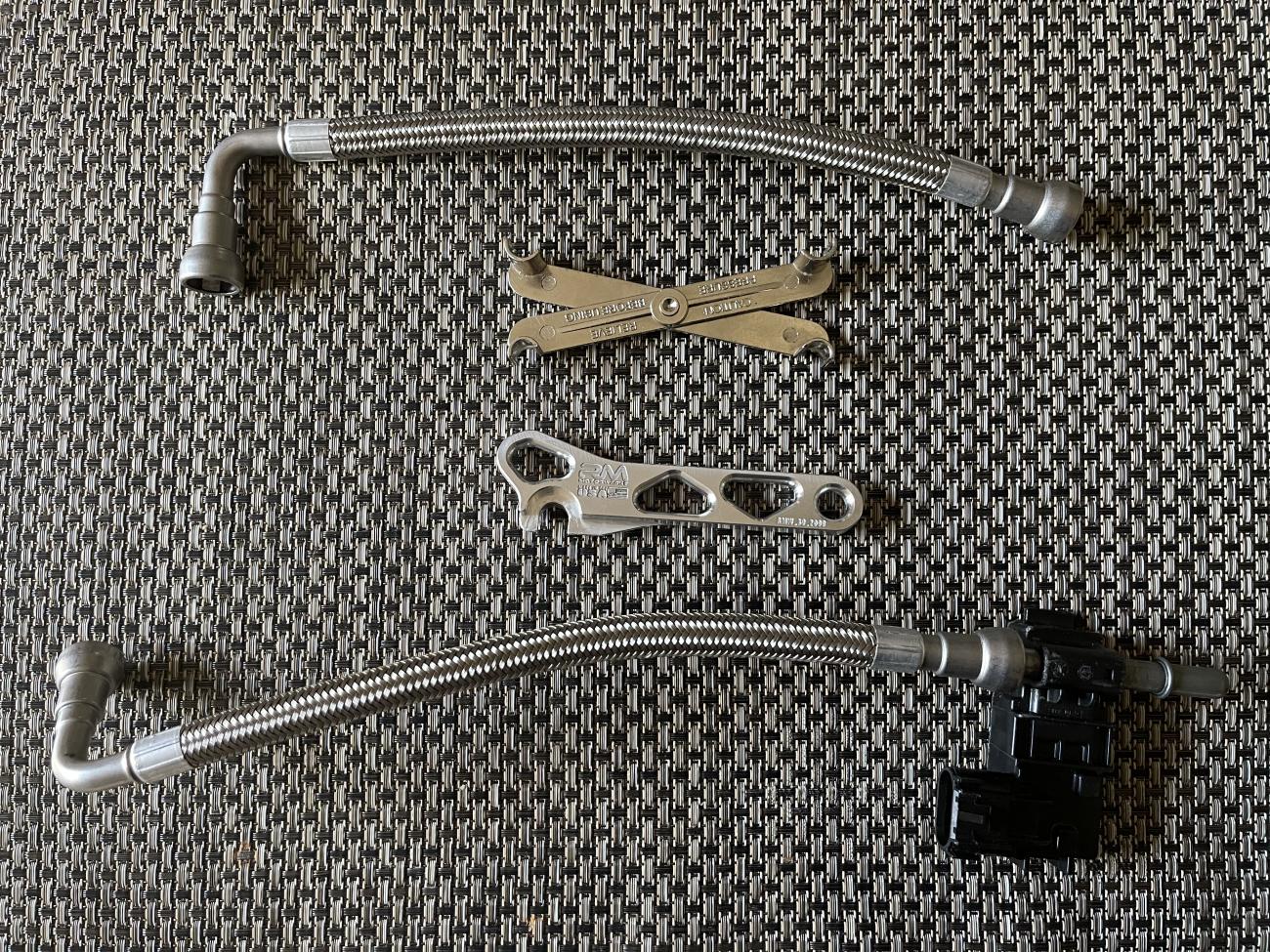

Reroute of fuel line on top off intake manifold.
I decided to put the fuel line behind the intake manifold instead of leaving it draped across the top of the manifold. You will need to buy two fuel line from Summit or find/make a longer one and do it with out the E85 sensor or inline fuel filter with a barb. If you have E85 your half way there and if you don’t have E85 just get a inline fuel filter with barbs. This is not for everyone but if your like me and can’t stand that fuel line on top this is possibly what you should do or do your own modify fuel line set up. You need to take the clips off the fuel lines on the passenger side near the firewall so you can push it over freely. I zip tied the E85 sensor and the fuel lines/E85 wires. I also shaved the back portion of the intake manifold on top for an easier fit. I basically have to much time on my hands. Lol.
Ideally I would like the sensor bolted to the firewall. Will have to look for a solution. Clamp?
Side note:
(One thing, once you vision your set up and routing of lines and once you put them on the sensor you can’t get them off due to location of sensor body parts. At least I can’t get the removal tool to slide over because of sensor design. Over the inline fuel filter looks fine. Anyone know how to remove the E85 lines on sensor please let me know. )

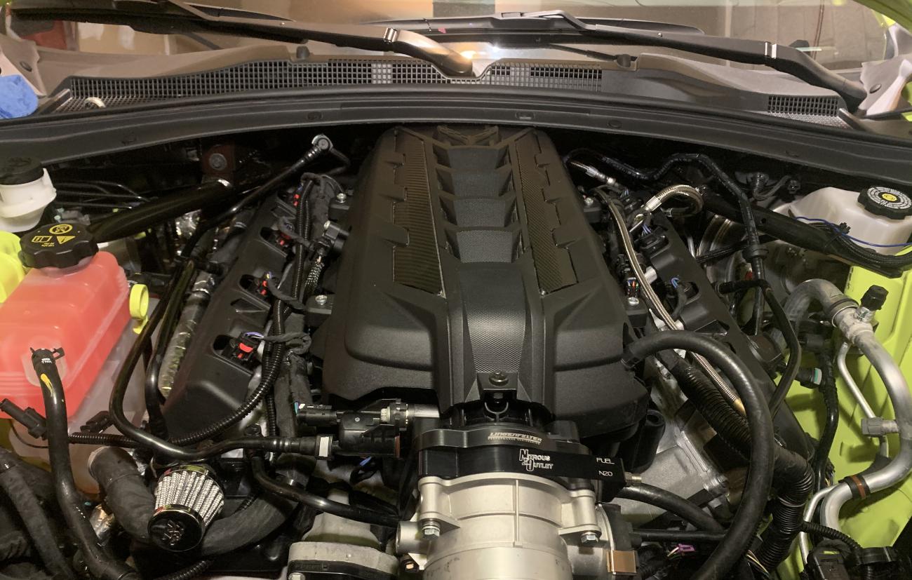

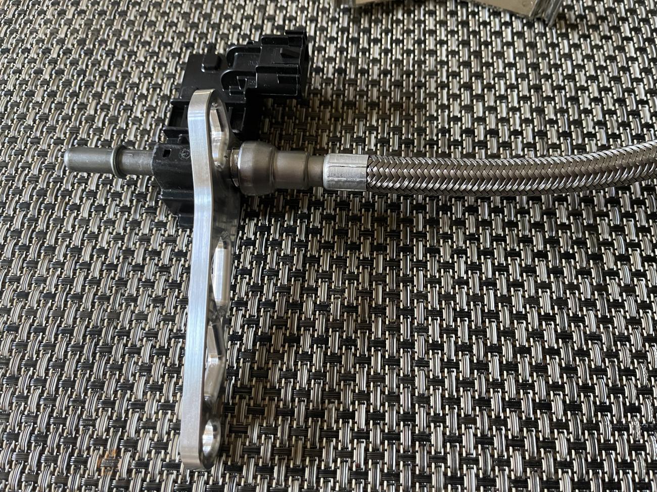

Small update on E85 sensor.
When I purchased the braided hoses for the E85 sensor and put them on I didn’t pick the right angle or end of the hose to connect to the sensor in order to hide the sensor behind the manifold the best possible way.
I have the tool to disconnect the line from the stock set up but could never figure out the disconnecting method on the sensor. I wanted to reroute my lines but couldn’t till I found this tool online.
I thought I would share this info to anyone that’s in the same boat as me.
https://www.rmknox.com/rm-motorwerks...nect-tool.html

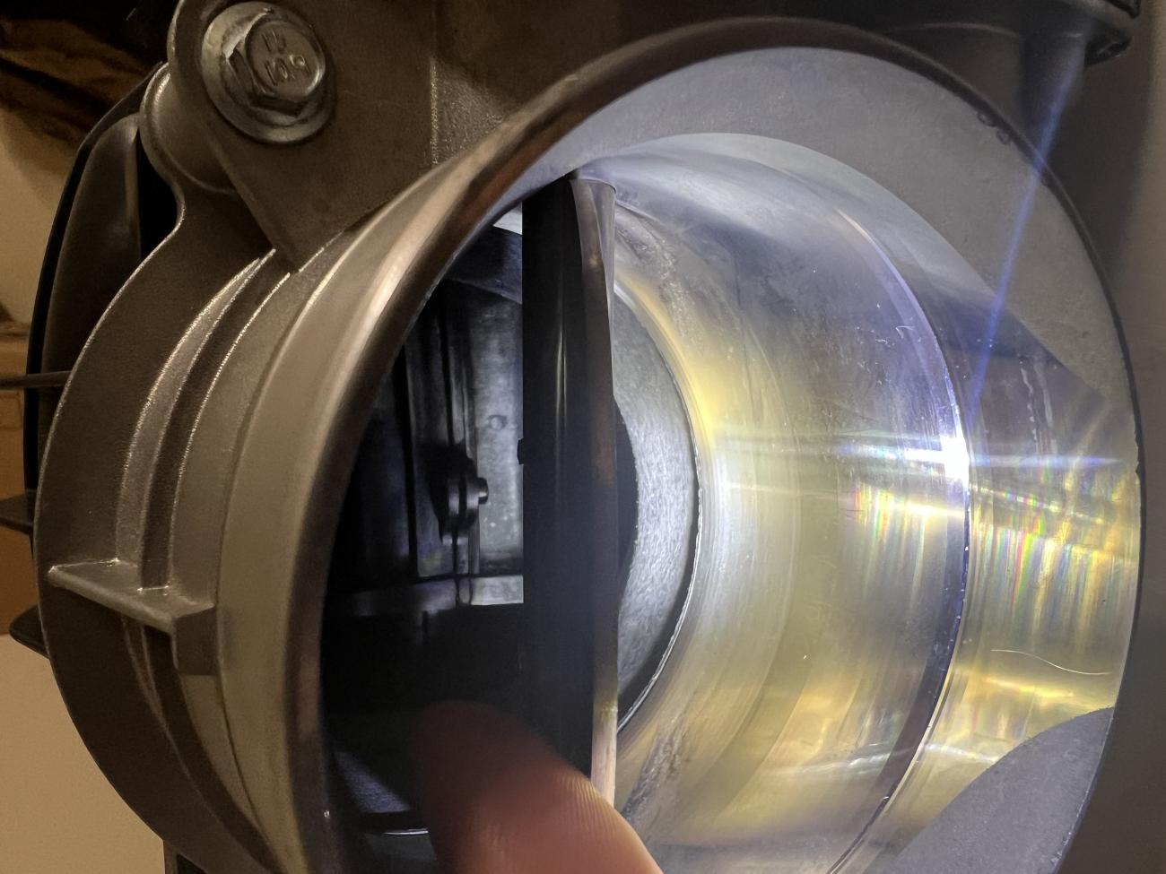

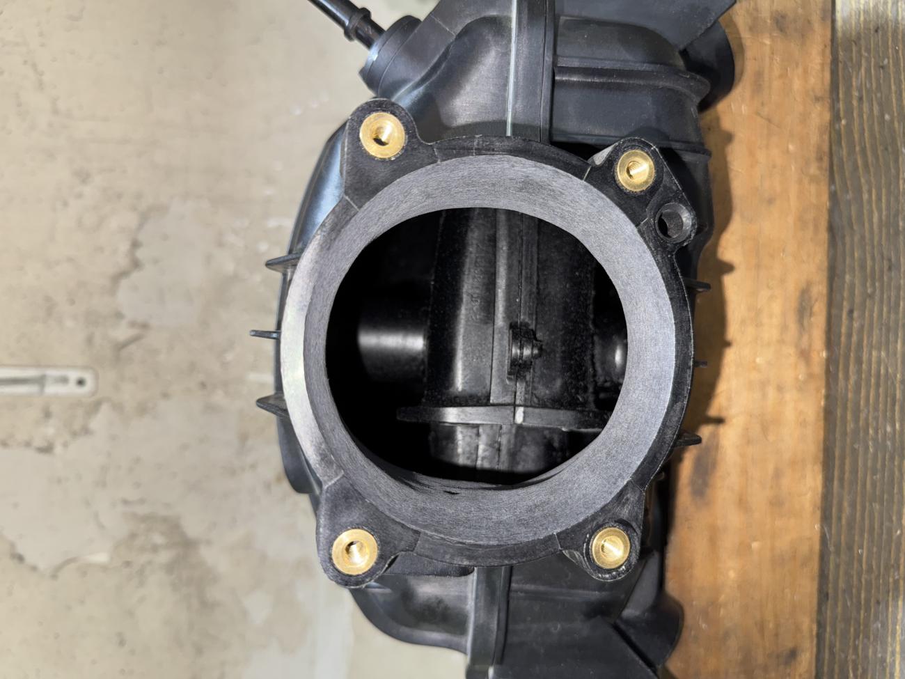

Anyone knows if the snout was ported too much? I thought the snout should have a smooth transition with LT5 TB housing?
Yes, you're snout is over ported for the 95mm tb
