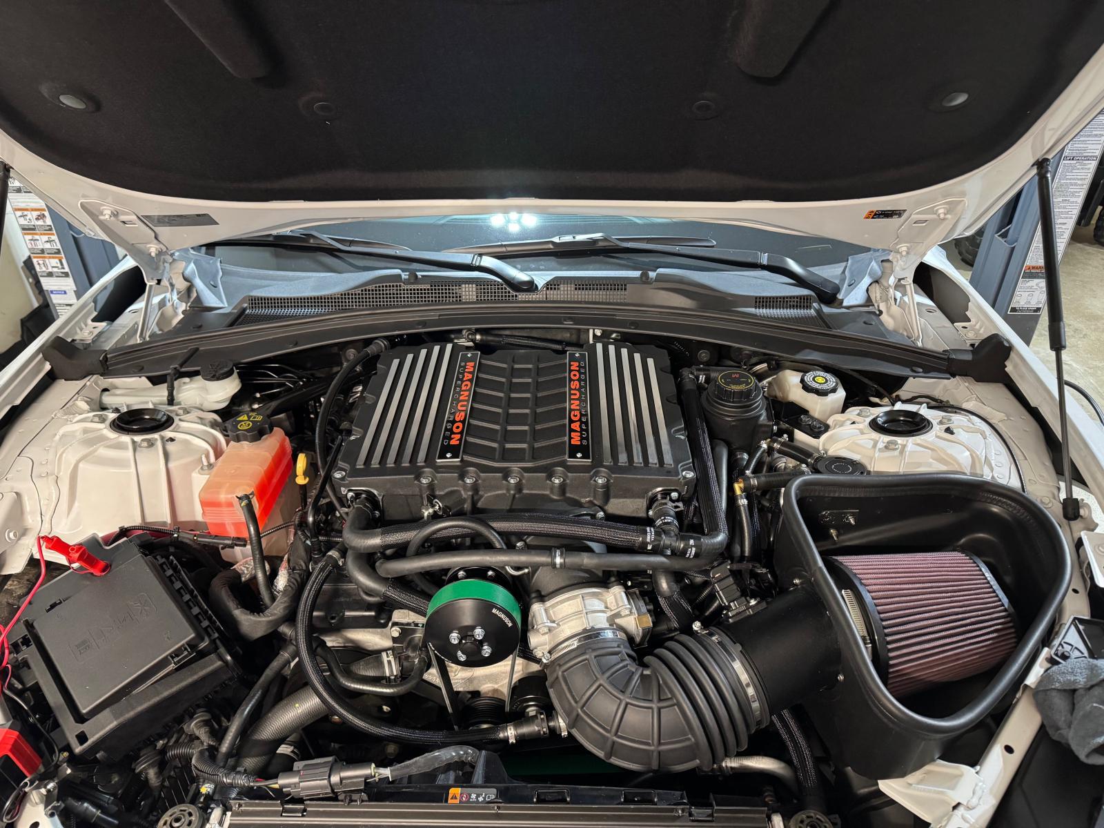

Update: Car made 593whp/602wtq . Overall, install was very straightforward. I'd rate the difficulty as medium - using the HPFP alignment tool, a proper seal puller, crank pulley puller/installer and a trusty plastic hammer made the install relatively straight forward. Jannetty did an amazing job with the tune and the technical support!
Mods include The Magnuson 2650 w/ 100MM upper pulley, LT4 injectors/HPFP, JMS Voltage Booster, Rotofab intake, 170 T-Stat, Corsa axle back and a Mishimoto catch can.

Car is a 2018 SS1LE with 9K Miles.

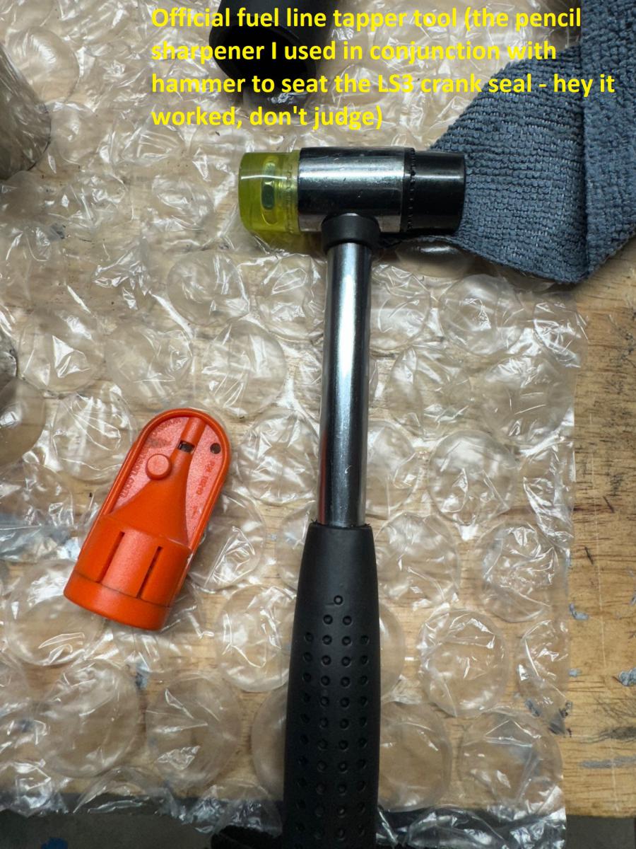

- Something not in the Magnuson instructions, The Magnuson supplied fuel line that connects to the output (Male connector) of the LT4 HPFP hits the OEM fuel lines and simply doesn't fit. JRE instructed me to gently use a plastic hammer (pictured below) and very slowly, gently tap tap tap away and move the connector more toward the driver's side. Another thing to do here, the fuel lines (where circled below) can potentially stick up and hit the bottom of the 2650 as referenced in Magnuson's instructions. I used the same hammer to gently tap the line downward to ensure the highest point of the line was below the top of the nearby bolt. I had no clearance issues after these steps.

- Use the LS3 seal, and as pictured below, install it dry, and ensure the correct orientation (LT1 seal is inverse from typical crank seals - the LS3 seal installs flat side facing out). I learned after the fact that some folks use brake clean to help with the ease of the crank seal install (because it dries to fast, it counts as a dry install still). I didn't do this, but I'll try it next opportunity.

- I had to manipulate their supplied intake elbow a bit to fit on my LT1 Rotofab air box, and then the Mishimoto catch-can into the side of the box, but these are obviously outside of The Magnuson kit. I will likely explore a custom bracket to fit inside the Rotofab box that'll provide a more attractive solution to the catch-can mount.
- Because I upgraded the fuel system, Ted was able to install a smaller upper pulley to spin the blower faster, and got a whopping ~50WHP/WTQ gain. End results are above, video is great that they provided.
