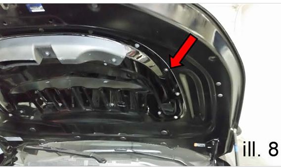

Not sure if it's in the area you are referring but when I installed mine 7 yrs ago they supplied a button head bolt to replace the hex head bolt in this location because of a clearance issue. Pic is from install instructions
Attachment 1157310
Yes I was thinking the same thing ZED SLED. I replaced the bolt with the one in the box also.
