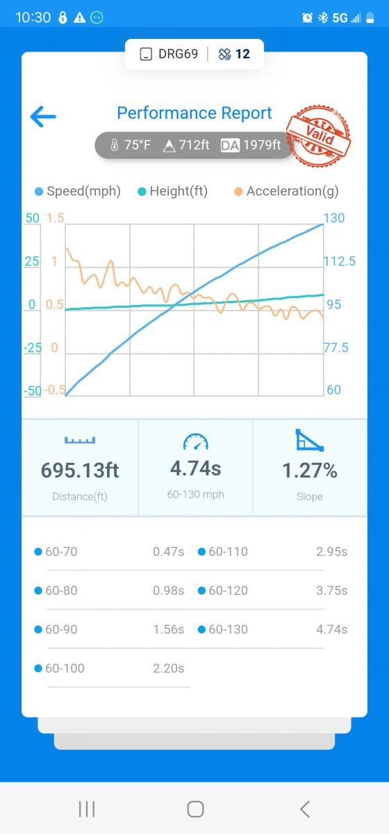

I believe MAF is tweak because we run the THP port injection with the reflex so that could be why. I do these runs in track mode, Pattern A, Pattern B is just shift point and mph I believe, I am also not a tuner but that's what it in the VCM editor.
Attached best 60-130 for this setup so far.
