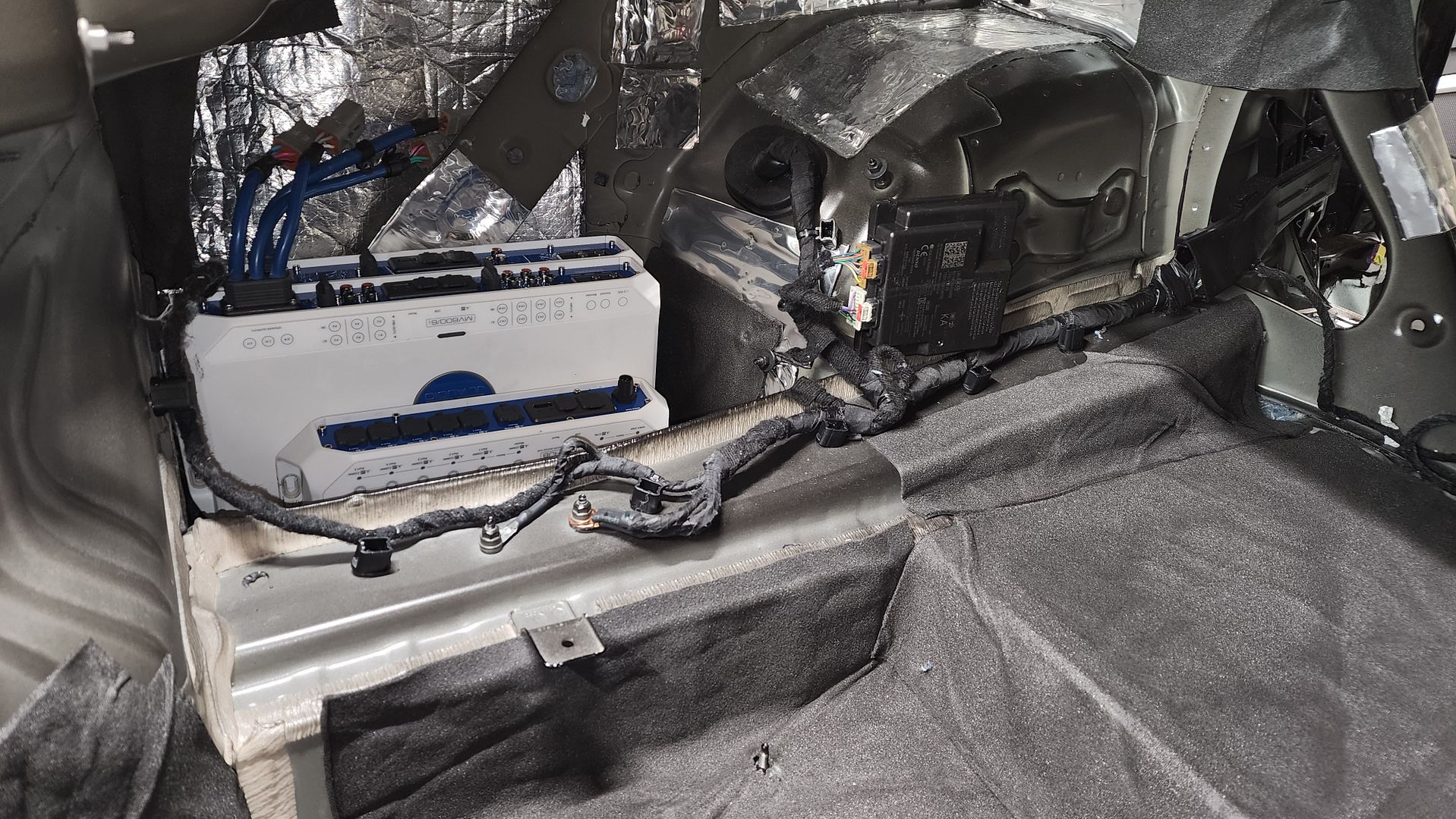

There is a lot of room on the driver's side.

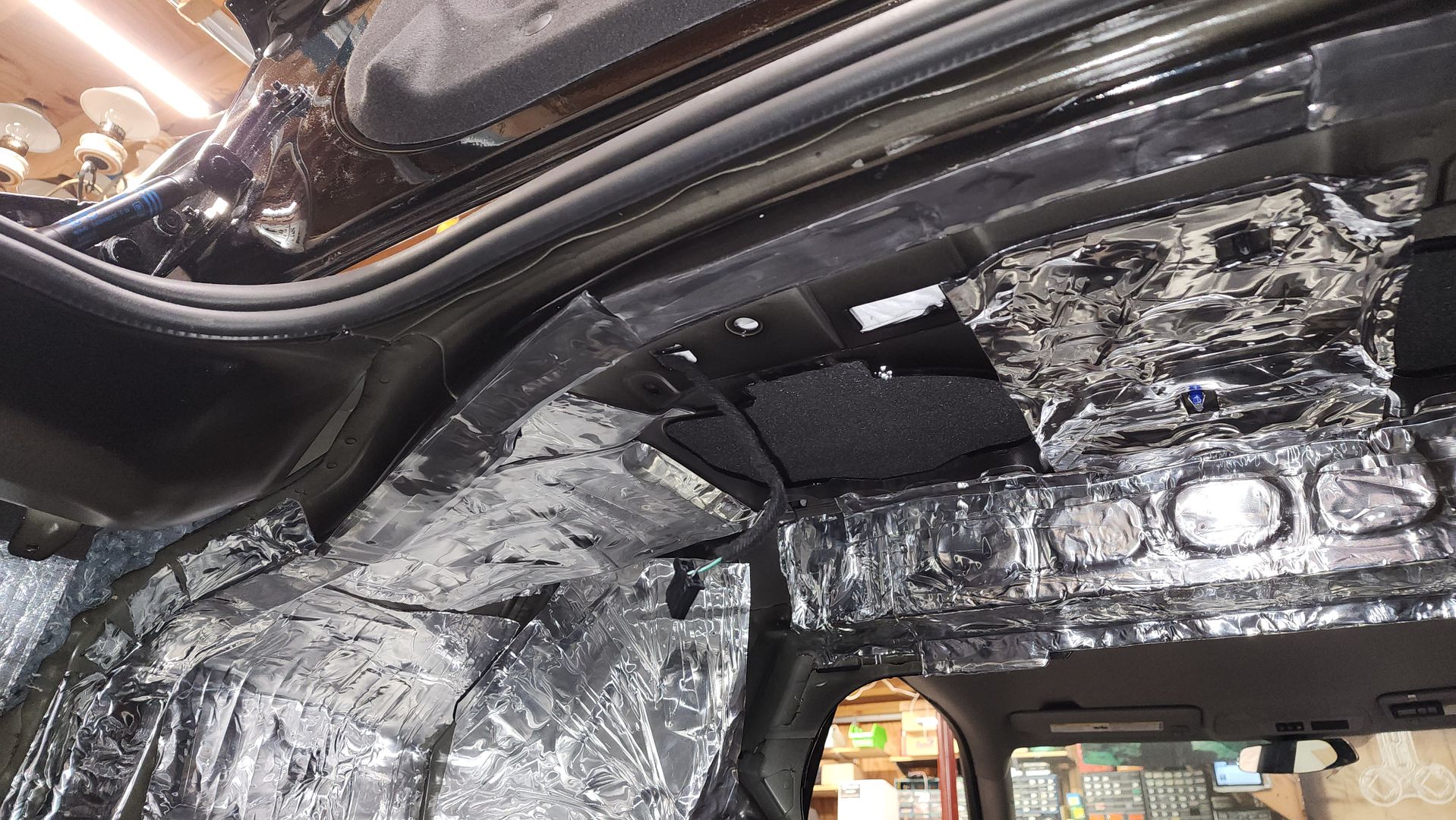

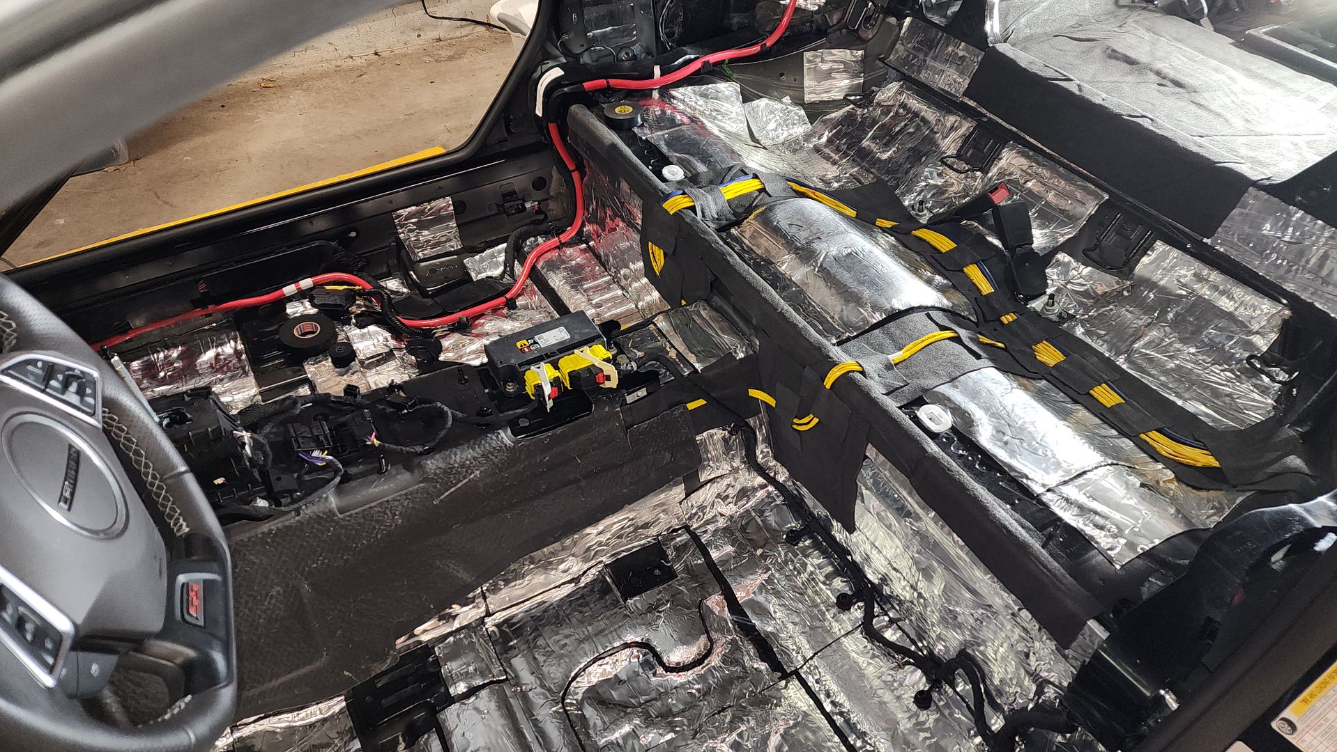

I like the StealthBox, and it's worth the price, but I'm wanting to put my amps in that recess instead. I haven't finalized the decision yet, but this is the fitment:
Acoustical treatments will go a long way in making that sub sound a lot better. The hollow cavities in this car are an awful platform for a sound system. I have all cavities filled with sound absorption, and metal surfaces treated with a combination of CLD then CCF over top.
