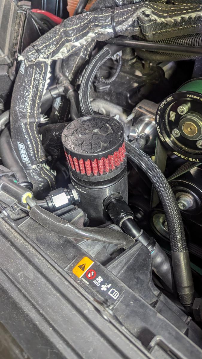

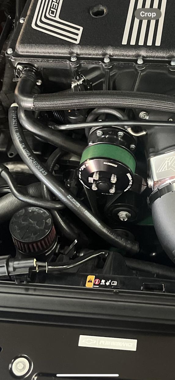

Yep, I’ve been running the -12AN line with my MM Wild from day one. We’ve had LOTS of “learning experiences” in regards to boost and fueling lol… still using an LT1 front seal and OEM rear main with no issues at all… We definitely would have popped one if we didn’t have this setup. <furiously knocking on wood>

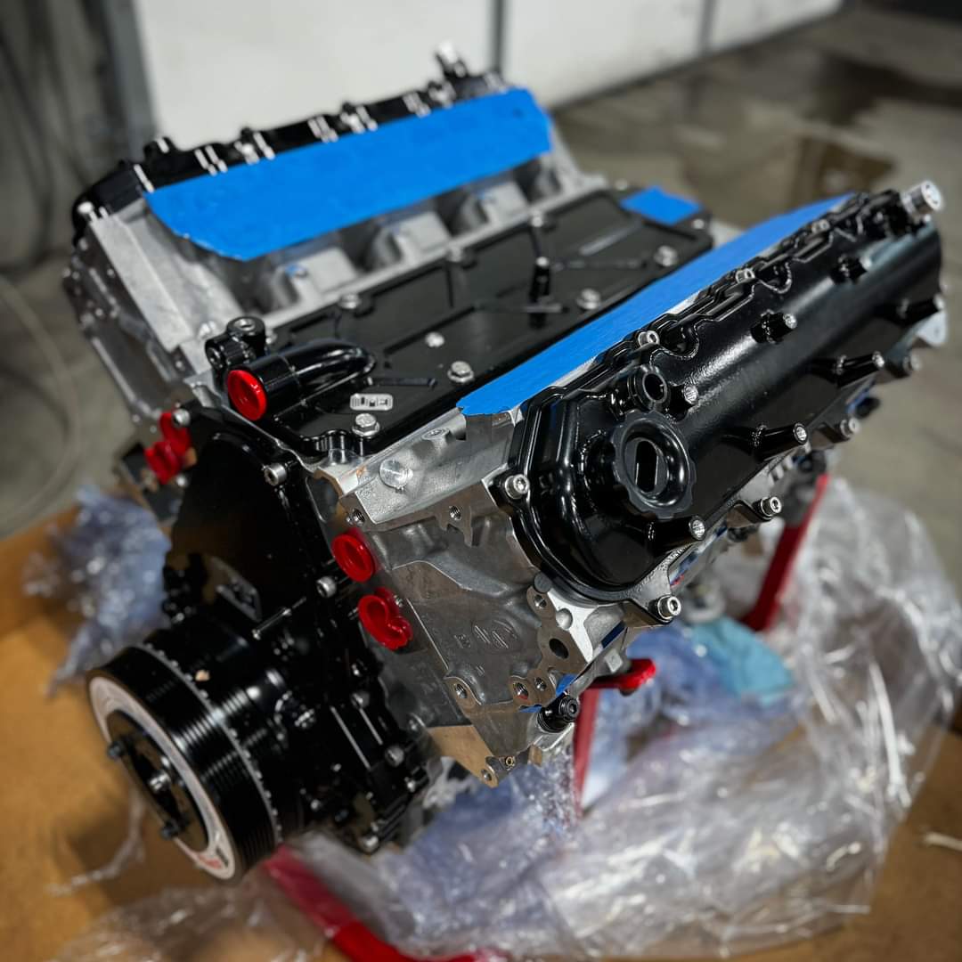

As you see here, each valve cover has two -10an breather provisions front & rear on the valve covers. The CC is connected to the rears, and LME says to use the fronts for crankcase breather caps. LME used a complete LT rear cover with seal.

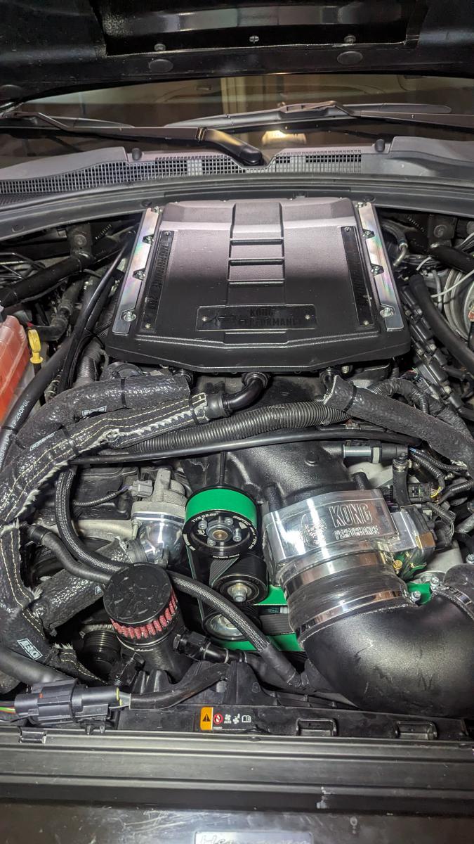

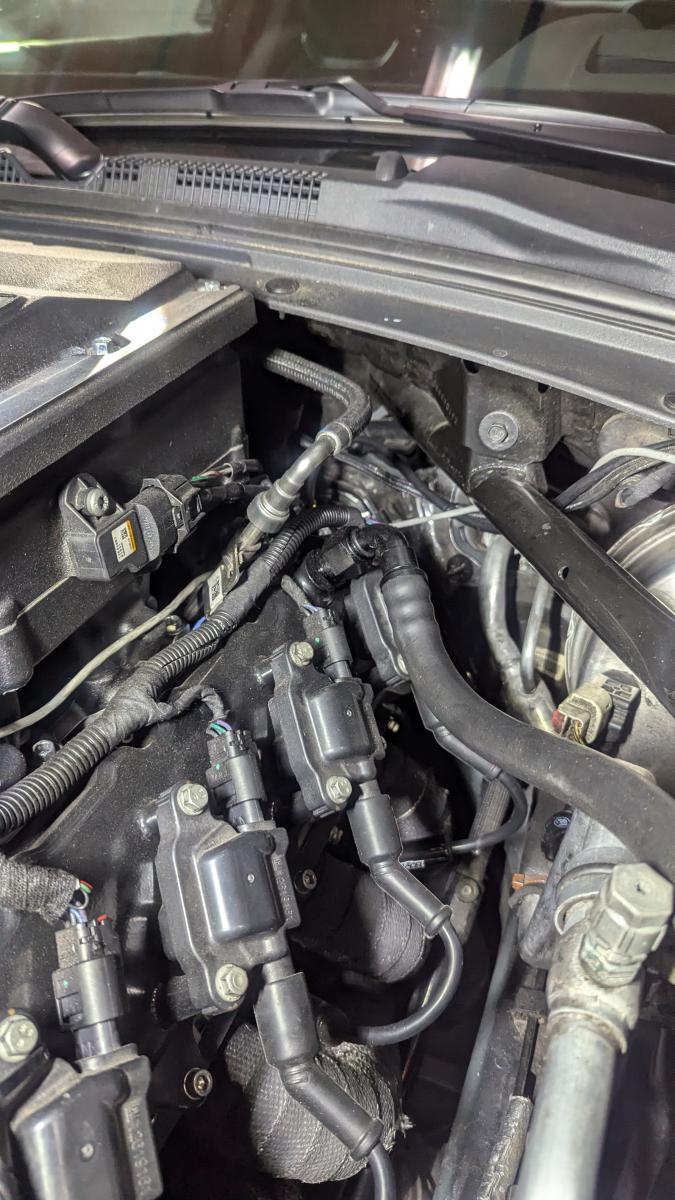

Looks to me like you need to upgrade the line that goes from the intake to the PCV junction box. This will help evacuate crankcase pressure with vacuum. I went with the JRE kit he sells that comes with a 5/8 hose and fitting.
