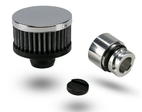

I don't bother with catch cans. I blew out my rear and front seals over a couple events. Both returned to normal and continue to not leak after the event luckily. The vent line on the air intake really was too small to capture the multiple ports worth of crankcase air. One event was due to it being pinched accidently after an install of another component (my fault).
Since then I've had them both replaced with LS-3 seals (stiffer) and installed of of these: https://metcomotorsports.com/mbr0003
Years later and no more issues. It has a 1 way valve to prevent any unmetered air from coming back into the engine. Do this!

I run metco breathers on my engines. That being said the MM wild catch can has a breather so it should do the same thing, but you might try adding the Metco breather on the Valve cover.
I had a rear main go out on a new 5.3 LS(mild build) that was less than 1k miles old. Replaced seal added Metco breather, no issues since.
If you don't want to try the Metco breather, One thing you will want to make sure is that your breather lines are all upgraded to -10 and routed correctly for the MM wild can to vent crank case pressure efficiently.
That catch can breather depends on the lines going to it to be able to manage the volume of air in the crank case. Catch cans and their long small diameter hoses likely offer much more restriction and hold pressure in the system longer.
This breather is a large 1" size opening to the crank case with significantly less pressure drop. It can handle large volume quick impulse crank case pressure events much better than any catch can could (shifting, snapping off throttle, etc). When vacuum returns to the crank case it seals off the vent with the floating disc.

Yea I agree which is why I run the Metco breathers on my engines. But the MM wild does work well if you increase the breather line(s) diameter to -10 as I mentioned prior.
That is one nice thing about Whipple's. Is they upgrade the factory vent lines with their kits. It definitely becomes an important thing to address as you turn the boost up and make more power.
And I still believe catch cans are important to keep oil from being ingested. That will cause detonation and power loss. Stock LT4's get quite a bit of oil blow by through the PCV system. I have seen oil pooling inside the supercharger lid.
