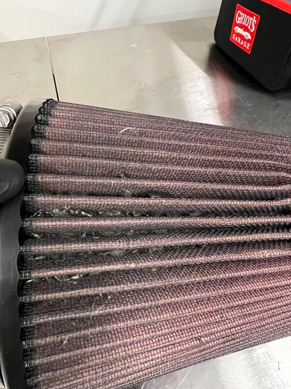

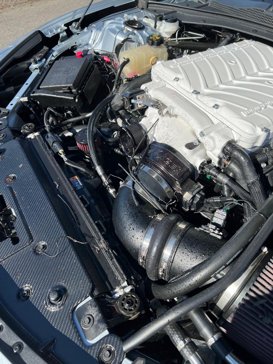

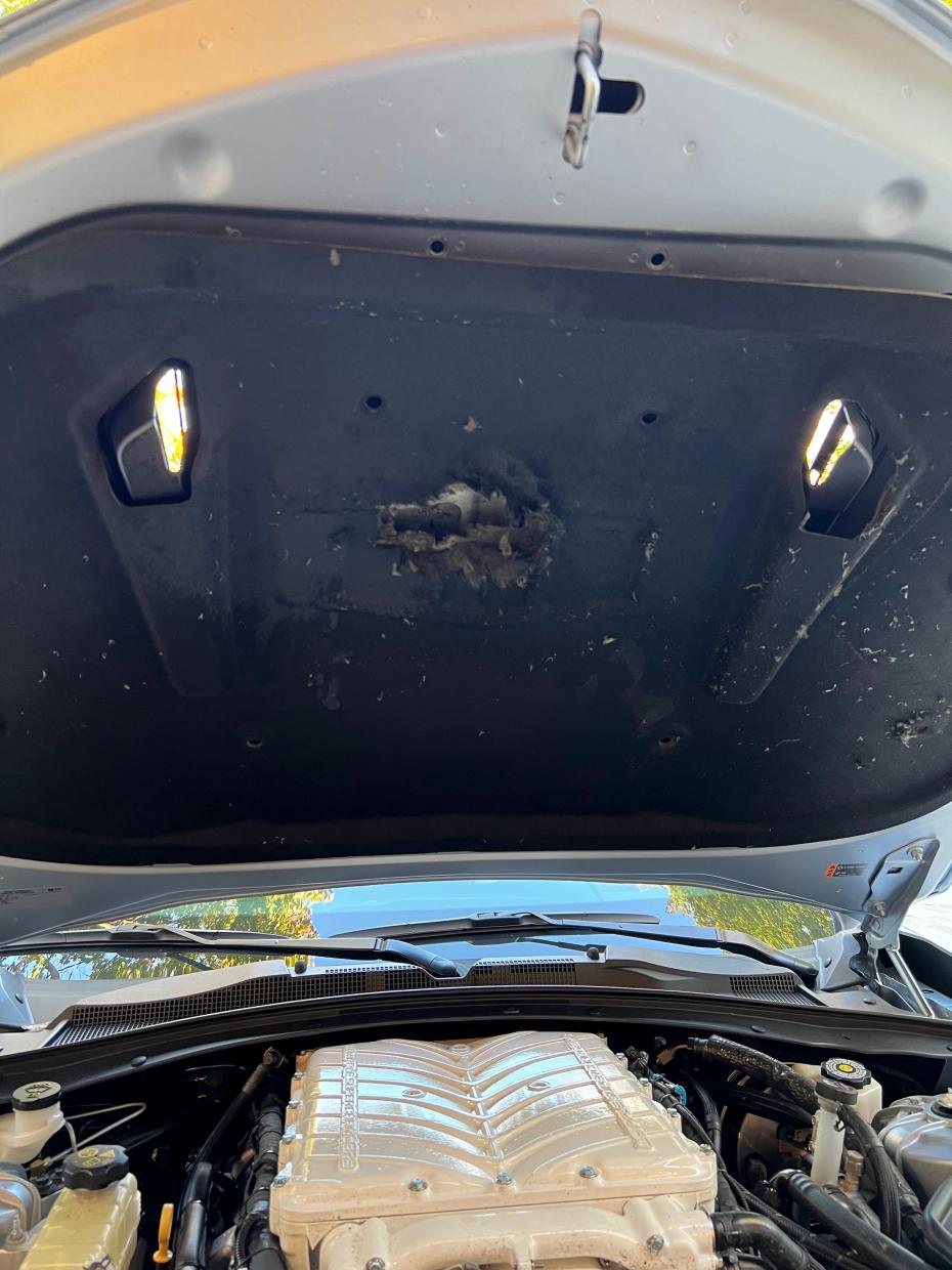

I saw about 15-20 WHP back when I was making low 900’s WHP. Which sounds good, but it really raises heck with your MAF scale. Plus it deletes your air filter…the one time I thought about running it at the track, I had a blower belt snap and launch a ton of debris everywhere (including the hood liner!). If I had run the Pray bell mouth all the debris would have all been sucked into my motor, so I was really glad I kept the air filter on.

No problem! The belt really wrecked some havoc for sure. For your enjoyment lol:

OMG! That’s crazy a belt did that much damage!!

Yep! Broke off the hard shell connector for the crank position sensor, wrecked the other two belts, sheared off the thermostat nipple (billet now lol), sprayed coolant everywhere, etc. I thoroughly cleaned out the entire engine compartment, yet 18 months later I will still find the occasional piece of belt in weird spots.
