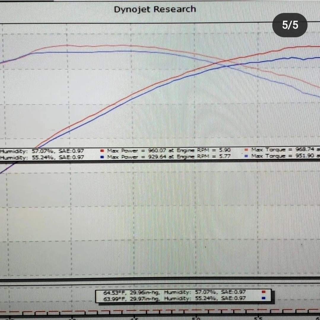

“We recieved another shipment of our Pray Performance Roto-fab Bell Mouths in. We got ten in and eight are already sold. We will place another order in a day or two if we get more requests. They are $150+shipping.
On my personal ZL1 we saw a 31rw gain in back to back testing. They work on N/A cars as well but the gains obviously won't be as high. We highly suggest you pair this product with the Velossa Tech Ram Air device we sell.
We recommend you only use these in racing applications as there will be nothing filtering the air entering the engine.“

The 31whp gain was on a car making over 900whp. You also need a 103mm TB to maximize the gains.
Brett also said he seen a 1.5 tenth reduction and 1.5mph gain at the track on a 600whp NA combo. He didn't say if that was using a Rotofab or OTR setup.

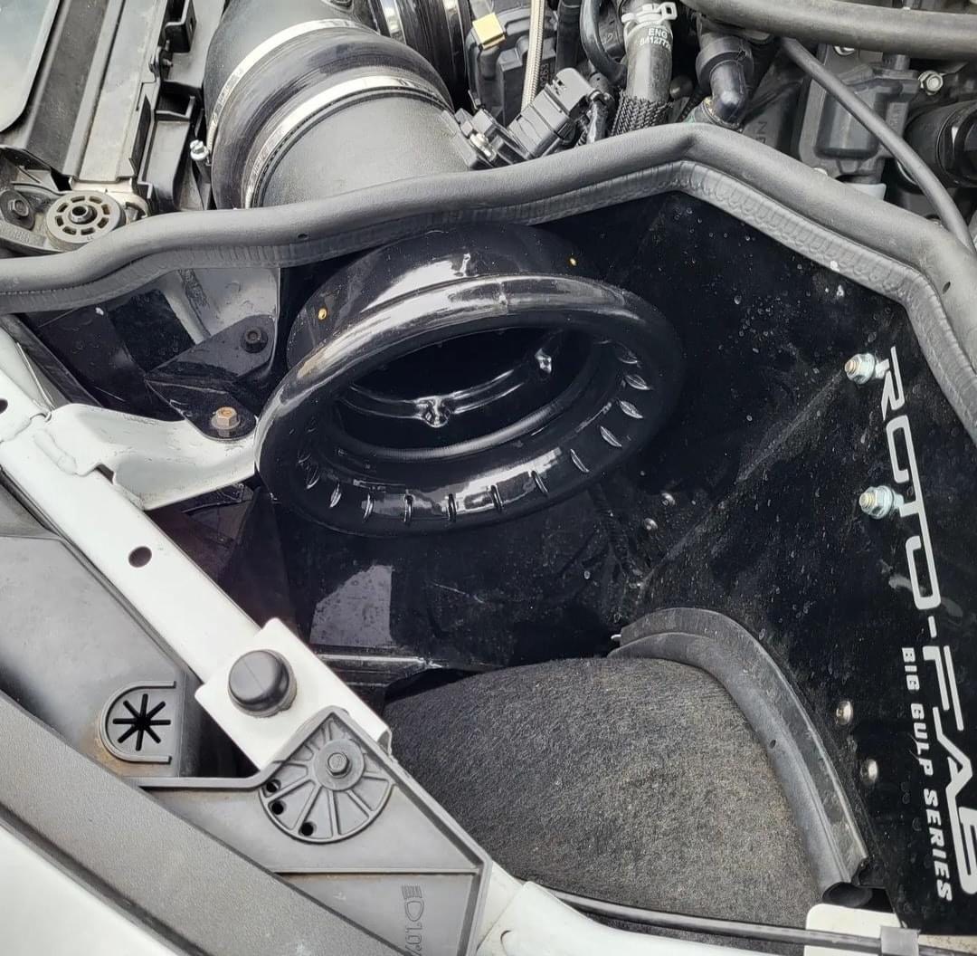

it's also fair to note that the velocity stack replaces the air filter. i mean, i'm all about performance, but that's where i draw the line on a street car haha. also i imagine it would require a dedicated tune to compensate for the maf signal. i don't see swapping the vc at the track on an otherwise stock/bolt on car going well at all.
Yes that was on his Zl1.

Yes you have to tune for the airflow change. You could tune for the Bellmouth and leave it as is even if you swap back to the filter. It's just going to run a tad rich in PE. Not enough to cost much power or hurt anything....especially NA setups.

* Filter not shown ?
