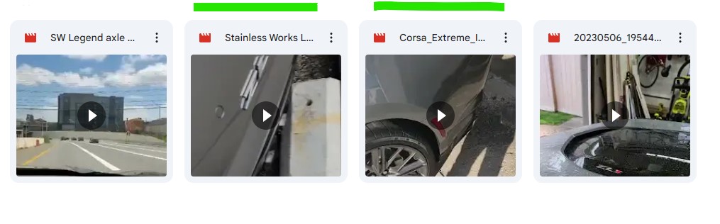

Update: Just as promised, FedEx delivered the new Stainless Works Axle back today around noon! I won't have a chance to install them until after this coming week. But, I plan on doing my best to record different audio from the Corsa Xtreme NPP and the new Stainless Works NPP. Now I just have to put the Corsa's on Facebook Market Place !
What axle back did you have on the car before this? How was the sound? I have MBRP axle back and I'm in the process of building a max effort NA 416. I know it's going to be very loud.
I had the Corsa Xtreme NPP. I didn't dislike them per se. I switched them out because I think with my 2" long tubes, it made the Corsa Xtreme sound a bit hollow/tin can'ish sounding and it was wow loud and much louder than the Stainless Works another Zl1 had that I heard at a car's and coffee meet up. Here is a link to my Google Drive, there are two clips for the Corsa Xtreme and the Stainless Works at idle. You should be able to hear a difference.
See photo below it will shows the two files for the comparison!
