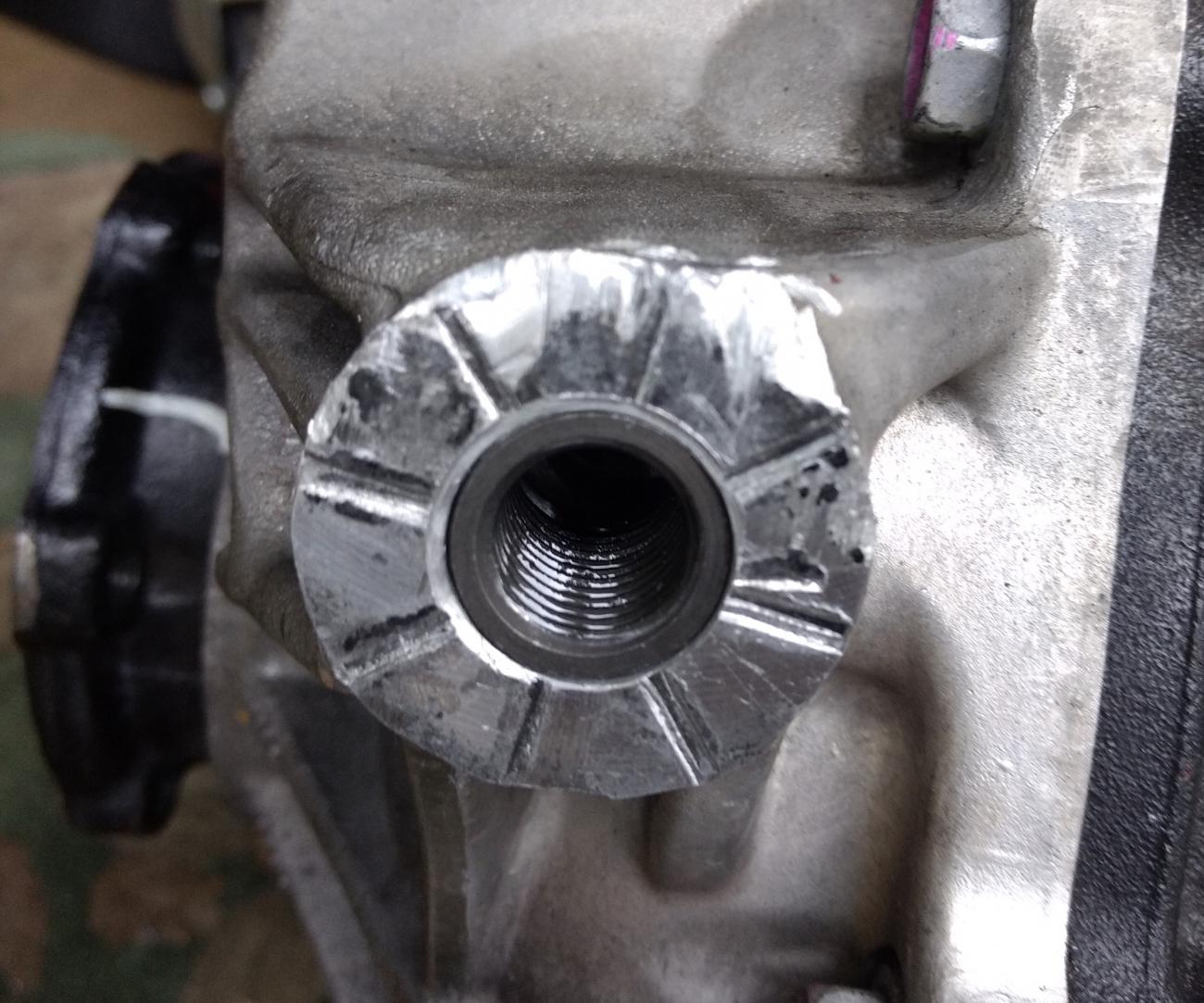

probably wondering why I removed the differential...the top bolt broke on track about 6 months ago and the track service "fixed" it. In the process, they stripped the aluminum housing on the top bolt so I am going to install a thread insert. No way to do this without dropping the entire center section. Pics are ugly. I knew something was wrong because there was a persistent clunk which was metal on metal and very aggravating.

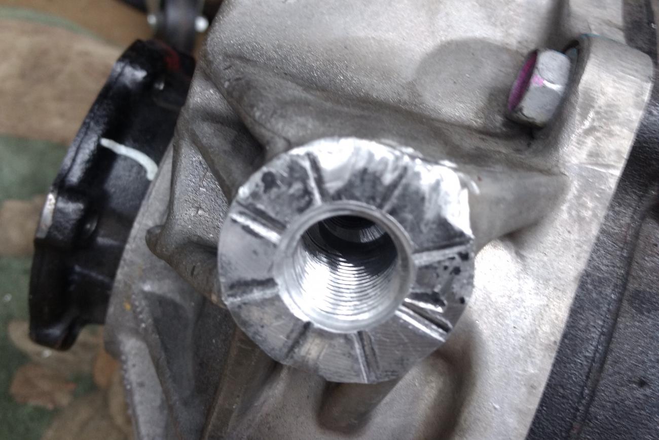

thread repair pics
