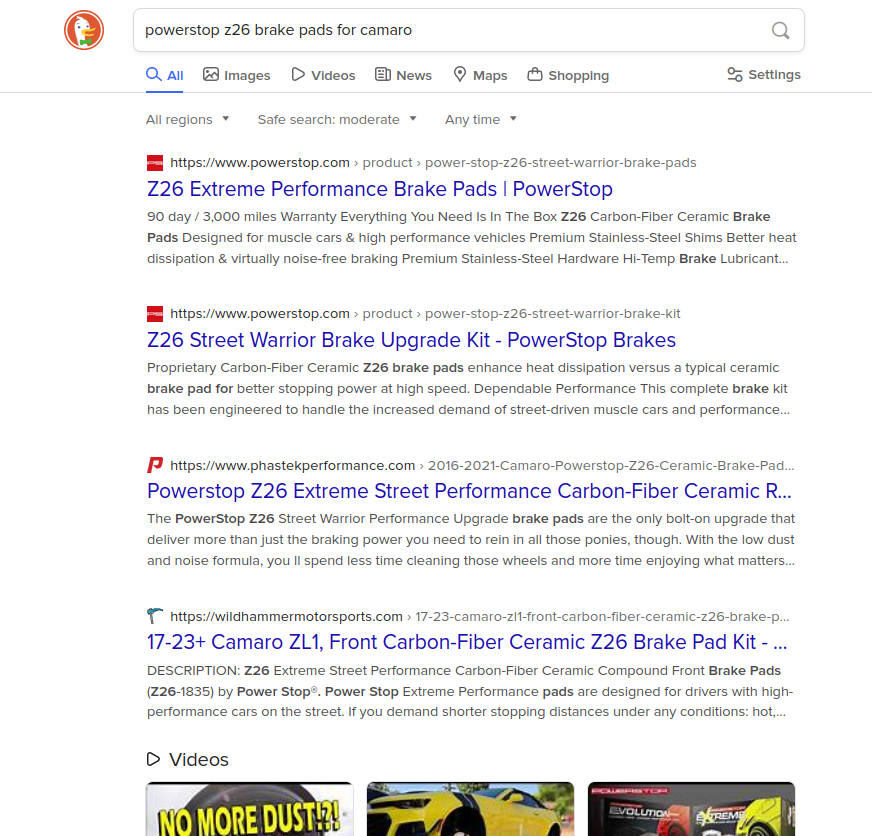

If you don't want brake dust and are willing to sacrifice some performance, look into PowerStop Z26 pads. Lots of mentions in the forums, and available on the cheap at many performance parts sites.
