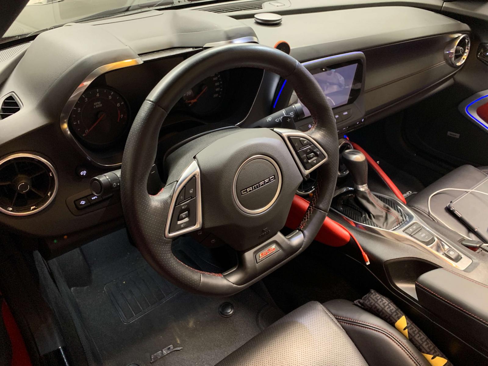

Originally Posted by hammdo View Post
Wish this fit the 5th gen but, very nice looking wheel...
-Don
This is the 5th Gen without the performance LED

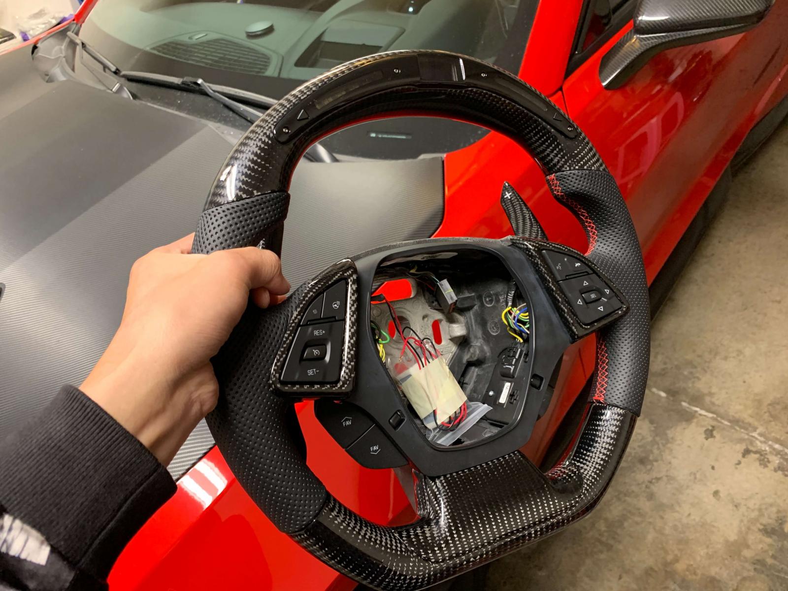

After 20+ days of waiting, I received this amazing Steering Wheel.
If anyone if anyone interesting to buying the Steering Wheel like this, please contact me. rockauto2018@gmail.com
Full customization options, including choice of paddleshifters, badging, colors and of course materials.
For the first 3 orders I can do $1199 with LED display if anyone interested.
20 day waiting + $200 deposit for the steering wheel.
I am working on the website now.
Video: Red Flashing Over 5000 RPM for Shifting.

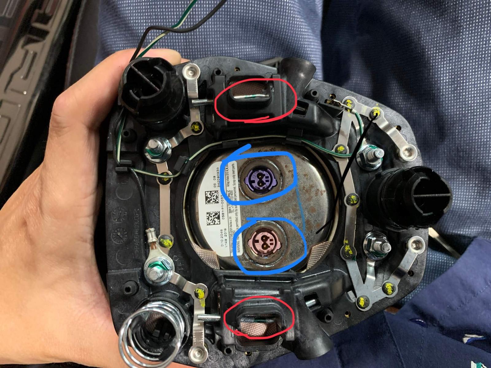

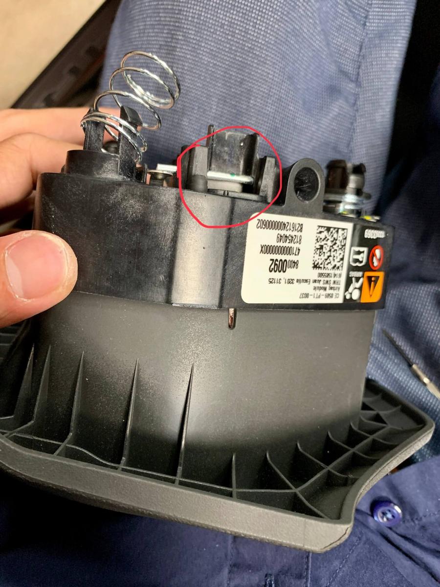

Install
The most hard part of the installation is to release the pin of the airbag unit.
They are one on each side (left and right), push in hard to release the metal pin.
Attachment 980939
Attachment 980942
Attachment 980951
The connector for horn.
Attachment 980940
lift two side clip to release the connectors for airbag.
Attachment 980941

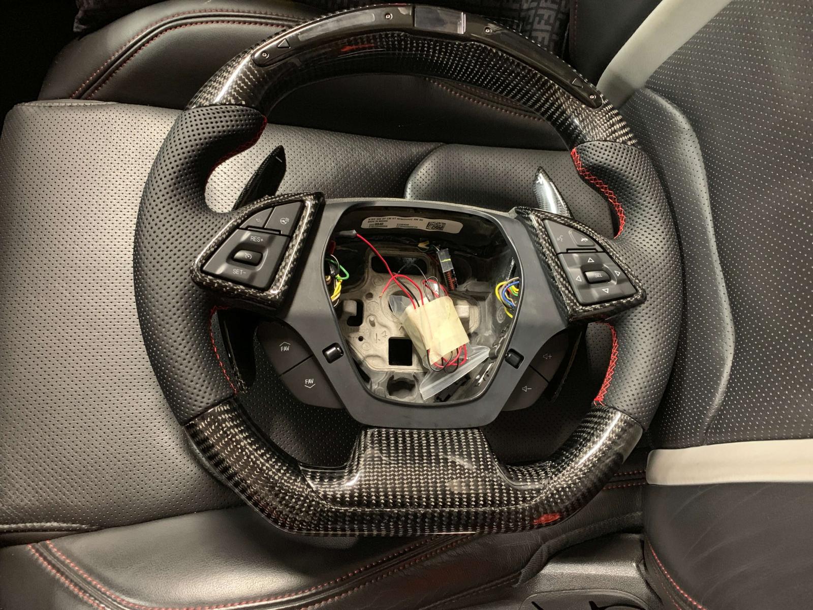

To remove the steering wheel, they are 5 connectors need to be disconnect.
Attachment 980943
For the performance LED you need to connect red and black wires come with the display to positive and negative 12V power, I use the center connector, Blue for negative, Brown for Positive.
And a bluetooth device come with steering wheel connect to your OBD port for sync data.
Attachment 980952
Are you splicing the red and black from the led to the wiring for a heated steering wheel?
