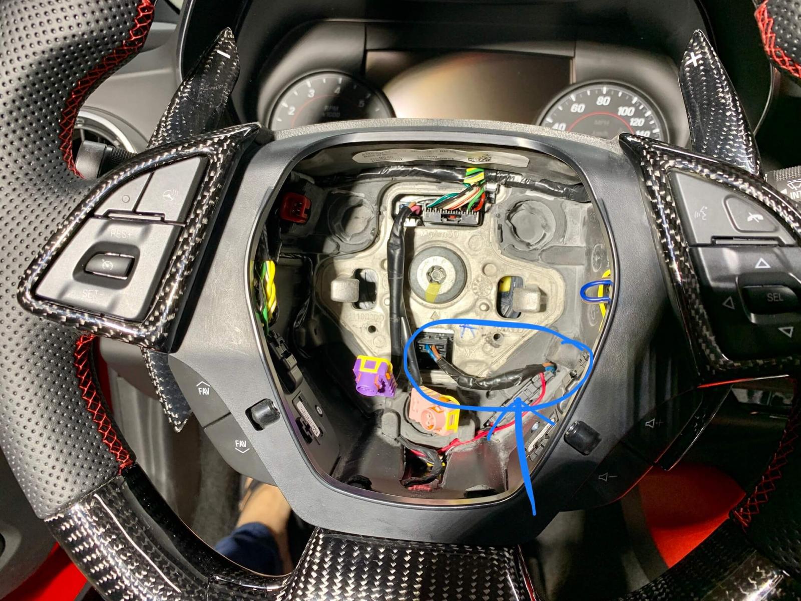

For the performance LED you need to connect red and black wires come with the display to positive and negative 12V power, I use the center connector, Blue for negative, Brown for Positive.
And a bluetooth device come with steering wheel connect to your OBD port for sync data.
