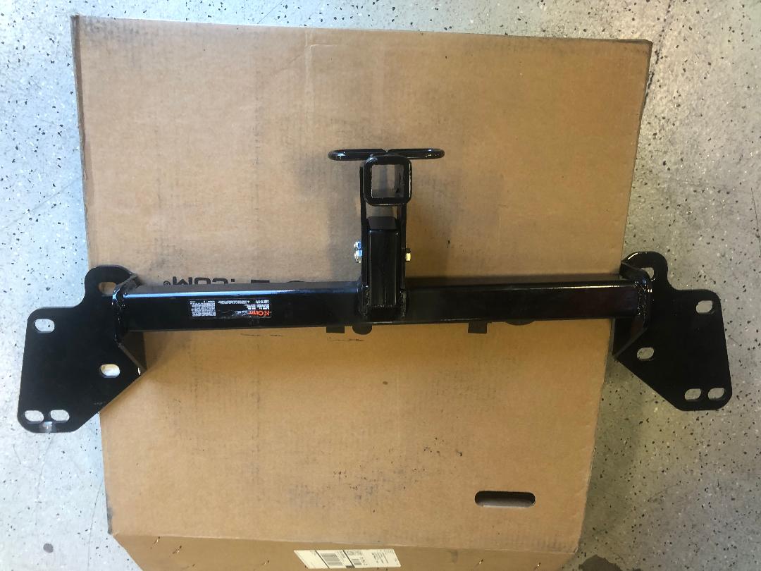

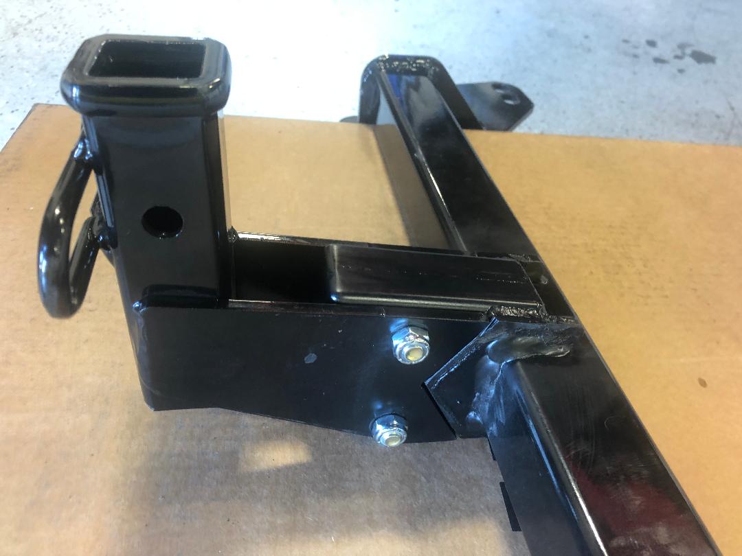

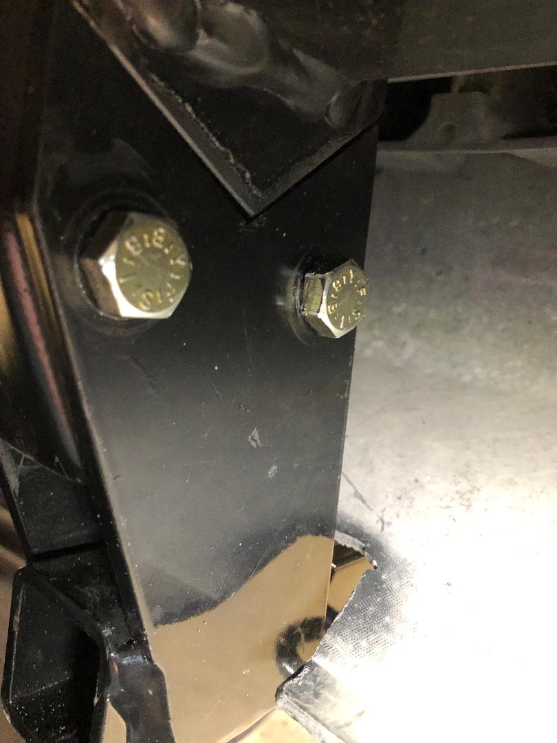

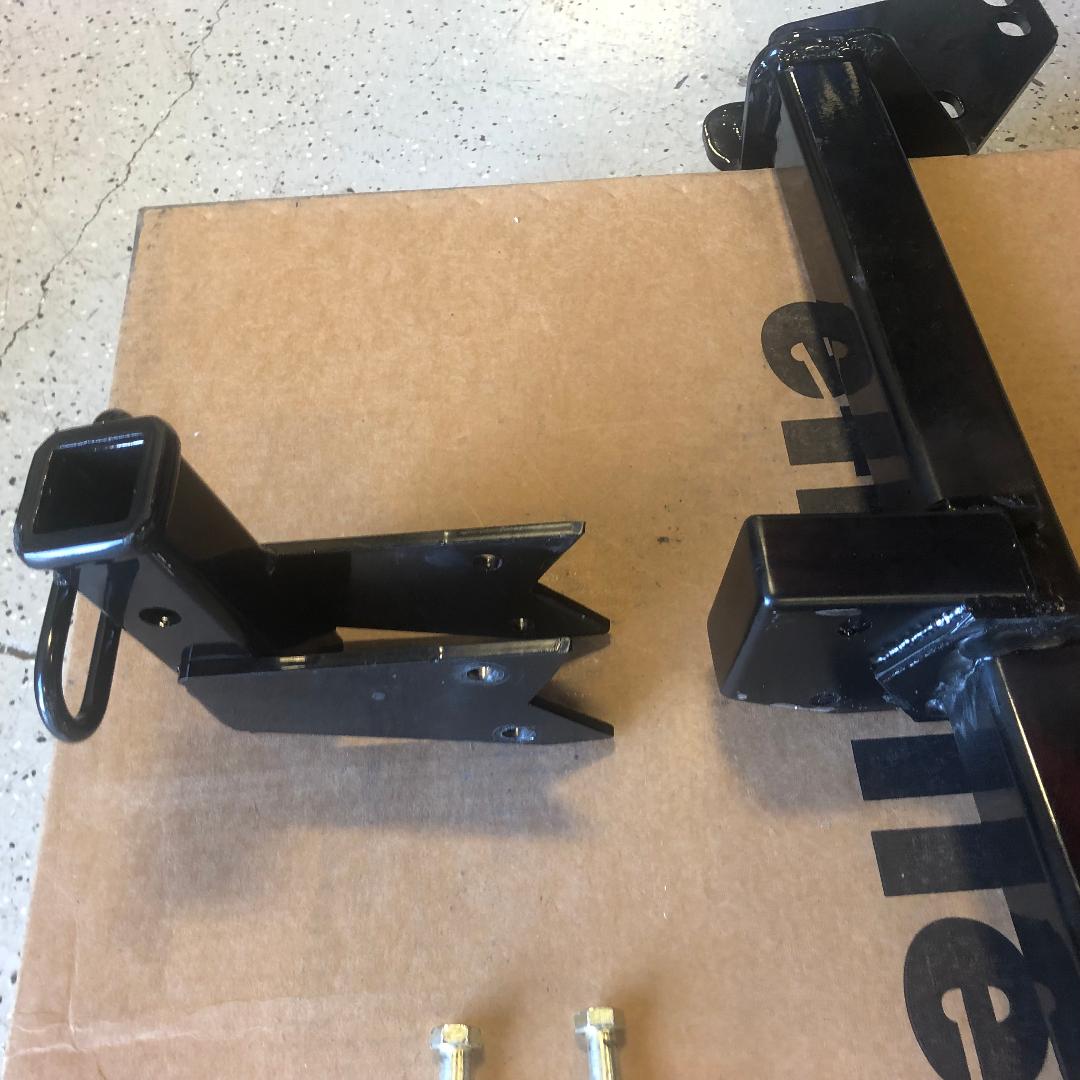

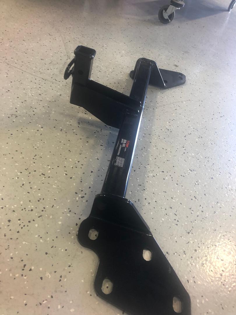

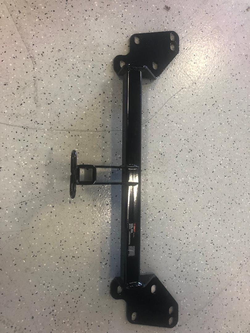

MODIFIED Curt Hitch NOW installed
The first TWO pics are of an UNMODIFIED Curt Hitch. All the other pics show a Curt Hitch I had MODIFIED so that when NOT in use, it will be hidden by unbolting TWO CLASS 8 bolts. the LAST Pic shows what it looks like underneath the car installed.
Modifications were done by a friend of mine who is a chassis fabricator for BRINKS RACECRAFT.
The hitch weighs a total of 25 pounds. The removable part weights 4 pounds and the part that is ALWAYS on the car is 21 pounds. I did the hitch install myself which wasnt too bad. It requires the removal of the back bumper and the aluminum bumper crash bar. In the old days these crash bars were anywhere from 30-50 pounds and made out of steel. This one only weighs 10.5 pounds. Dont even THINK though about NOT putting it back on.

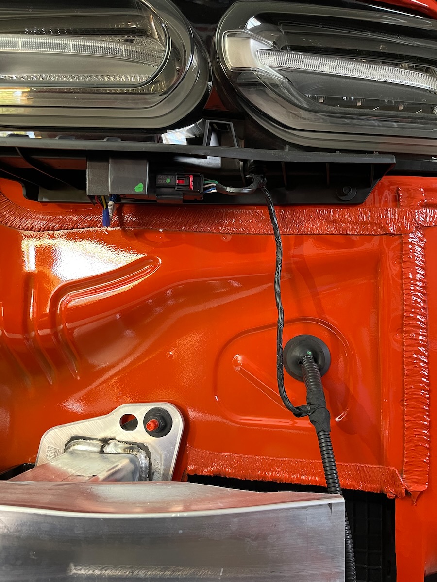

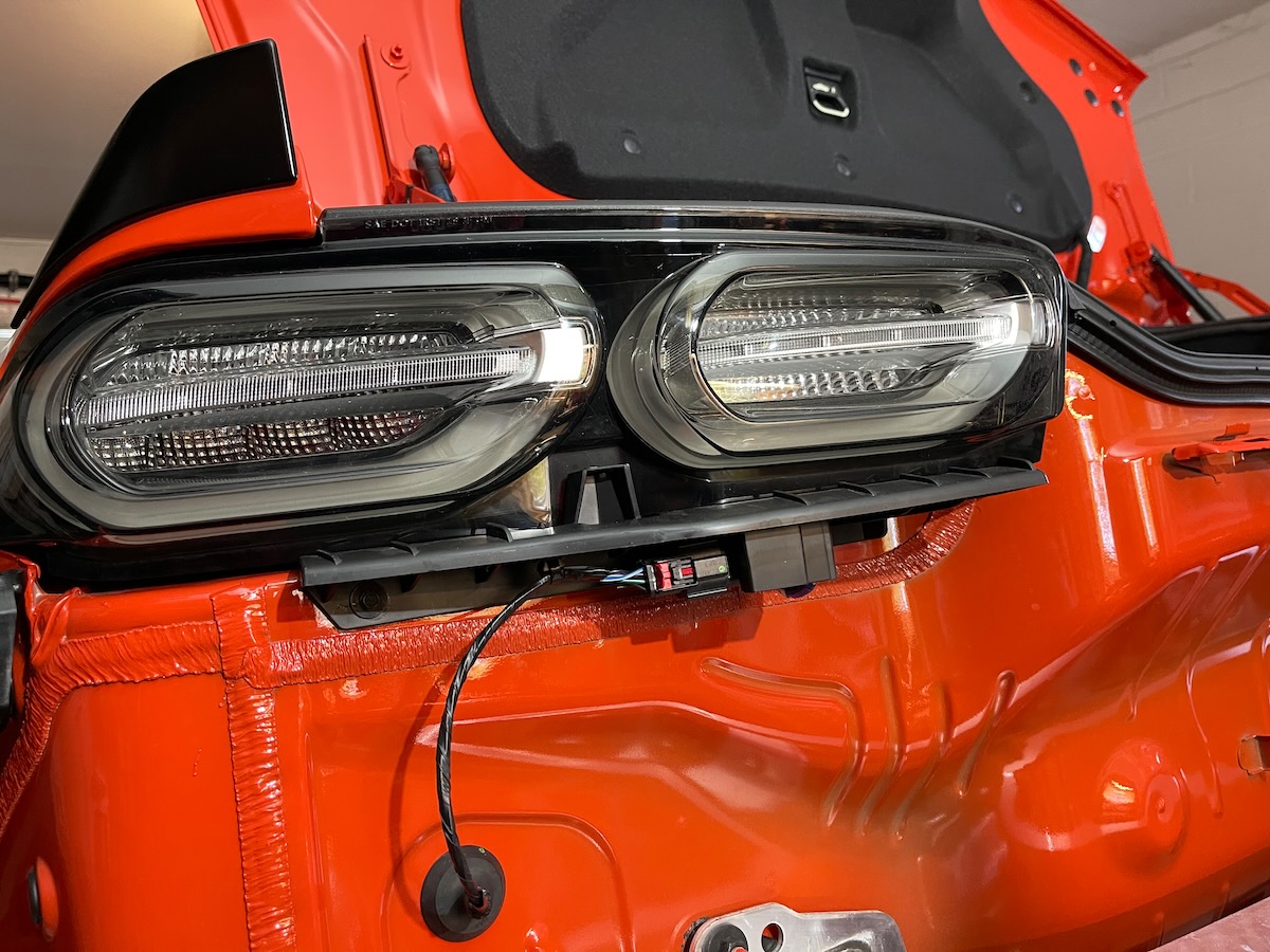

Just a FYI for those doing wiring. Curt makes a custom plug and play kit for our cars. Part #56318. It has male and female plugs for the tail light harness. No cutting, splicing or voltage sensors. I ordered one from Amazon to go with the Leroy Engineering hidden hitch that is on the way. I don;t like to cut factory wiring and I won't cut my rear bumper cover as well.

I don't think that will work with 2019+ Camaros without modding the Curt harness quite a bit.
The car's harnesses and where they connect to the tail light assemblies changed with the facelift. Before the facelift, the harness plugged in from behind in a cavity between the body and the tail light assembly.
Post-facelift, the harness plugs in below and at the rear of the assembly and requires rear bumper cover removal.
I think, but am not sure, the wiring & or pins changed as well.
Ok my guy just TODAY installed the 56318 Curt Harness and although it tested fine WITHOUT the trailer, it is NOT operating correctly particularly when turn signals are activated once it is hooked to my trailer. I have no doubt that he will figure it out and I will post back if he is successful.

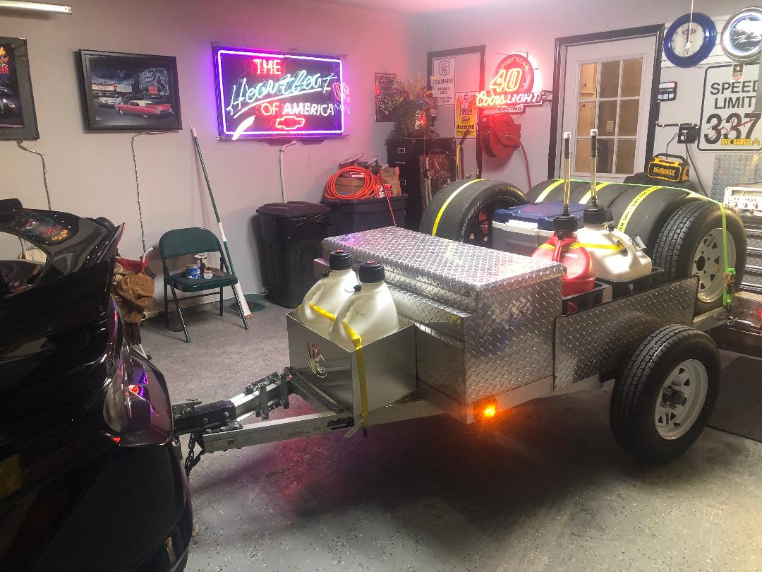

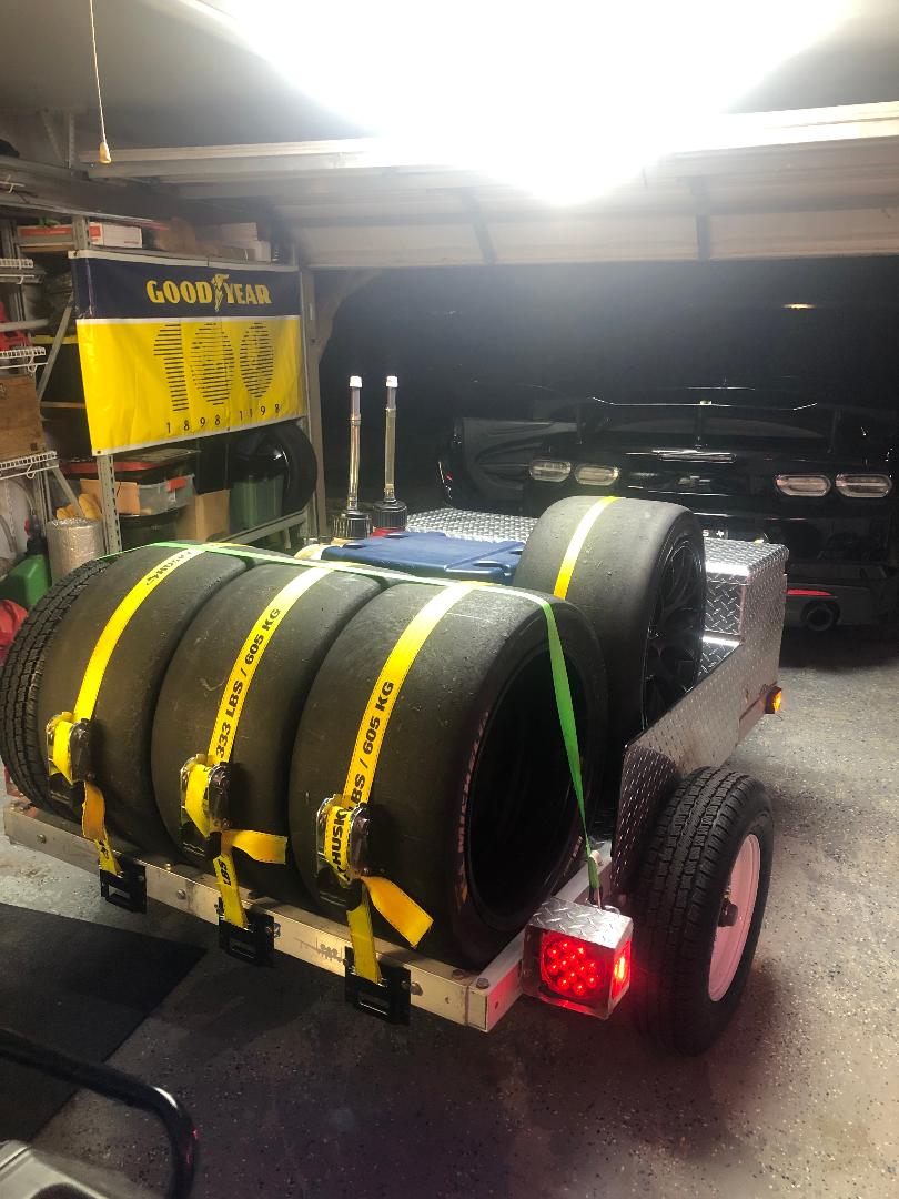

Trailer loaded up
OK these pics BELOW are my trailer loaded up and ready to go to the track on saturday 3/26 to Motorsports Ranch Cresson Tx MSRC.
On a side note, because the CURT hitch receiver is BELOW the bumper you will need to run at least a 4 inch RISER to bring the nose of the trailer UP. 5 inch RISER would even be a little better.
The trailer rode very well even at 80MPH without swaying. GAS mileage difference towing trailer (about 800 pounds loaded weight) was negligible. I replaced the 12 inch wheels with 13 inch hi performance tire/wheel setup from the ETRAILER boys.
About the only negative thing was this trailer is NOISY. Thats to be expected though from a bolt together trailer and it actually got a little quieter loaded because of the additional weight over the NOSE of the trailer.

UPDATES 56318 Curt Interface and Hitch
The 56318 Curt interface is NOW working properly with my trailer lights. MY installer just this morning had to install some resistors because my trailer has LED lights also.
