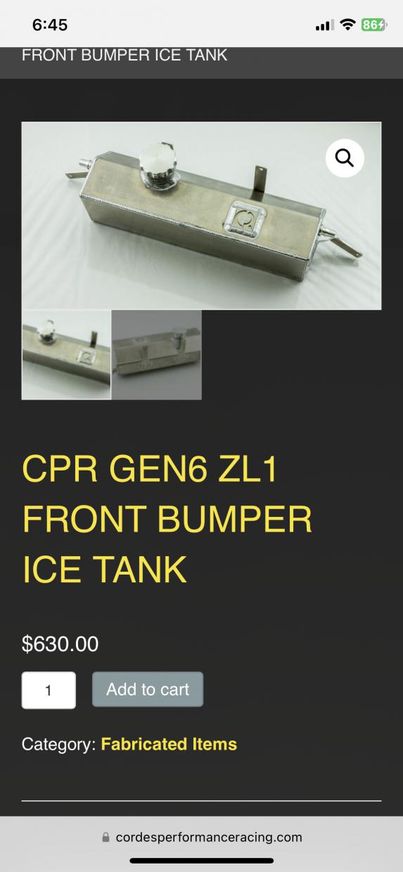

Tuner doesn’t like the heat at 821 RWHP on Pump 93 and plan is to go 860 on E30. The E will help temps.
So I picked up a F1 Interchiller today from a member here on the site. The chiller and Meth will keep the temps nice and cool, the question I have is do I need to get a larger tank for the SC coolant or will the chiller be enough with current stock small tank? I was planning on to get the CPR GEN6 ZL1
FRONT BUMPER ICE Tank. Is it over kill or should get a larger tank with the addition of the chiller. I will have no need to put ice in the larger tank I want it for location that I am able to put it in and the larger amount of fluid that circulates that helps in cooling as well.

I’d suggest at least 2 gallons of system volume. This will buy you the ability to run a 1/4 mile without a big spike in intercooler water temps.
I’ve got a 2 gallon aluminum front bumper tank available if you’re interested. Price will be right and a lot cheaper than the Cordes one.
