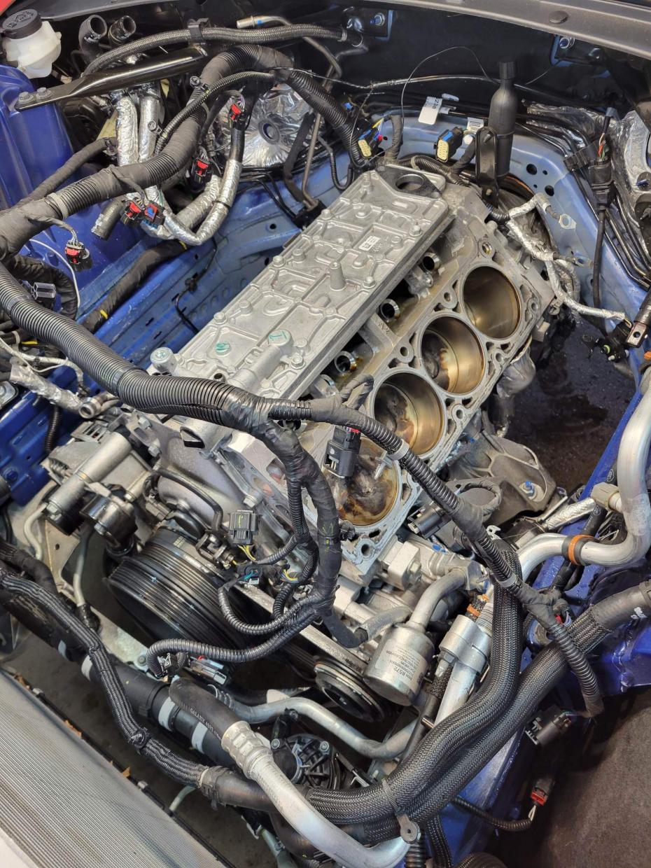

My 19’ ZL1 A10 went under the knife today. Since I already have a 2650 on my C7Z I wanted to see how my ZL1 would run with the factory little guy. Build is as follows:
-Kong Regular Port w/2.30 upper
-LMP Blower Lid
-FRE Stage 2 Heads Rebuilt by LME
-.028 Head Gaskets “10.6:1” Compression
-BTR Stage 1 Cam +38% Fuel Lobe
-DSX Flex Fuel Kit
-XDI +65 Injectors
-LPE Big Bore HPFP
-JMS Voltage Booster
-DSX Aux Low Side
-C.H.E Trunnion Kit
-ATI Balancer w/9.25 lower
-Katech 103mm TB
-Roto Fab Big Gulp
-LMP Heat Exchanger
-Katech 174 T-Stat
-TSP 2” Headers
Guesses on power? I’m going to say 840whp on the MD-500 Mustang it will be dyno’d with.

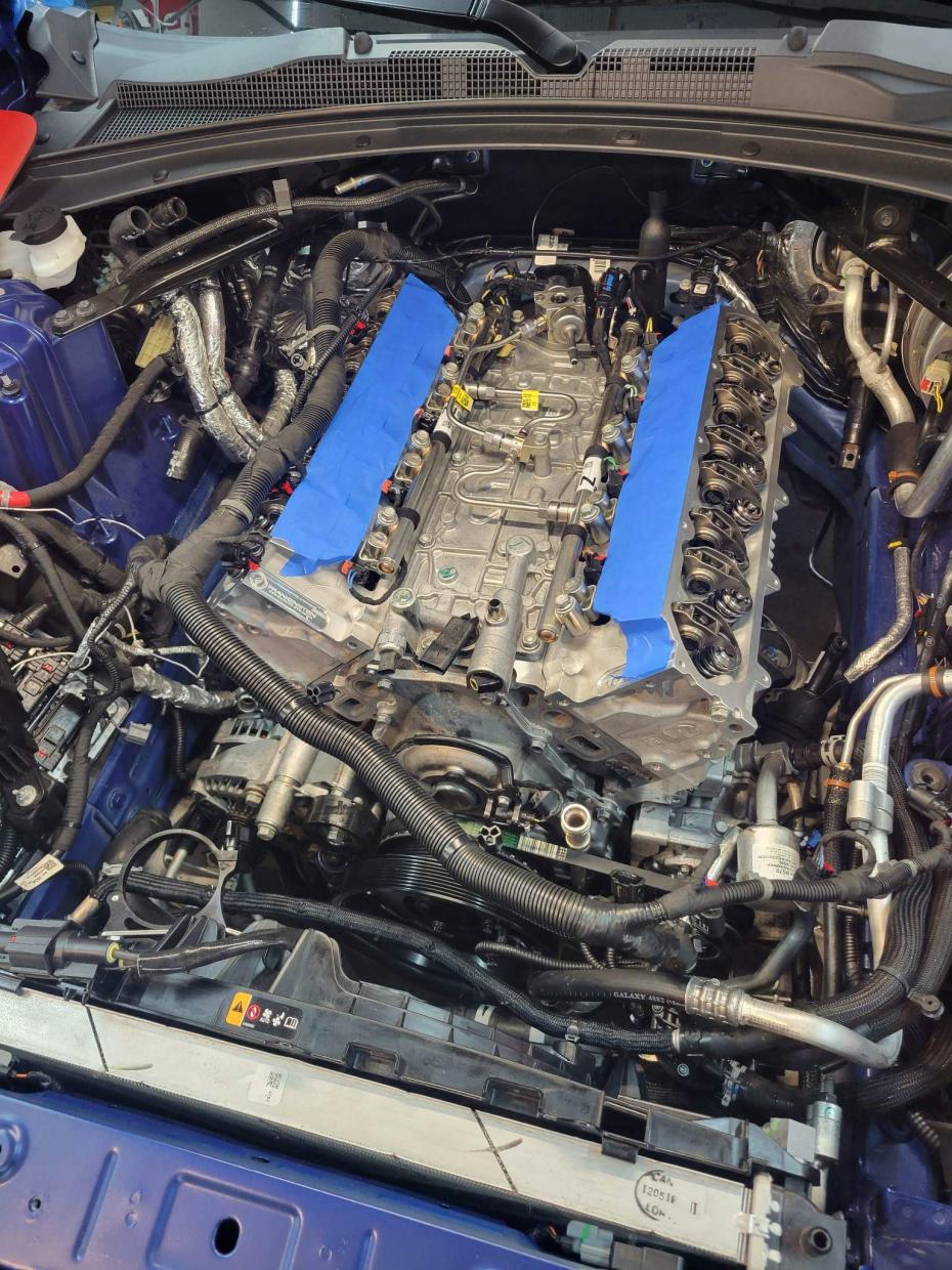

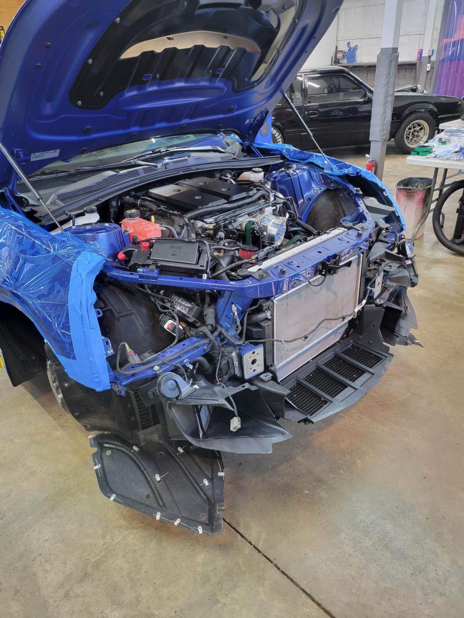

It won’t be long. This shop doesn’t mess around with getting things done. He started this morning and got to where these pictures are.

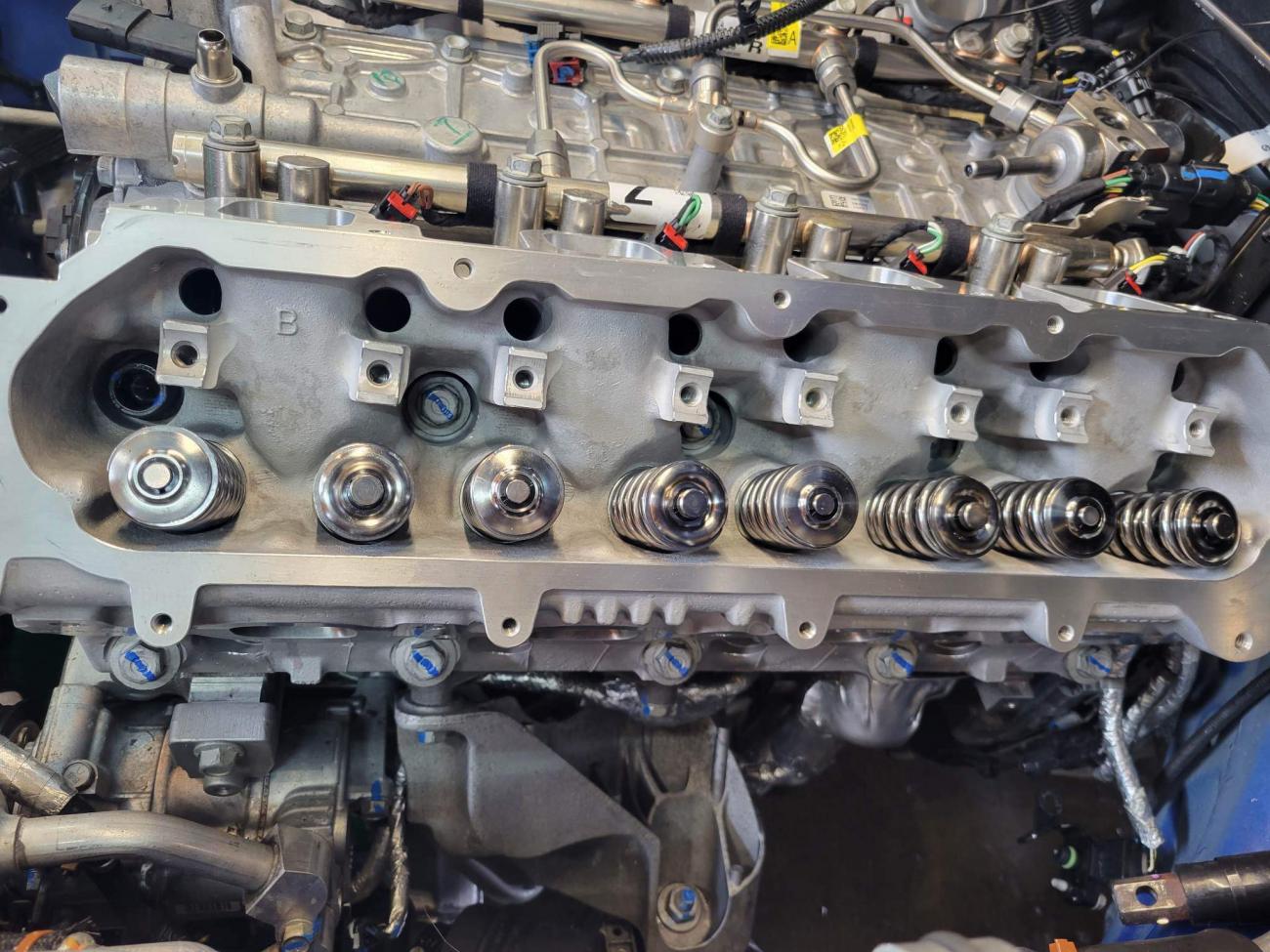

Cam is in, heads are on. Plenty of PTV clearance. Was at .035 with no gasket. With the .028 puts me at .063.

Make sure you move and protect the harness.
