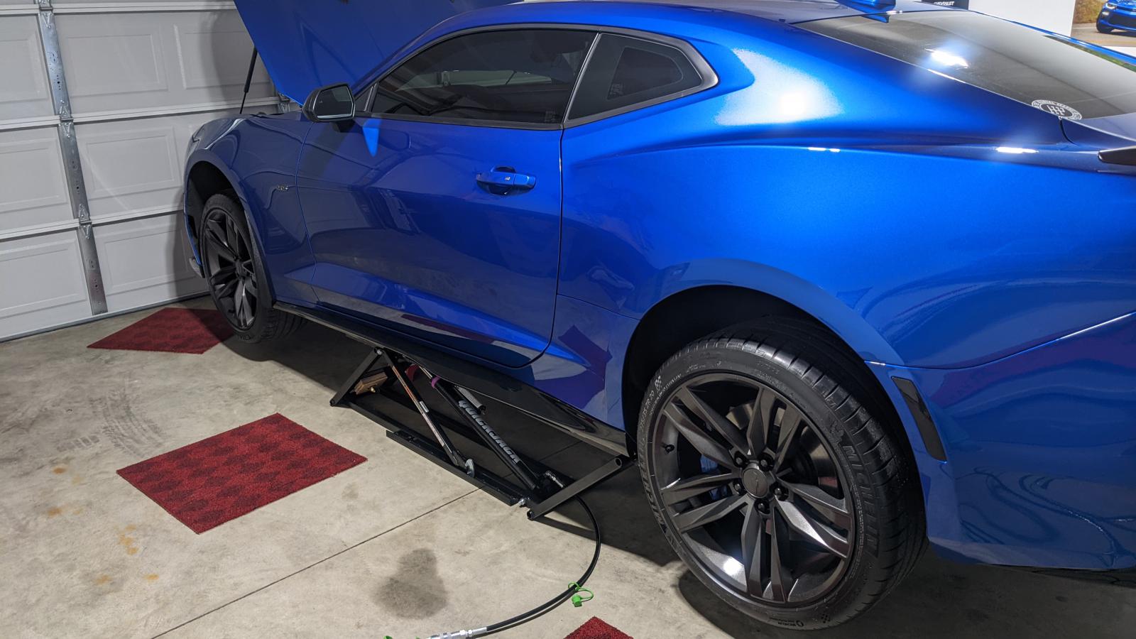

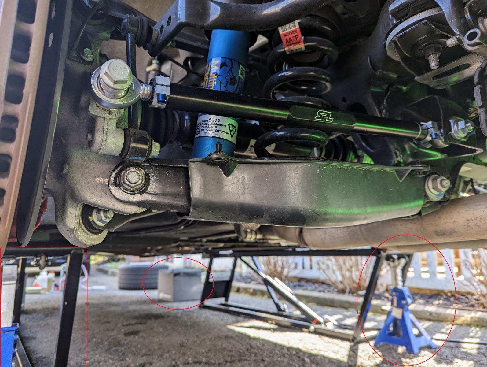

I use race ramps wheel cribs too (more useful when the wheels are still on the car!), but I also toss a couple of jack stands under the quickjack itself for additional peace of mind.

If the QJ failed, it would fall onto the jack stands. That's why I positioned them there.

You would lower QJ down to wheel cribs.

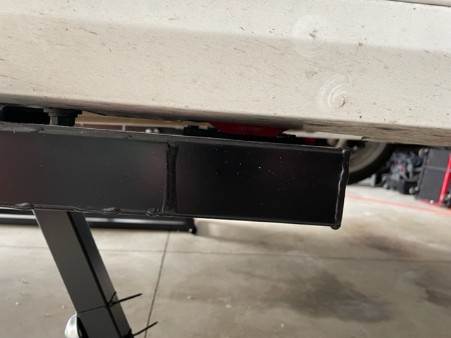

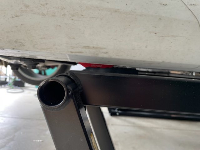

Yes, and the max spread between lift points on the TL is 60". The max spread on the TLX is 66". On the ZLE (and I assume all 6th gen Camaros) my lift pads are greater than 60" apart. There is only one spot for the rear lift pads; there are two spots for the front lift pads. Even with my front lift pads in the rearmost of the two options, the spread is greater than 60". I can't see how a non-extended reach QJ can work unless lifted incorrectly.
Originally Posted by johnd5412 View Post
7000TL works on both my 2020 camaro 2ss and 2014 Ram 1500.
Would you mind taking pics of the locations you're lifting from on your '20 2SS? Same question to anyone else using an SLX or TL QJ model on our cars.

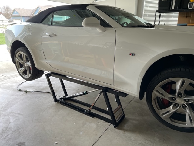

Here is the 7000 TL and my 2020 2SS.

5000 TL on my 18 2 SS. ZL1 add on lift pads also utilized.
Had my 5000TL for over a year now. Had the 2SS up half dozen times. 2 closest jacking points are indeed 60" or less.
