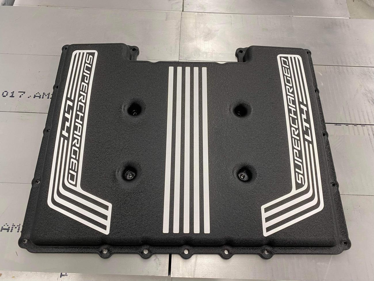

I have a 12 GPM pump on the ZL1 and ZO6. 2650 on the C7Z runs 120-140 in 60 and below outside temps and 140-150 in the summer. During pulls MAT drop 1-2 degrees or rise 1-2 feeling on air conditions. It stays cool until it’s driven through the city then heats up. Temps steadily drop on the highway and will drop to around 130 even in the summer. Many cooling mods. With that, I got a new lid for the 2650 from DSX Tuning. Supposed to really bring out the blower whine. Only weighs like 7 pounds. I had Dave laser engrave the factory ZL1 blower lid design. Pretty happy with how it turned out. Putting it on tomorrow.

I’m thinking the lid may shed heat faster since it’s a lot thinner and not thick cast aluminum. Definitely a sound mod more than anything.

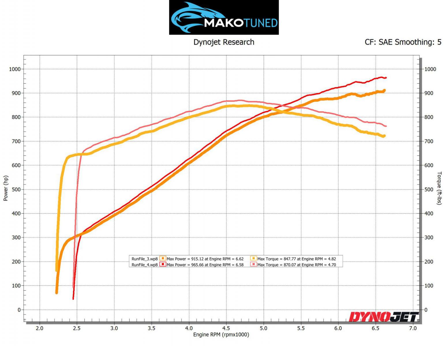

I'm posting the dyno sheets, using the larger 3" upper and everything else is the same, two hp curves and two tq curves [he could improve his color choices here], the higher numbers were with ice in the tank.
I'll do the same with my current 2.75" upper build after I figure out how to increase gpm thru the intercooler.
The main point is, I can't carry ice around so I have to cool things down a bit.

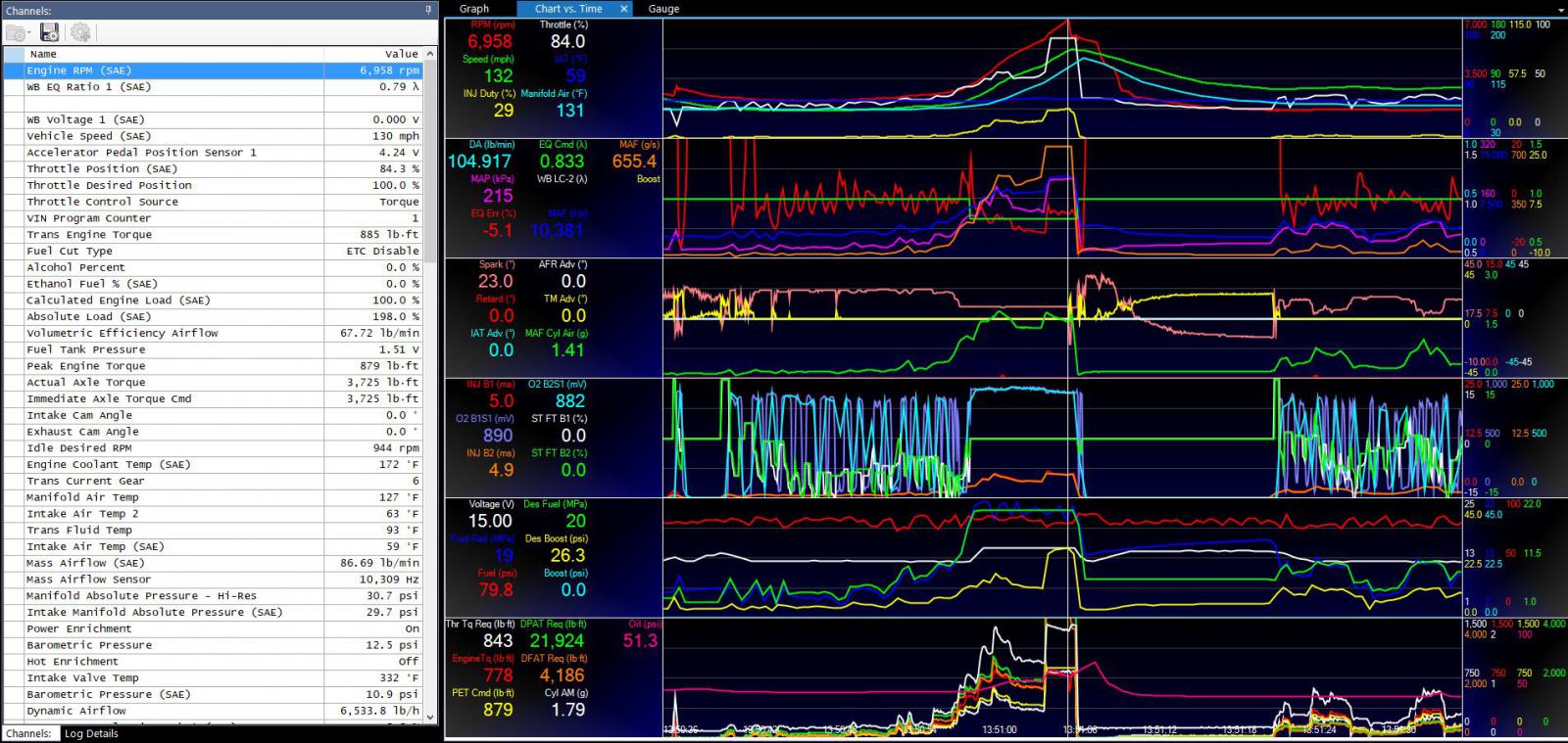

Here's today's log, w/ice
Cruised at 72F and MAT got to 131F at the shift. Shouldn't be so high. Going to install larger water lines.
Looks like it made 21# boost and would gain around 3# at sea level, and would likely be even hotter
