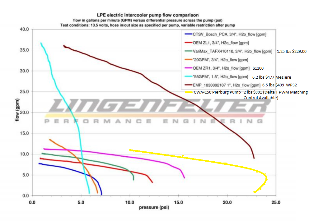

The question is 40 GPM but at what differential pressure? As restriction grows all pumps move less GPM. Here’s a chart that’s pretty helpful showing all the popular intercooler pumps out there.
If I'm reading this correctly, EMP is the choice.

LPE says EMP is on one year back order, so maybe CWA (
) or Meizzere next

I found a CWA 400, which has 1.5" discharge/return versus my current 1", so I would have to alter my tank or buy a new one

I bought a CWA-150 and it’s sitting in my garage. That’s definitely going in this winter. The Varimax isn’t cutting it IMO.
