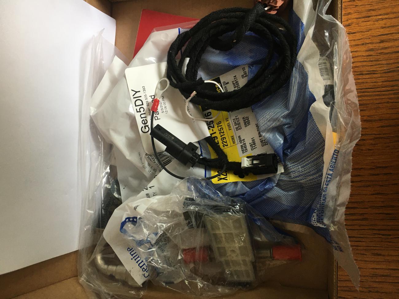

Flex fuel is installed. Very easy. Noticed once the fuel hoses are connected to the sensor, my tool doesn’t fit in there to unsnap the tabs.
Waiting on wg spring from Amazon to fire it up.
If you're talking about the little plastic tool to disconnect the fuel lines, I had the same issue. Trimmed the plastic down that slides inside and pushes the tabs out. Maybe 1/4" or so and got it to slide in there with some force

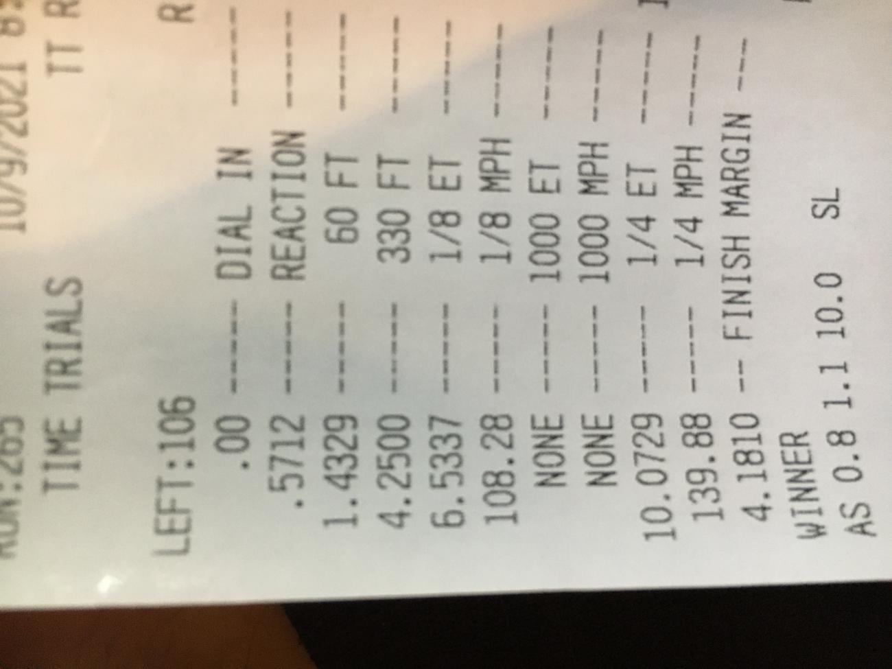

Long time...
Upgrading the LT1 in-tank pump to the LT4 is def noticeable in the logs. The low side stays above 75psi (including the dsx).
Cars been back together and running pretty good. The weather has sucked and the local car scene sucks this year so the car has been on the back burner.
Stupid CEL for the fuel is still on and wont pass inspection. It clears for small periods of time but comes back. I would have to time it with the inspection place to get the sticker. Its the end of the season so I'm not going to bother.

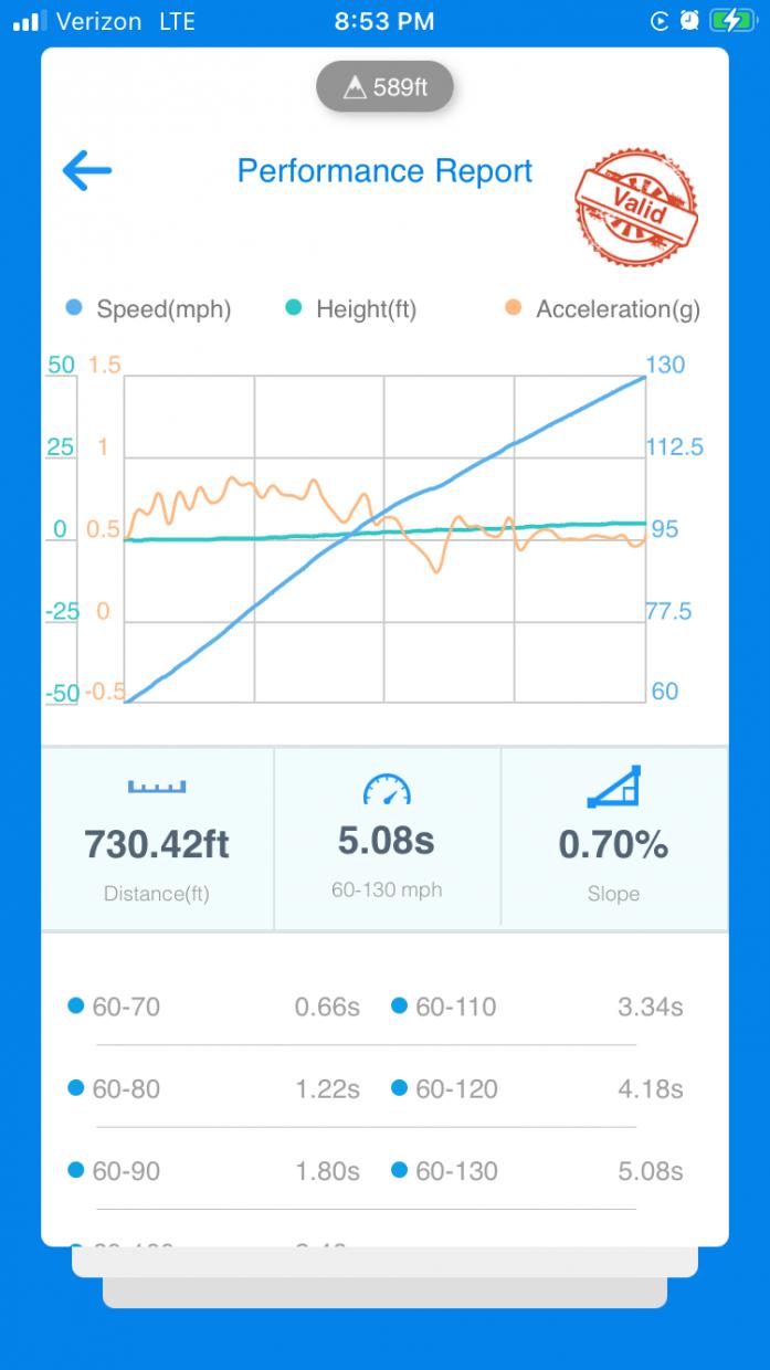

I made it to the track the last day it was open. Transbrake works like a mother fer. I hit so hard the lap top flipped over in my passenger seat and closed the log LOL. I left at 3200 rpm and 2 psi of boost to get a 1.4 sixty foot. It pulled hard 1st and 2nd then hit some limiter (torque?) and it cut the throttle to 44% a few times in 3rd, 4th and 5th. Ended with a 10.0 in the 130s. No log, no 9 and the track closed. damn
I plugged the dragy in last night to see what it'll do. Last year it went 5.3 60-130 with a passenger at 18psi. I got one decent run in and went 5.0 60-130. It spun the tires at 80mph so it might be possible to click off a 4 if I can get back out there.
I wired up my boost controller to my motion race works buttons. I have it set to change between presets but might switch it to "scramble" when the button is held down. I havent played with the sensitivity or gain. Hoping there is room for improvement there. The whole reason I went to this EBC was with a goal of keeping the boost +/- 1 psi of target across all rpm.
