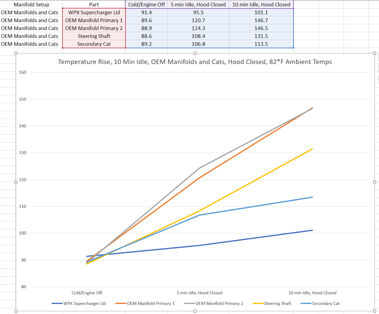

As promised. Temperature rise data for several parts using a Klein Tools Infrared Temperature Scanner in Avg mode (two red dots to measure and averages between them).
82 Degrees Farenheit Ambient Temps, Hood down during idling until measurement, cold vs 5 min idle temps vs 10 min idle temps.
More to come once he runs the same tests with 2" longtubes and Jet Hot 1300 coating. He will be replicating the same measurements. Note, he measured the secondary cat as its in the position where the GESI cats for the longtubes will be.

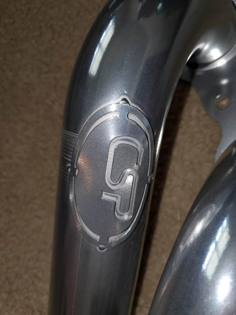

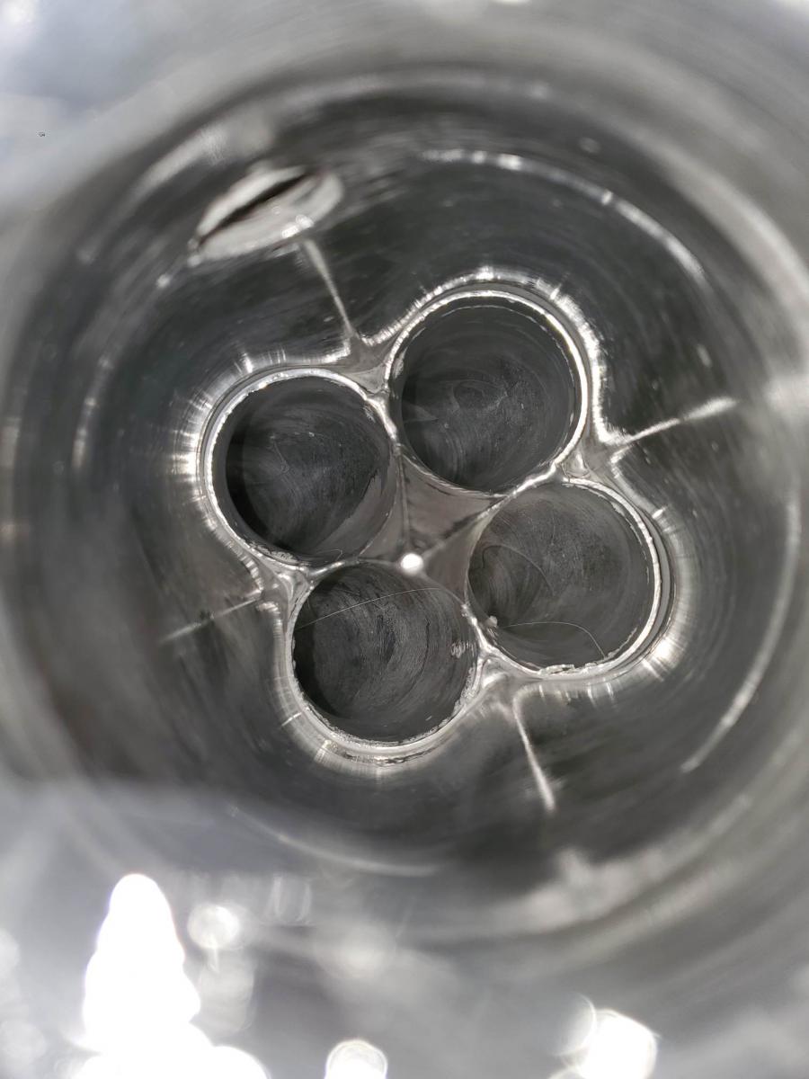

Buddy's Jet Hotted CSP 2" longtubes came in.
