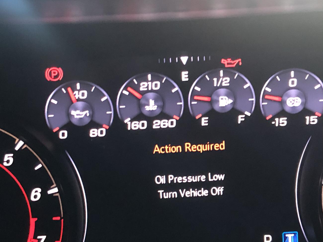

Same here. I use a Banks Data Monster and I have it setup to alarm if my oil pressure ever goes below 27psi. I'm at nearly 26K miles now and it has always hot idled with 28-30 psi. That low oil pressure alarm is the first thing I setup because if I ever see it lit up I'll know something has changed immediately.
Many owners may not be aware that you can set oil pressure thresholds vs rpm in the calibration so this can act as an early warning in those circumstances that the pump failure is slowly dropping oil pressure. Those of you who are already “tuned” can take advantage of this compared to those that don’t wish to “tune” their cars.
I have tested this and it works. Pic below is the table calibrated to bring on the warning at oil pressures below 50psi at 512-1024 rpm. This was done as a test. Second pic is it working, oil pressure is at 32psi however due to the minimum warning set to 50psi at idle rpm the warning chime/display comes up.
You can re-calibrate these rpm thresholds higher than the OEM settings to give earlier warning of possible oil pump failure.
