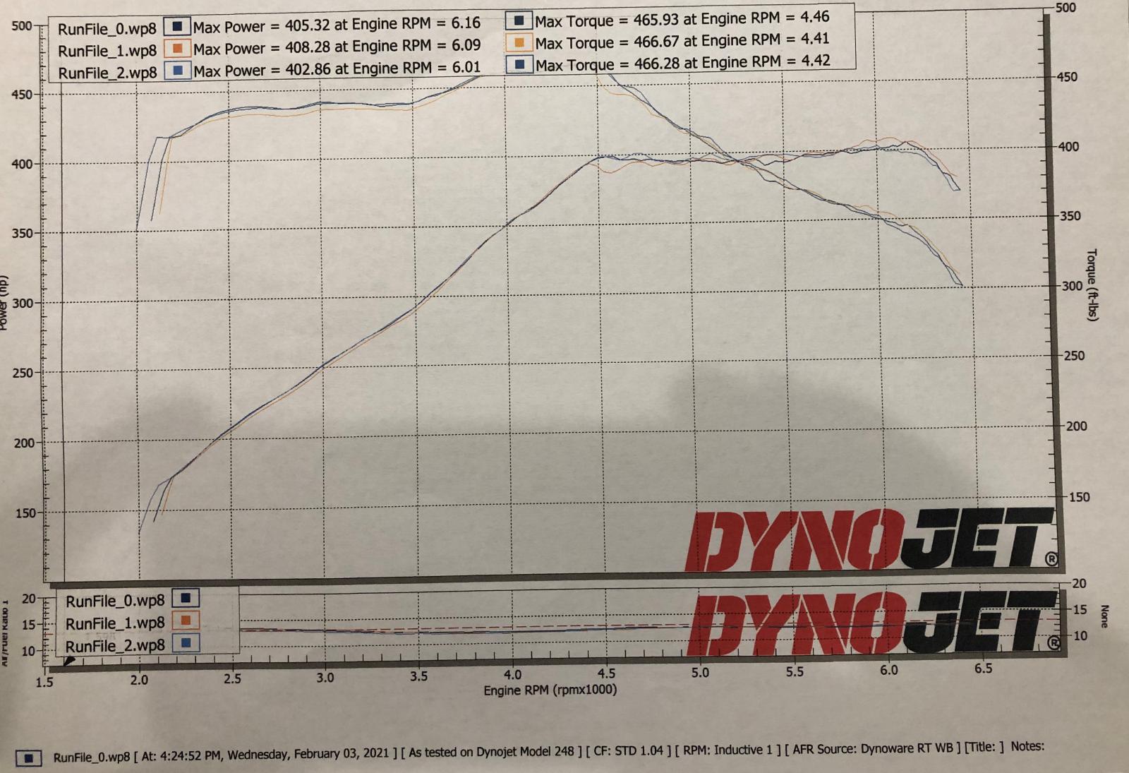

Hi guys,
Dyno sheet attached doesn't show baseline, which looked typical and normal to others I've seen here.
The short is, I decided to have some dyno pulls to see the difference from stock to the current mods. Before I start the next round of mods. Just curiosity...
Same place, same dyno as stock baseline (but not same day - several months apart). Very different looking plot. Seems like it just flat lined after 4500. I regret that I wasn't thinking, and didn't have my computer or mpvi2 with me... so no log. First two pulls in sport, last in track.
I have a remote tune that pulls like crazy on the street. So, I don't think anything is wrong with the tune or performance. ?
Maybe the TB partially closed at that ~4500, but why? If operator didn't turn off TC or stabilitrac, could this result when car isn't actually moving?
Wondering if anyone every seen anything like this?

Need to datalog it and see if timing is being retarded and/or throttle closure. Torque management and Virtual Torque tables should be checked.

Definitely datalog your dyno and drag runs. I learn something every time (after KingLT1 schools me lol). That will give you an idea if Torque Management, spark knock, etc are pulling your power back on you.
