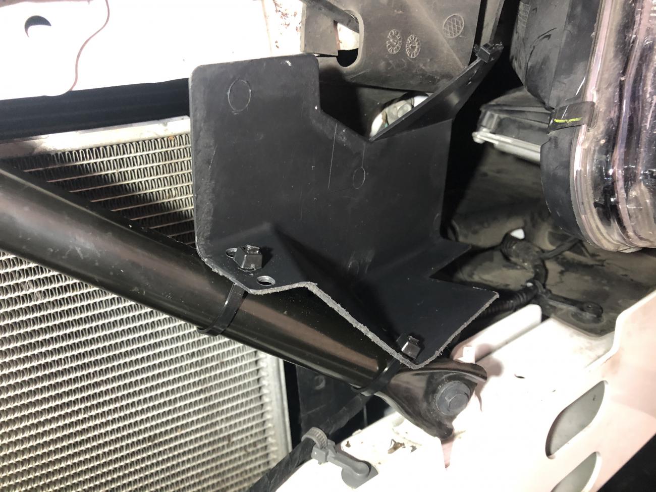

Had the front clip off for a new grill and decided to make my own air director.
