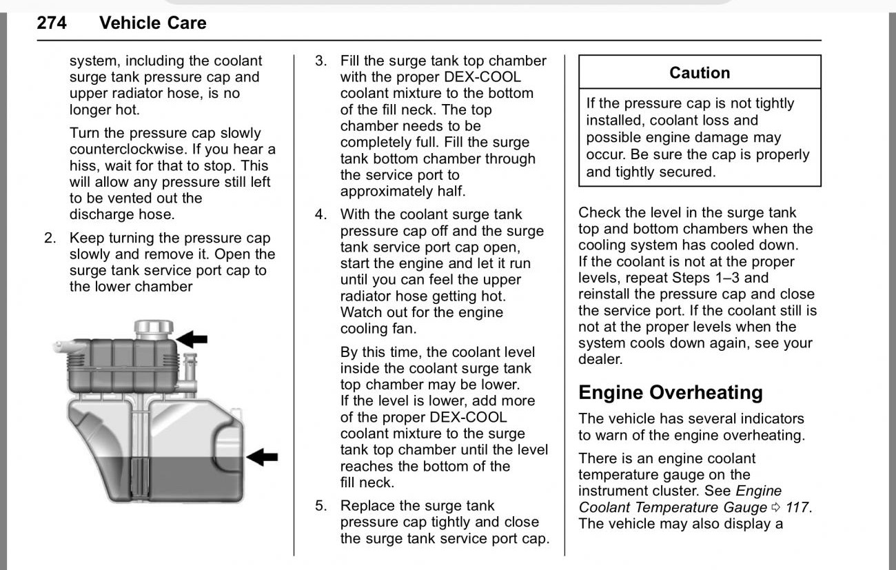

Not sure, but realize there is the top reservoir and the little pop off cap to fill the one below that only gets filled halfway.

Make sure you read your owners manual about this very carefully. The process is different depending if the top tank has some fluid or if its completely empty.
