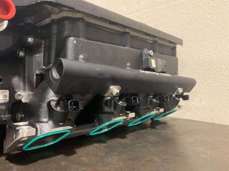

Man, shame having to ditch stock DI. I wonder how the replacement fueling works? Is it fuel inj. nozzles ports into custom manifold?
The pic I have I think is Edelbrock 2650 with Katech supplemental ported bolted on. Like less $ version of the 2019 LT5 ported supplemental fuel in addition to DI, like the 2019 ZR1?

Ditching DI is a huge improvement, it's there for emissions, not power. Port injection works exactly like it does on the LS stuff, if you watch the video you'll see the injectors in the Procharger intake manifold.
OK I will watch video all the way, thanks for info. Very nice work, good job. Are the stock DI ports closed/plugged off? Thanks.
Yes, we had a billet plug machined that is the same shape of the injector to plug them off.
Some people tried to use stock injectors with no fuel coming through them and they ended up acting like a glow plug, so the billet plugs are a must.

Interesting differences in the LS than LT1. I like my LT1, I thought I liked the DI and maybe supplemental, but looking at that pic, I'd like to make mine like that. Ported Fuel, manifold looks more expensive, but this is maybe a cheaper build than adding a PD 2650. I like the Procharger intake & red valve covers look great like the new LT2.

After watching video, like idea of ported fuel intake, but that is a big change, but it makes sense for a custom build. Thanks for sharing.
