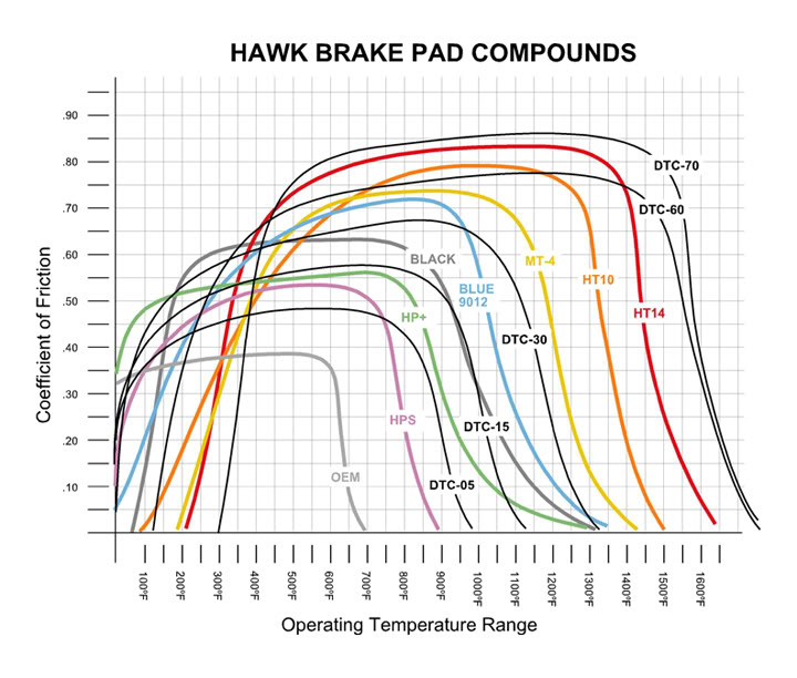

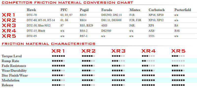

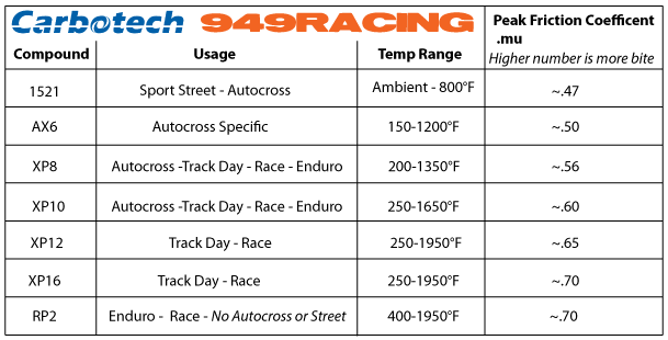

So Willwood EXP is definitely an upgrade from the two high temp Motul brake fluids?
Yeah these Hawk DCT 70 pads are very high toque, the semi-pro driver who drove my car said it brakes like a race car with "demon brakes". One of the areas I seem to be able to catch up on other cars is deeper later braking, I don't really want to lose much if any of that, Hawk claims those pads have .8mu friction up to 1400F while the Ferodo 1.11 are close to but under .5mu, I wouldn't mind something in between perhaps
Carbotech claims their XP12 are.65mu
Cobalt says their XR2 friction level is something like the DCT60 and Ferodo DS1.11 however those two pads have very different friction levels according to their manufacturers at least.

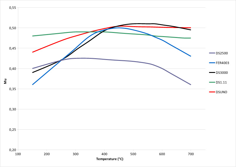

Name:  carbo compound_guide_2011.gif

1.11 are Ferodos top longevity RACE pad. Also, dont look at cross mu comparions between manufacturers.
C7R GM Racing used Pagid Blue and that's about 0.5.
You dont need an uber high torque pad to gain pace under braking. All you need to do is continue to brake deeper while progressively releasing the pressure as you turn in. Trust me it works surprisingly well even with stock pads. From your vids your braking has gone to a new level for sure (and you have been rewarded for it handsomely), but you still have tons of opportunities there.
