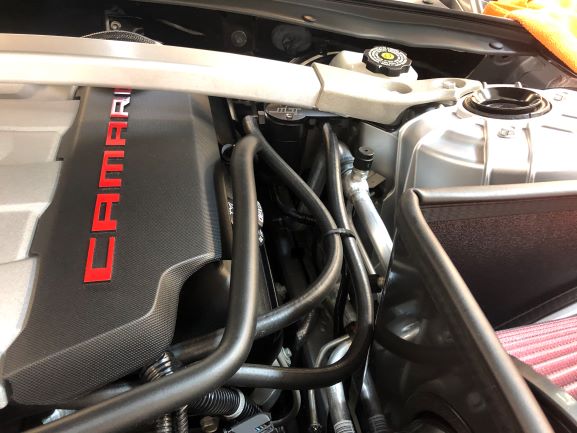

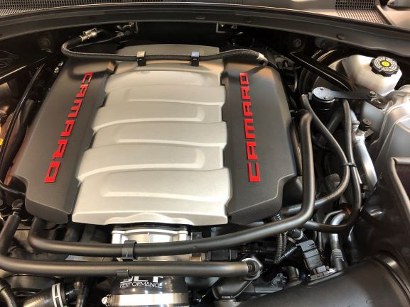

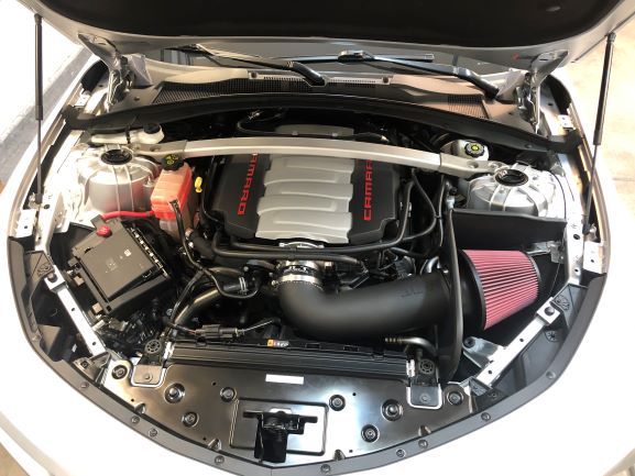

Yesterday evening I installed the JLT 3.0 Oil Separator. A little more work due to the strut tower brace, but, it fits just fine. The separator is hardly noticable once the strut tower brace is back in place.

I like my JLT unit. I am able to unscrew the bottom dump it out and get back to driving. Just make sure you don't over tighten the canister. First time I took it off it was a bitch to get off.
For sure.
I had an early design JLT oil separator set-up on my GT500 years ago (two separators). I kept the cannister threads lubed with a little anti-seeze and would put a little oil on the o-ring too.
I've done the same with the separator on the Camaro.

Easy peazy, one of my first mods, and strut brace fits no problem

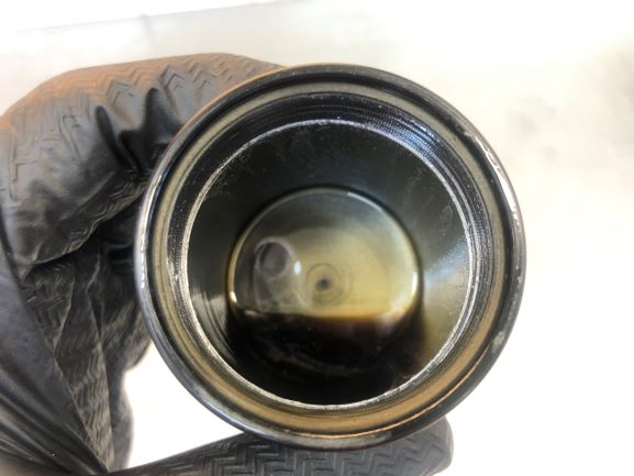

Originally Posted by blk 2013 View Post
do you get much oil in it
I haven't checked but I have only driven maybe 150 miles.
With an NA engine, I don't expect much especially since I drive kind of easy.

Oil collected after about 375 miles, maybe a teaspoonful.
