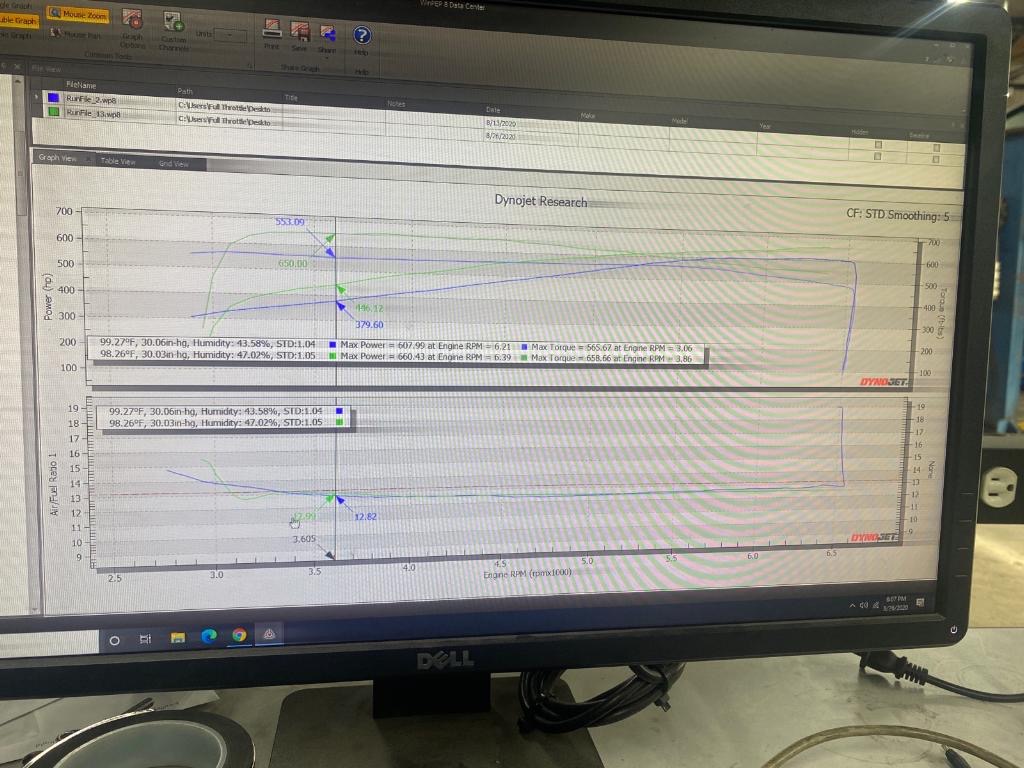

Update
Just got the car back about an hour ago, drove it home. Feels faster. A lot louder then I expected. Will take some getting used to.
Flex fuel sensor seems to be good. Got the app installed. Says its running e50 at the moment. Tuner had it at 50% as well. So its matching up. Did not get a print out of dyno but I have a pic. Attaching. blue should be baseline.

Excellent... and yes the noise level has just gotten exponentially louder.
