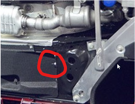

Can anyone tell me information about this oem nut I have circled in the picture. Part number, bolt it is attached to, nut size, thread?
I am missing one and would like to replace it.

There is not normally a nut on that threaded post, the post is there to hold the panel up during assy. The front of the panel is secured by two bolts on either side of the post. (at least that's how mine is)
But, if you want a nut there you can use one like item # 11, just for reference I included the bolt number too (item # 9)
11507067 NUT
11519375 BOLT

Thanks for the reply.
Huh. I watched a video tonight, and there were no nuts on those posts. I will need to check under my car again. I may be wrong, but believe mine has a nut on one side, that post, and under-body shield. Not the other. I can not remember which, passenger or driver.
