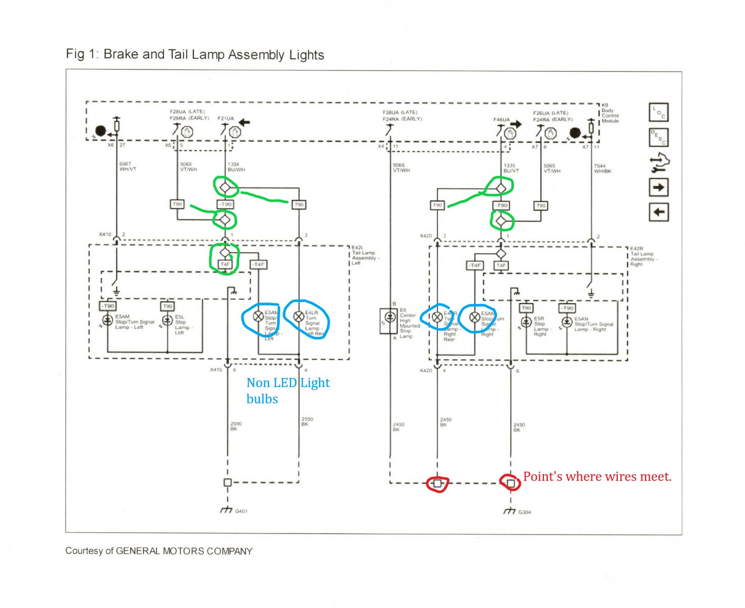

Originally Posted by ctrlz View Post
Here are the pertinent schematics from the repair manual. If anyone can shed some light on the meaning of the symbols such as square, diamond, and circle with X, I would appreciate it!
hope this helps, the green is the diamond, thats so you know how your car is wired, look at the options thats how your car is wired.

Originally Posted by 2SSRS@Gen5diy View Post
OP is your car a USA car or a euro car? if its a euro car need to know if its a LED tail lights or not? from there we can try to help, and on that socket with 3 wires but only needing 2 wire GM does that and runs the 3rd wire to the next socket, they do that to save weight, its called daisy chaining the wires.
Car is US model with led tail lights. As the brake/turn signal share common wire, I had to bring some wire from the 3rd brake light to the other two, also for turn signal lights alone I will have to bring wires all the way from the front turn signals. It's a PITA more than I imagined.......
Could it be that you also have the schematic for the front headlamps?
You did not need to do all that work, we have a unit that will split your turn/ stop light in to 2 wires one for stop and one for the turn, its all done in the back.
