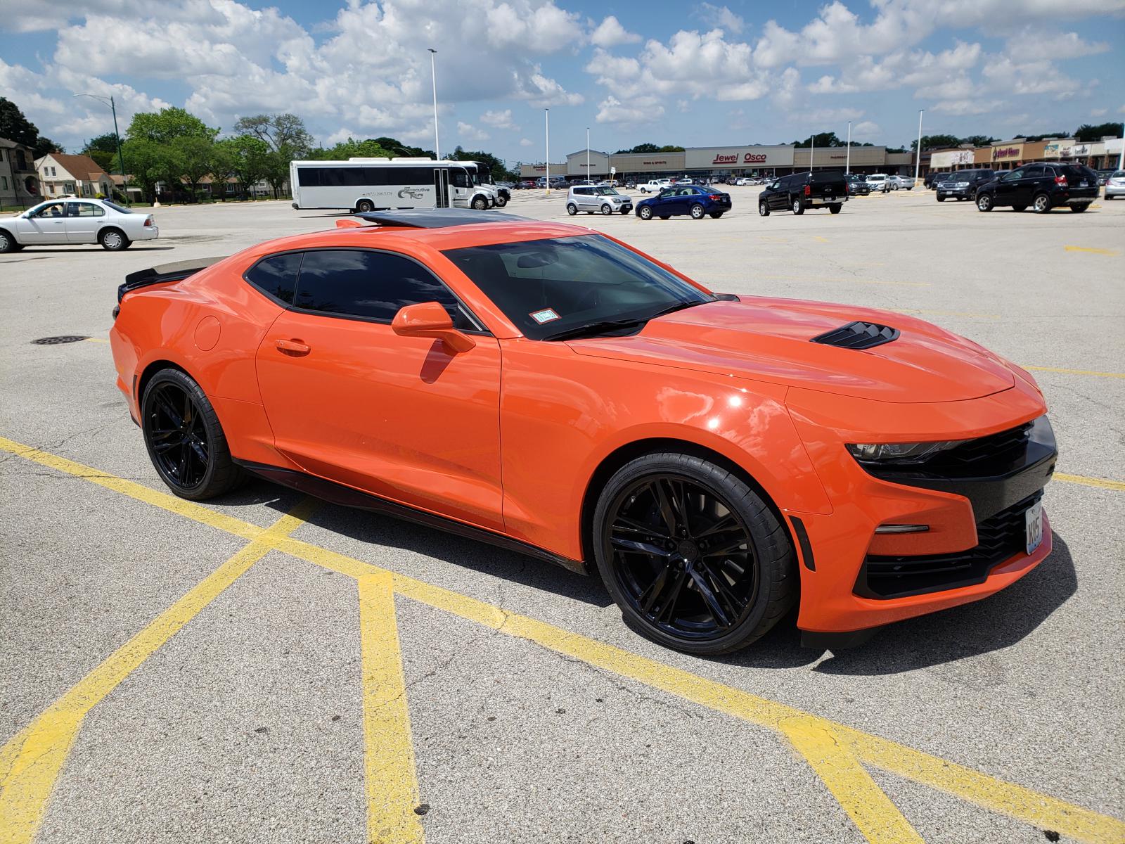

Here's a pic with the new rims and tires.

Sorry, here it is....
