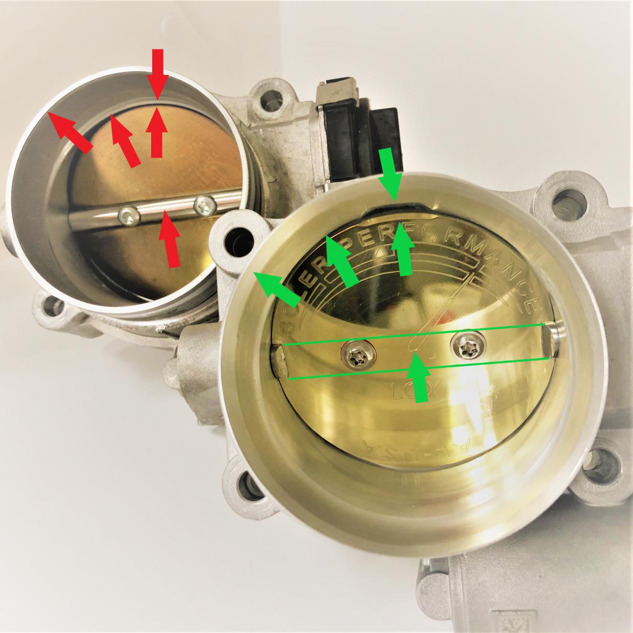

It comes from the stock 3.6L V6 TB (72mm) and we modify it to 76mm at WOT, this is the maximum you can run w/o tuning. We also added features to increase flow at partial throttle, which is what most folks enjoy the most.
For those willing to tune, we are working on the 80mm right now plus the Adapter kit you'll need. We'll take it up to 84mm at WOT plus all the other features of our TB's at partial throttle.
Not sure which company that is, but we have seen a straight bore adapter + a plain/stock 80mm being sold out there for that much.
We think our 84mm product (Adapter kit included) will be very competitive at that price point regardless.

Originally Posted by dgriff14 View Post
I appreciate the response! And it’s Overkill Motorsports. But I’m not gonna lie, you lost me with the third paragraph haha. I guess I don’t know the vernacular to differentiate your style TB vs the competition’s.
Thanks!
Easy, if you don't see these features there is still work to do, not ours.
Entry bore lip --> Thick and Square vs. Bellmouth
Home position lip --> Existing vs. Removed
Nozzle (blade/body) --> Non-existent vs. Added
Half-shaft High-Press. --> Existing vs. Removed
Surface Fisnish --> Cast vs. Machined and Polished
