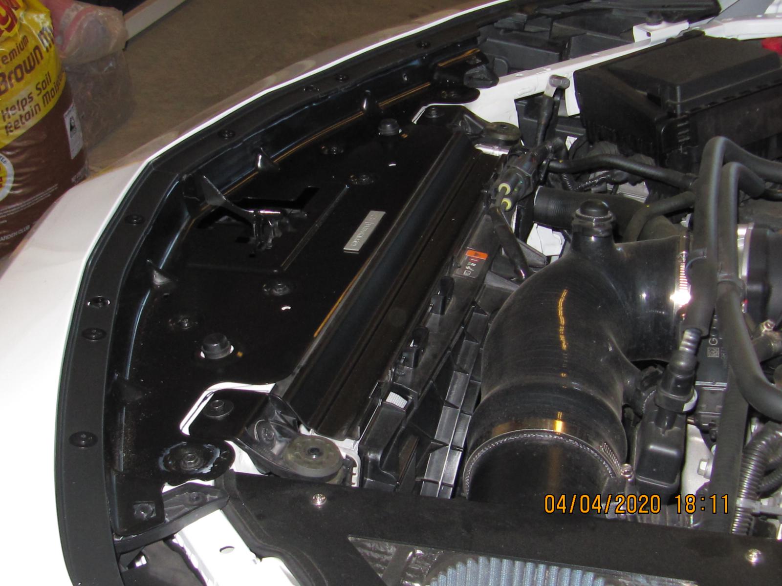

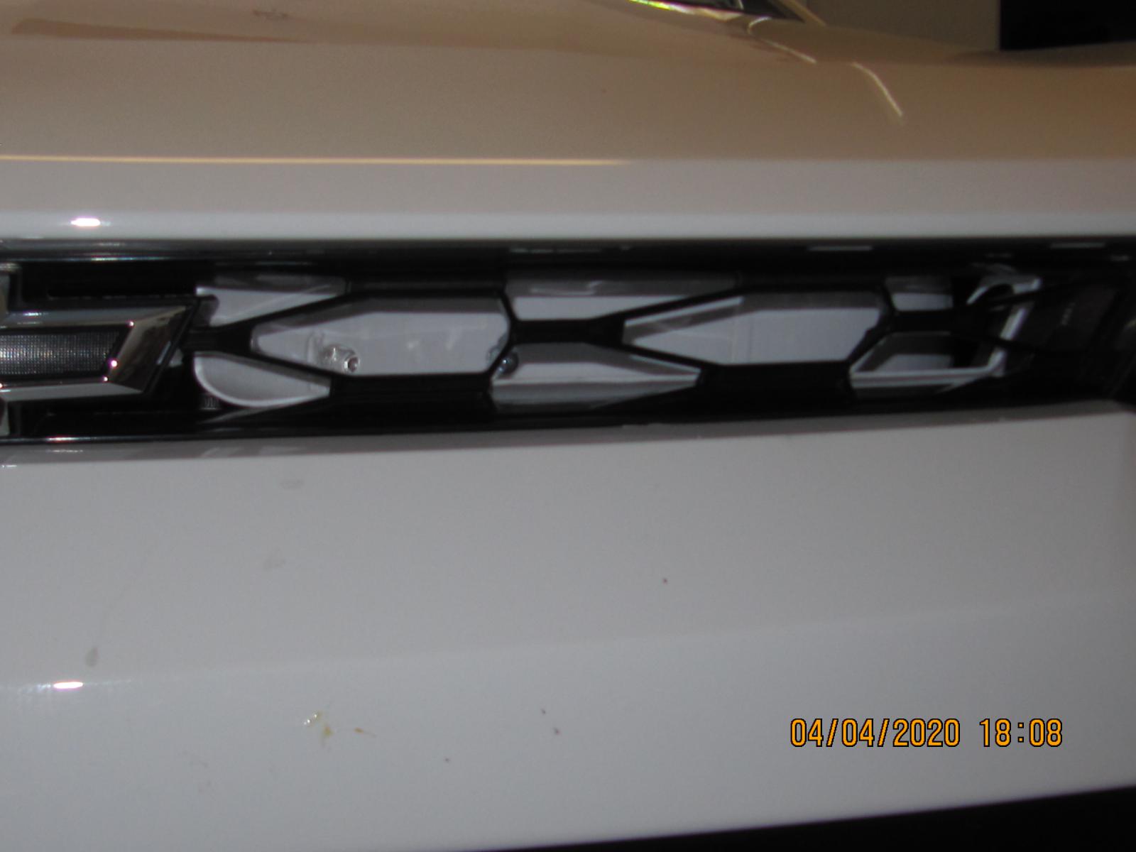

O.K.- put myself through this today and you're right you can install from the top and leave the bumper alone... but you got to be nuts! Unfortunately, I'm that kind of nuts, but fortunately was able to channel my MacGyver and got this done. Phwew! Not impossible but not fun and yep, whenI thought I was done, despite Booher's excellent idea of marking the hood latch placement, she wouldn't close.
I knew from experience the more room to work the better, but never had a really clear idea what I was trying to do. I'm also lazy, so I wanted to do this as simply as possible. I always fall for those guys that say "I did this in 15 minutes from beginning to last tool polished and put away". So do I ask for better directions? Inquire for clear input? Heck no, I'm American as apple pie AND male!
I bolted forward and just started taking stuff off...
Once I got the hood latch working well, I went for the "shake down cruise" (liquor store-thank God they're still open, who'd uv thought in UT the churches are closed and the liquor stores are open!). Car runs great! Very smooth and improved pick up a as low as 2500 RPM with great sound. This is all subjective and it didn't hurt it was a perfect 74 degree Spring sunny/breezy day!
Included the first couple pics to help orient people a little better than I was to where it goes and the last couple to show if you're patient, you can do it and not do any harm to your car! Happy motoring!

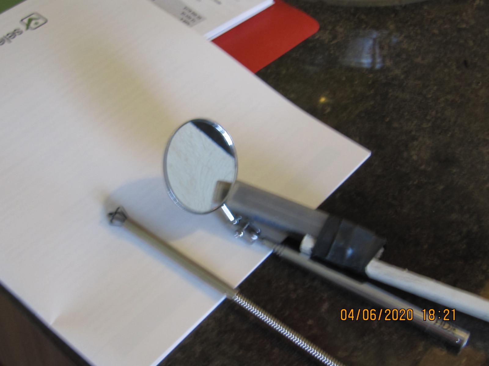

Tried to add MacGyver tool pic to this post, I honestly used all these in this install ... magnet on a string, flexible "graboid" for dropped tools, and a mirror that is probably better than my dentist uses. All from that $1.98 bin at the hardware store. I love those things!
