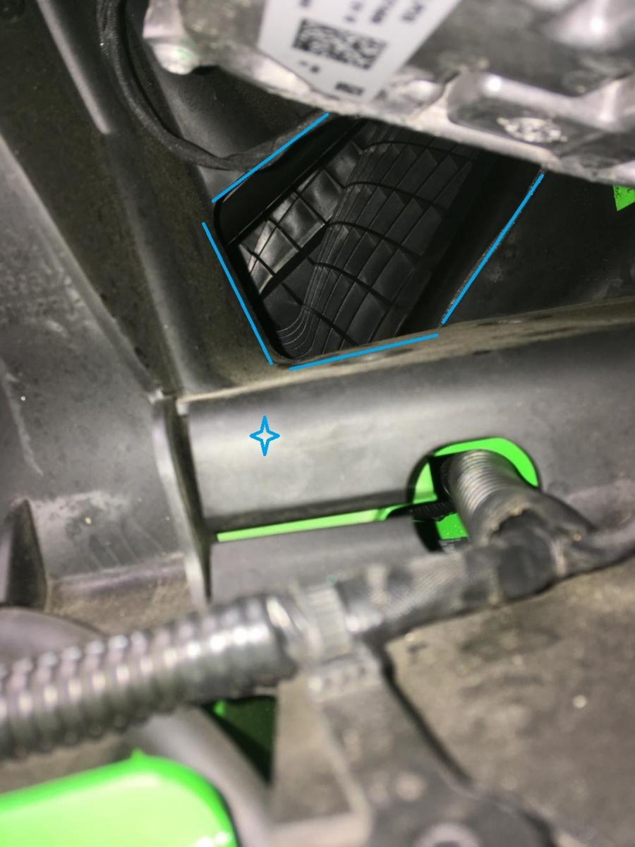

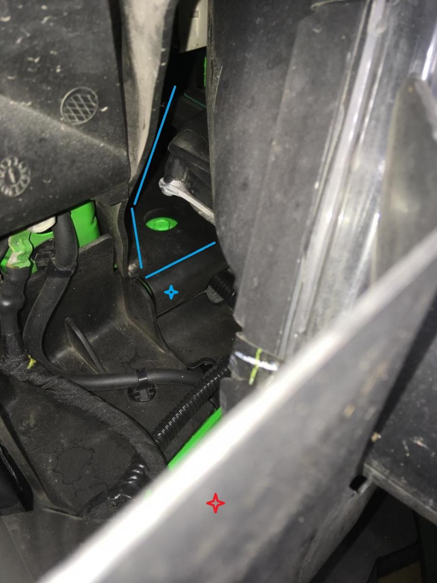

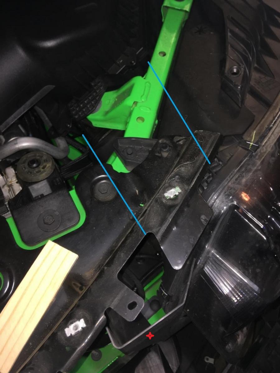

I’ve seen this get questioned a lot - about the intake tract cover just behind the grille. There are a few pictures floating around of the cover; since I had my fascia off this weekend, I figured to snap some details:

First two pictures need to be rotated 90 clockwise (phone pictures).

So cut the black plastic panel out?

You can remove the plastic push pins and remove the element or hack it up. I actually removed it and cut out a bit of an area so high pressure air from the grille area could flow right it. I elected to not remove it to keep the elements out (kept the cover functionality for weather).

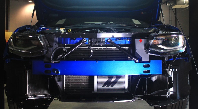

Revised the pictures with some killer paint skillz. Added reference marks (red [cover] star and blue [intake] star/lines) and also added a reference picture of a car without it's whole fascia.

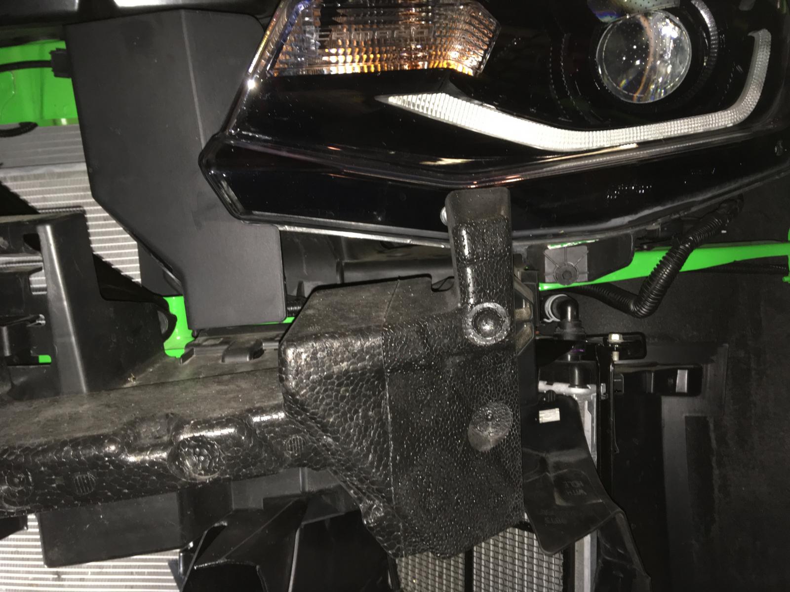

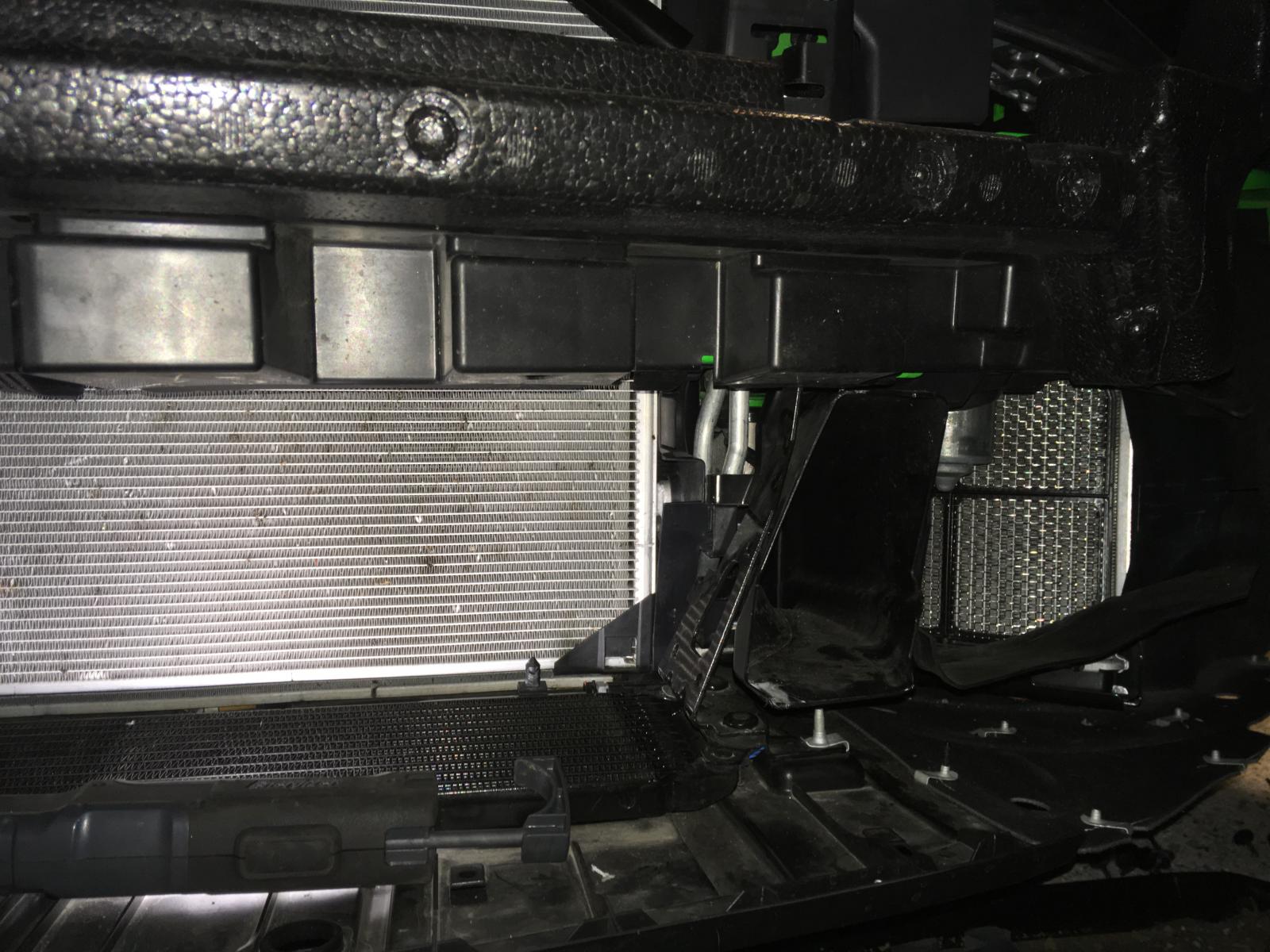

Here is with the bumper foam on the crash bar (you can start to see how crappy of a path the intake has to grab air):

Instead of removing I would drill holes in it to allow airflow but still keep debri out. Also didn't Vararam say that removing the bottom of the stock airbox was good for about 15hp alone?
