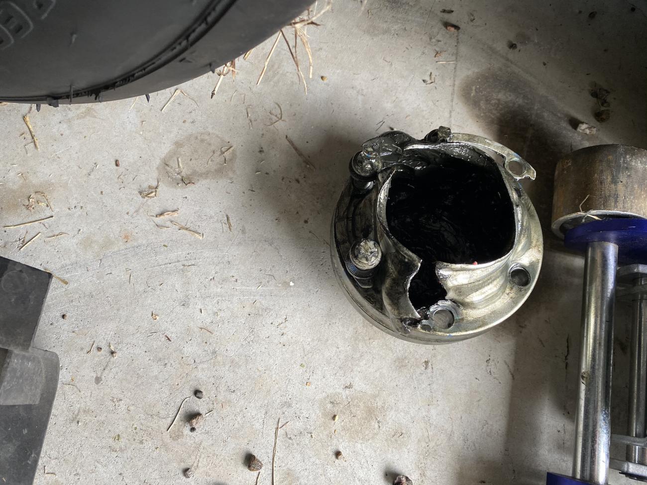

Posts: 1,527
Quick update. It was not the drive shaft.
Broke the right side axle.

So broke 4 teeth off the axle and blew out the bearings from the CV joint.
