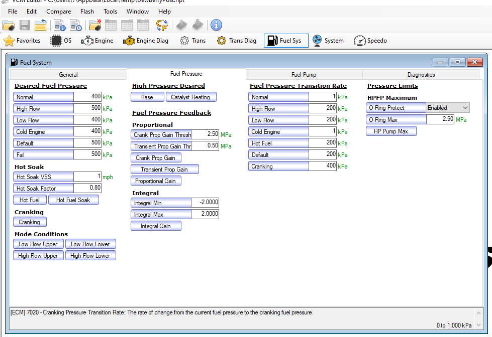

didn't even know about LPFTP tables. so its not on the os upgrade menu, or wasn't last time I checked.? WM system still looking strong since it will cool the intake and I only plan to work it so it taxies in a limited window. Given 10 degrees of cool will yield some percent of gain, some say 10F to 3hp for NA.... curious. What say you?
You will have to select the fcsu from drop down and read it Wook. Its 2 credits to modify. This is not a recent development, or related to the new flex-fuel capabilities. Attached SS. You already know I don't like meth, but if your only option is WM, sure go for it. But, as I have said before, its really a band-aid for fuel, but your using it to cool, soo its not exactly the same. I would not use meth and E85 at the same time. Steve from ZZP did tease a multiport set-up to me some time ago, and it looked quite marvelous. To me, multiport would be the ultimate answer.
