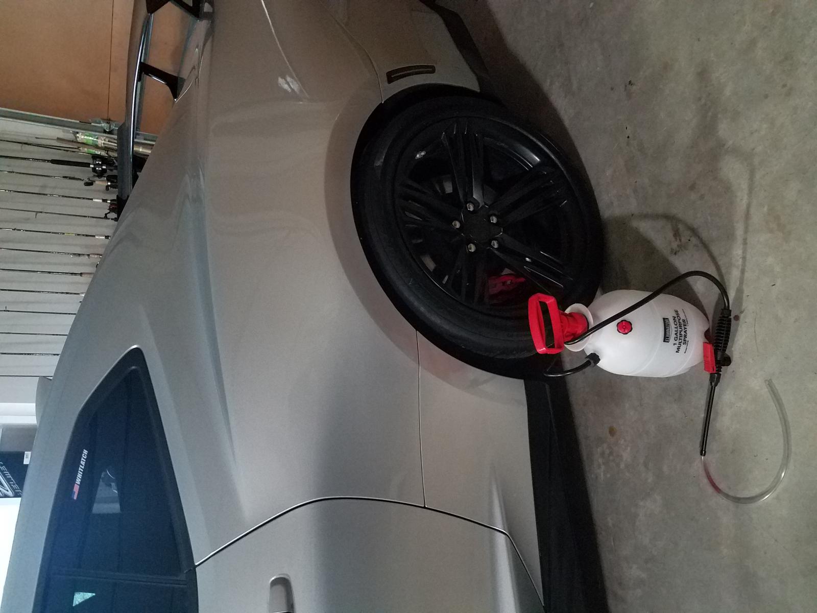

If you change diff and trans fluid often ... Load once and crawl under the car once. Also use similar setup (Motiv) for the brake fluid flush and bleed.

Old 04-01-2020, 10:55 AM   #28
NorthGeorgia
Drives: 2018 ZLE, 2023 C8, IMSA MX-5
Join Date: Jul 2019
Location: Lake Lanier GA
Posts: 79
I use the Motive brake bleeder - it has a pressure gauge and fitting (cap) that connects to the master cylinder. Add a liter of brake fluid, connect SECURELY to master, pump to 20 psi, then bleed each caliper (upper and lower). Usually have to re-pressurize the bottle a couple of times if flushing versus bleeding. One person 15 minute job. No more stressed wife pumping the brakes and premature pedal release.
