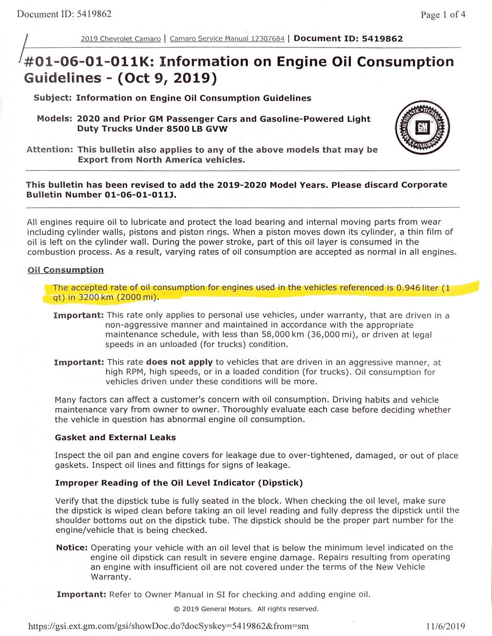

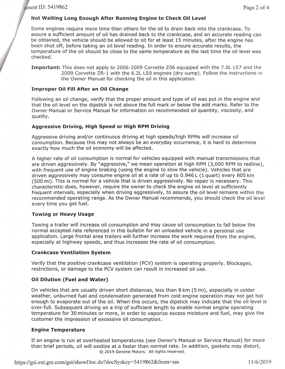

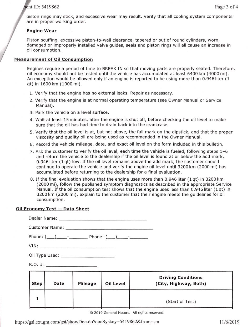

Finished my ‘oil consumption test’ today.
Was informed everything is normal.
Documentation below:
2019 Camaro SS 1LE
