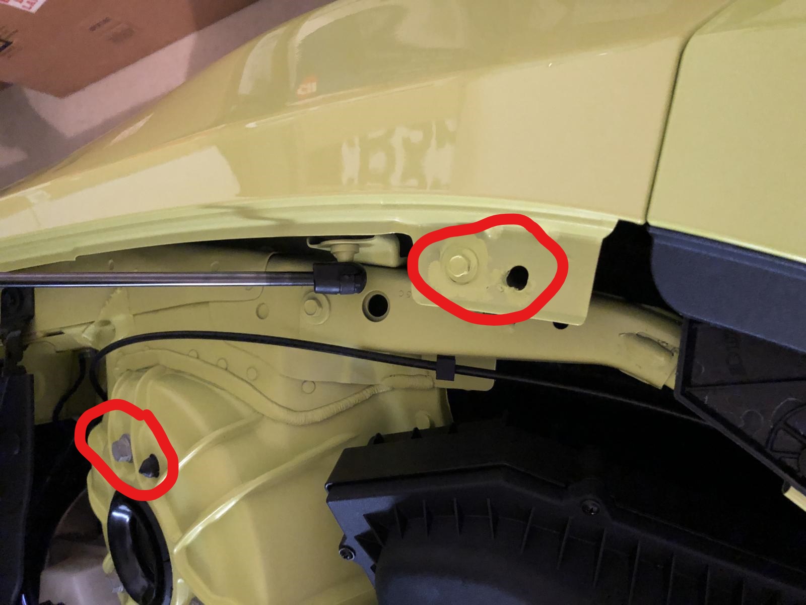

Oh yeah, you've had body work done. That's an obviously bad touch up job on the fender bolt, I can't tell from the angle you shot, but if there are more bolts with broken paint or marred, it suggests the same thing. Notice the strut bolt in one of the red circles? They usually don't have impact socket marks like this one from the factory. Compare it to the other tower bolt, doesn't look the same. I'd say that LF fender was damaged.
If the car had to have some sort of adjustment or repair at the factory(which does happen), then this would be normal. It could also be the result of the car being damaged after it arrived to the dealership.
