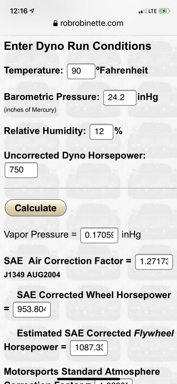

I saw someone mention 5000’ If this was at 5000’ It likely made 750 actual hp and only needed enough fuel for 750hp. Correction factors get way off for boosted cars up high.

Word. Max hp speculation based on on fuel supply should be uncorrected....

parish8 and yourself are on the right track as far as I'm concerned. That car did not actually make 950 rwhp, that's just a dyno number inflated to some degree from the altitude (correction factor). I found a picture of the dyno plots in this test and it says 'STD' which further inflates the numbers. The correction factors were hidden and also the atmospheric conditions were hidden on the plot that I found. Seems that dyno shop is in Las Vegas NV, so it's probably over 2000' actual altitude. Obviously DA at the time of the run would be nice to know.
